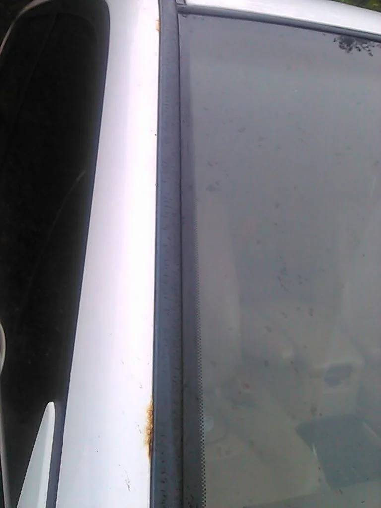

Any of you guys that have used screws on the windshield trim are you experiencing rust yet?
The PO replaced my windshield with pilington glass and used screws so I do not know how long its been in there. This is what I have now.

From my understanding talking to a private one man windshield shop in buisiness for 30 years who fixes windshields at 2 local toyota dealers so they can then sell the cars, said these LC are a "pain in the a$$" along with the FJ cruiser but the LC is worse.
He told me that since screws where used it would be OK as long as the metal was properly treated and then a sealant of sorts was applied to the screw.
The factory uses a plastic rivet which is good but from what I could gather from him talking it still could possibly get moisture underneath on a factory windshield.

Buy a box of the correct rivets and replace the screws. My trim were put in using screws from sometime before I bought my cruiser. Pulled screws, smeared some 3M body sealer on the proper plastic-coated rivet, installed rivets, done.

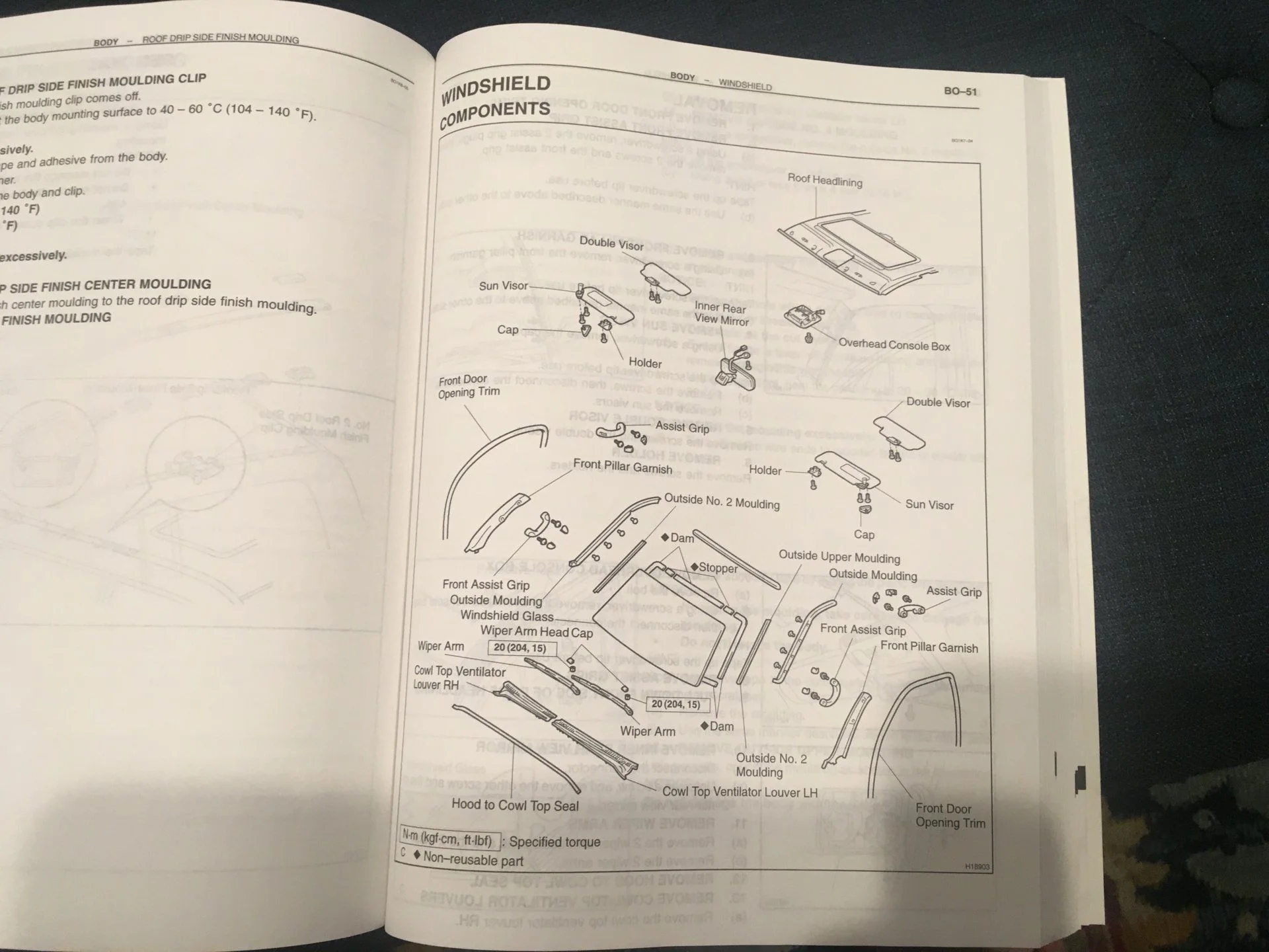

Hey everyone, after looking at the FSM for my 05 LC trying to figure out which parts would make the most sense to order to make sure the windshield installer does it right. I’m a little OCD and my current windshield has some bulges along the side, not to mention the chips in the windshield.
I’m thinking the Outside No.2 Moulding on both sides, possibly the outside upper mouldingd and the rivers of course.
Any thoughts?

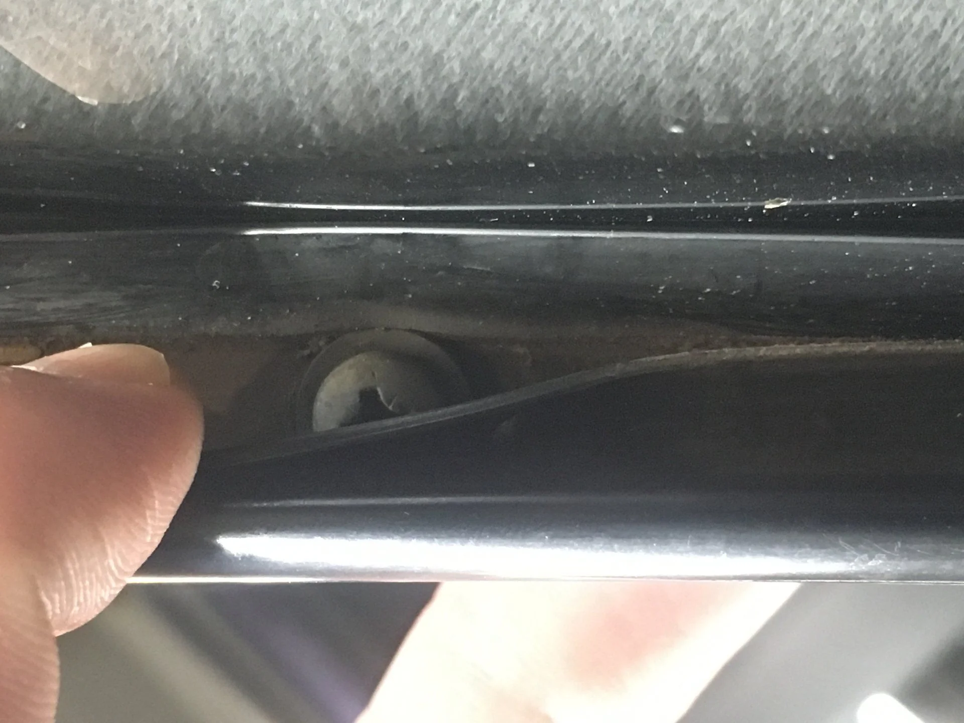

After looking at my current windshield, previous installer used screws which I’m sure are contributing to the wind noise.
Any thoughts?
It is supposed to be rivet instead of screws. It will cause wind noise and potential leak.
The problem with the screws is that they are 1/4 inch (usually) sheet metal screws, rather than the 1/8" rivets, so you kind of lose the ability to use the rivets properly once some dip**** uses screws on it. Ask me how I know.:doh:
