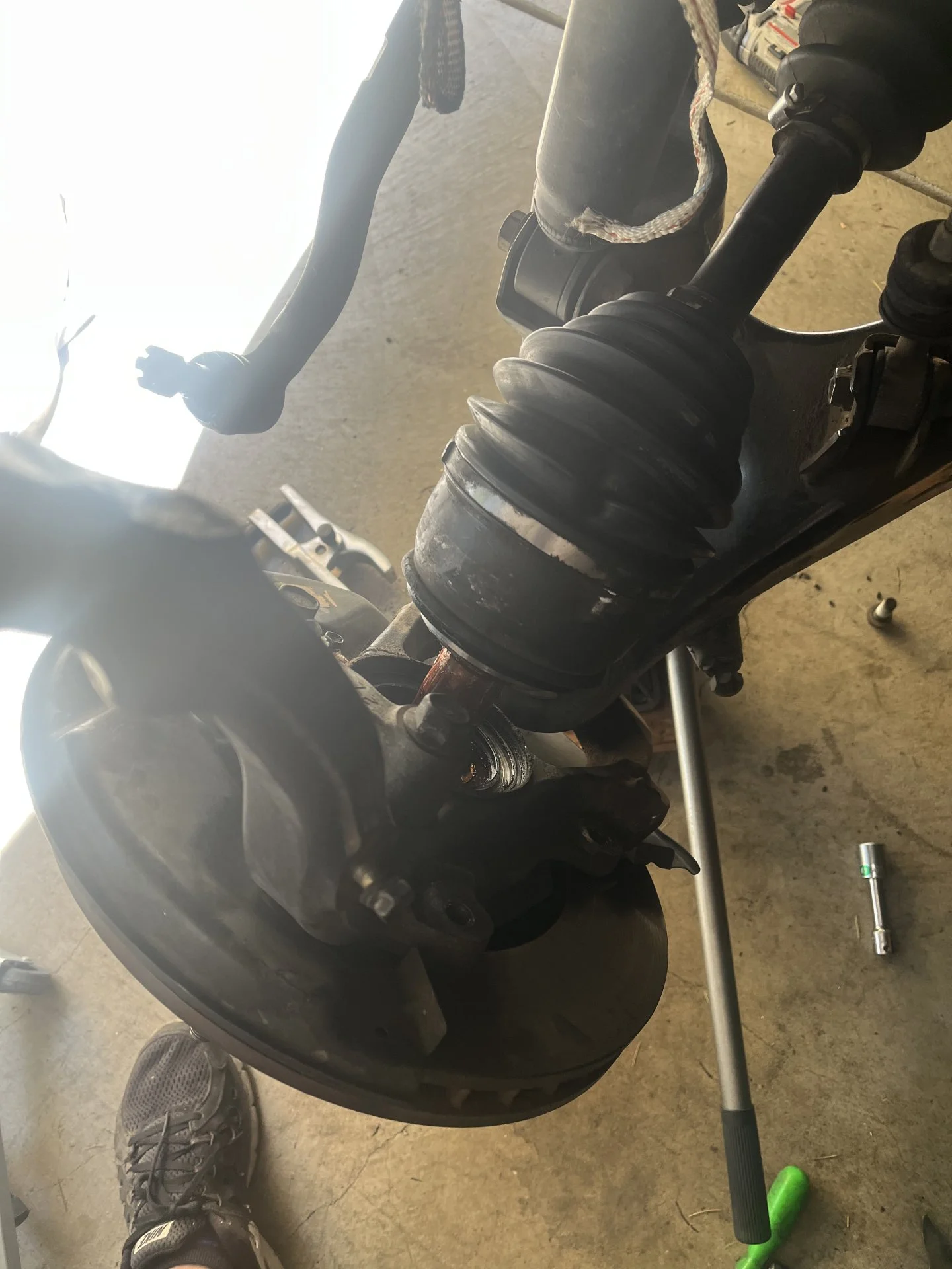

Why Is this not coming out ?
Should I remove inner one first?
Removing the knuckle entirely makes it easier, and less chance of doing any damage to the knuckle seal, brass bushing, and needle bearings. Yes it can be done with out removing knuckle but in my experience it’s not an optimal procedure.

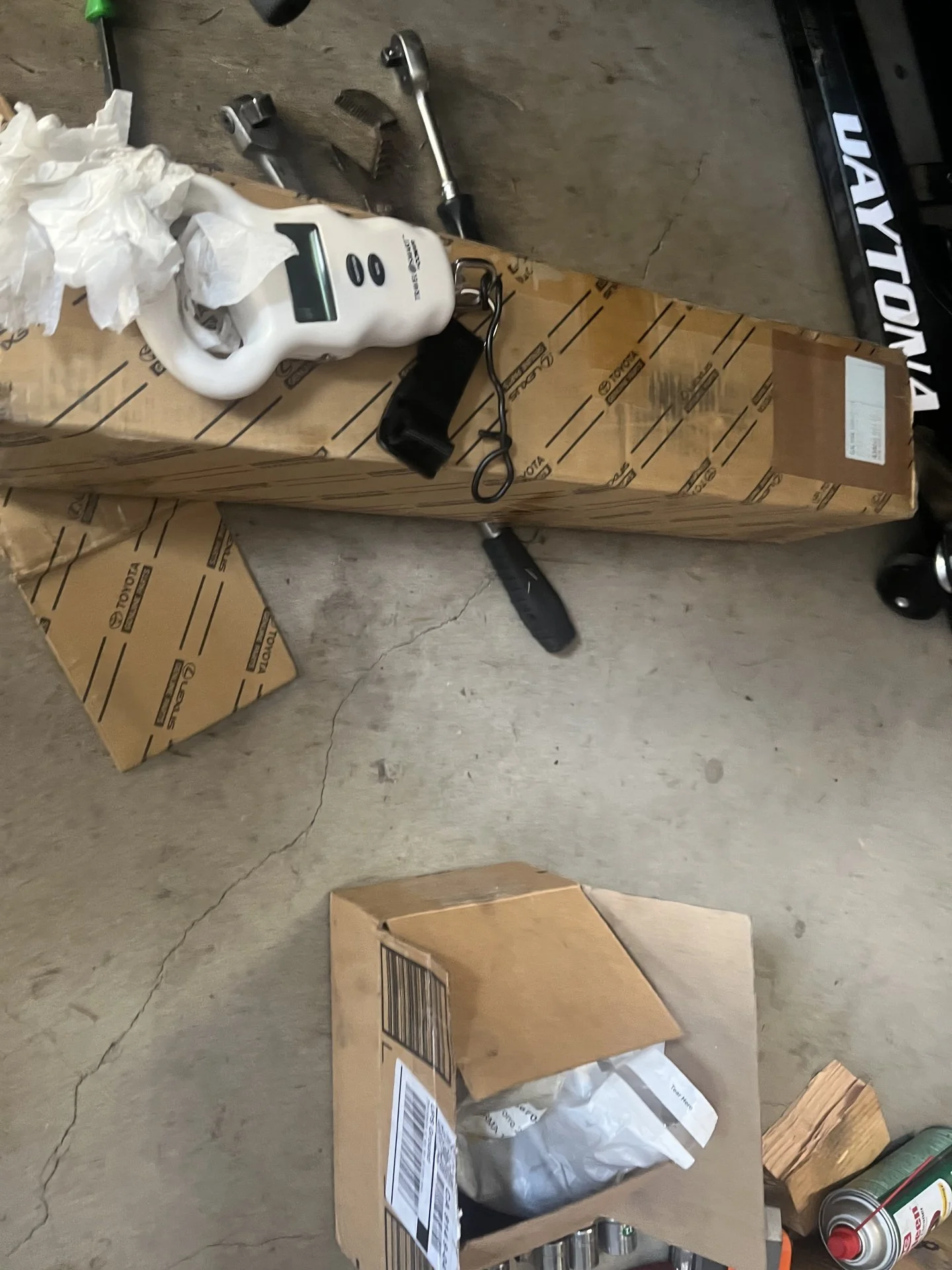

Am I doing this correctly. I think I should open up and tighten up bearings bit more since I have completed installation about a week ago
Pull the inner from the diff and then pull the entire CV axle out right below the diff.
For the axle bearings, watch: Same setup in the LC. I followed their torque specs when setting the bearings. Did not use the scale.
Should I install same way - outer first then inner or should I take out lower ball joint and remove knuckle?
Inner first.

When installing, if I remember correct, the outer goes first and then the inner. I did not remove the lower ball joint. Install OEM diff seals.

I read in number of threads number of people tighten a lot more than 4ft lbs. I just tighten mine to 45ft lbs. Theory behind that is loose setup will wear out bearings sooner. Basically after rotating by hand, it goes around about 1.5 turns for me. Will see how it works out.

I think without removing knuckle, not possible to put inner first which I believe would be a better way (inner first) Perhaps I am not finding the right position.

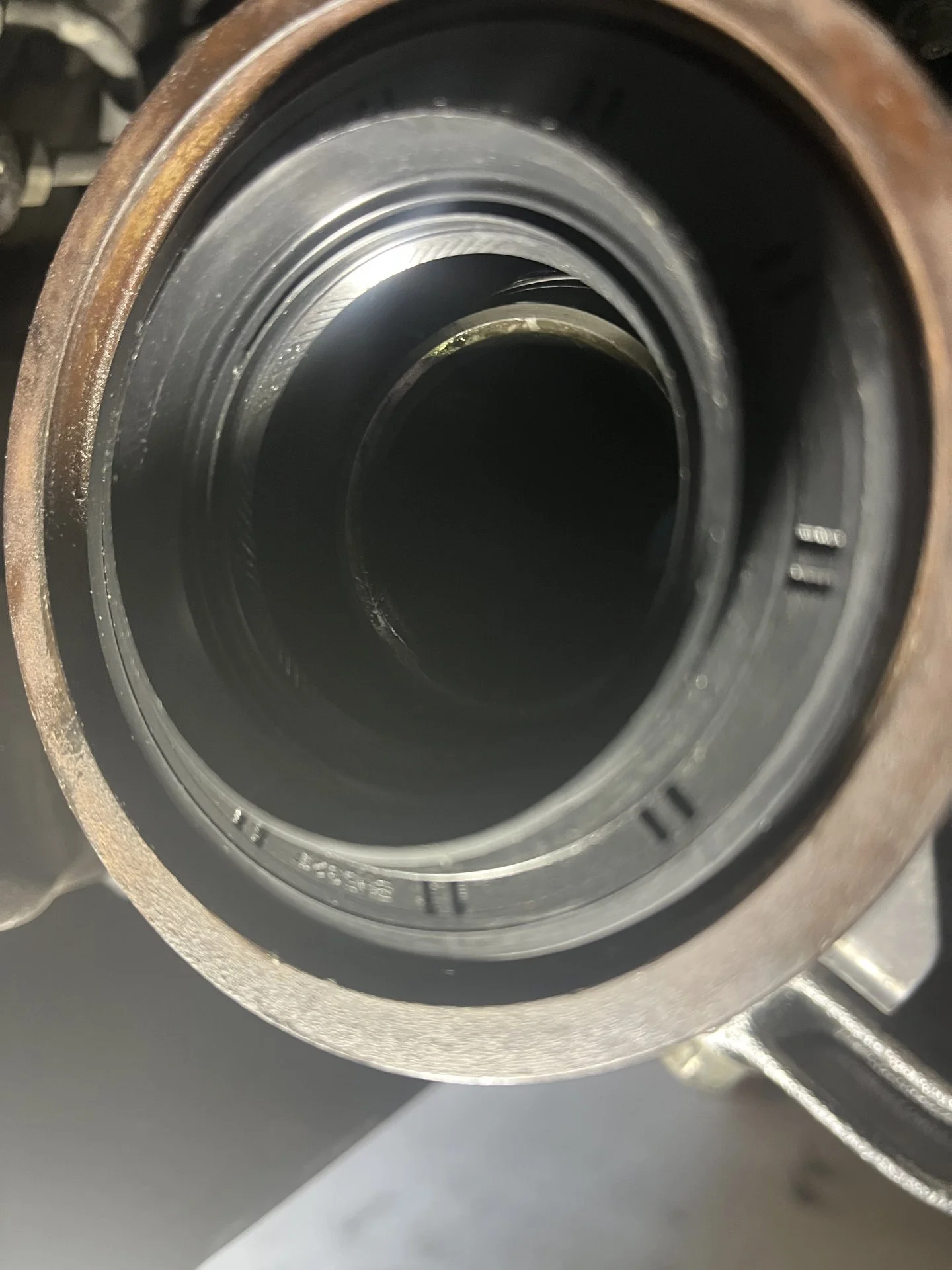

Seal is replaced. Hopefully it won’t leak.
The video is doing a correction 4lb to 45 lb or so. Yes, I used their corrected value.

Been some time since I did it. MAy be the inner goes in first and then slide in the outer to the hub. I did the CV's twice (first with Chinese junk) and on both occations, I did not remove the lower ball joint.
