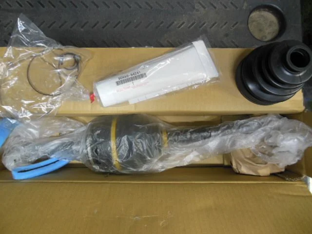

So, I bought OEM Shaft assembly 43460-69145 and it comes with everything you need to rebuild an axle with your existing OEM inner joint

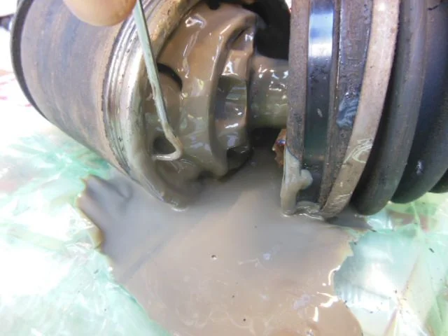

Tools used:
Pick tool, flat screwdriver, puller, lock ring pliers, hammer to lock the boot clips and paper towels

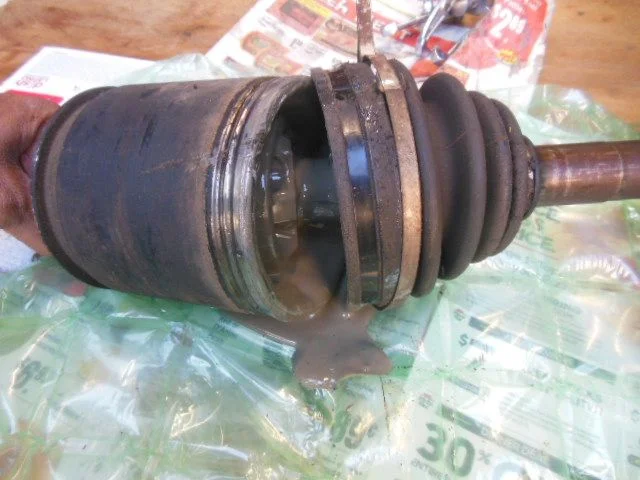

3rd picture shows the removal of the clip in the old (OEM) CV inboard joint

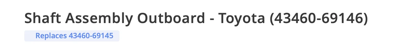

As part of my brake refresh project, I’m rebuilding the CVs on my 208k 02 LC. New flanges are on order as well. The first post here referenced j43460-69145 for the outboard shaft kit. 43460-69146 also comes up for the outboard shaft but it’s a little higher in price at my local dealer.
Anyone know if they are the same or different? Complete OEM CVs aren’t available without backorder at the moment.
Looking the part up on McGeorge right now (planning on doing the rebuild as well) and it says that 43460-69146 replaces 43460-69145.

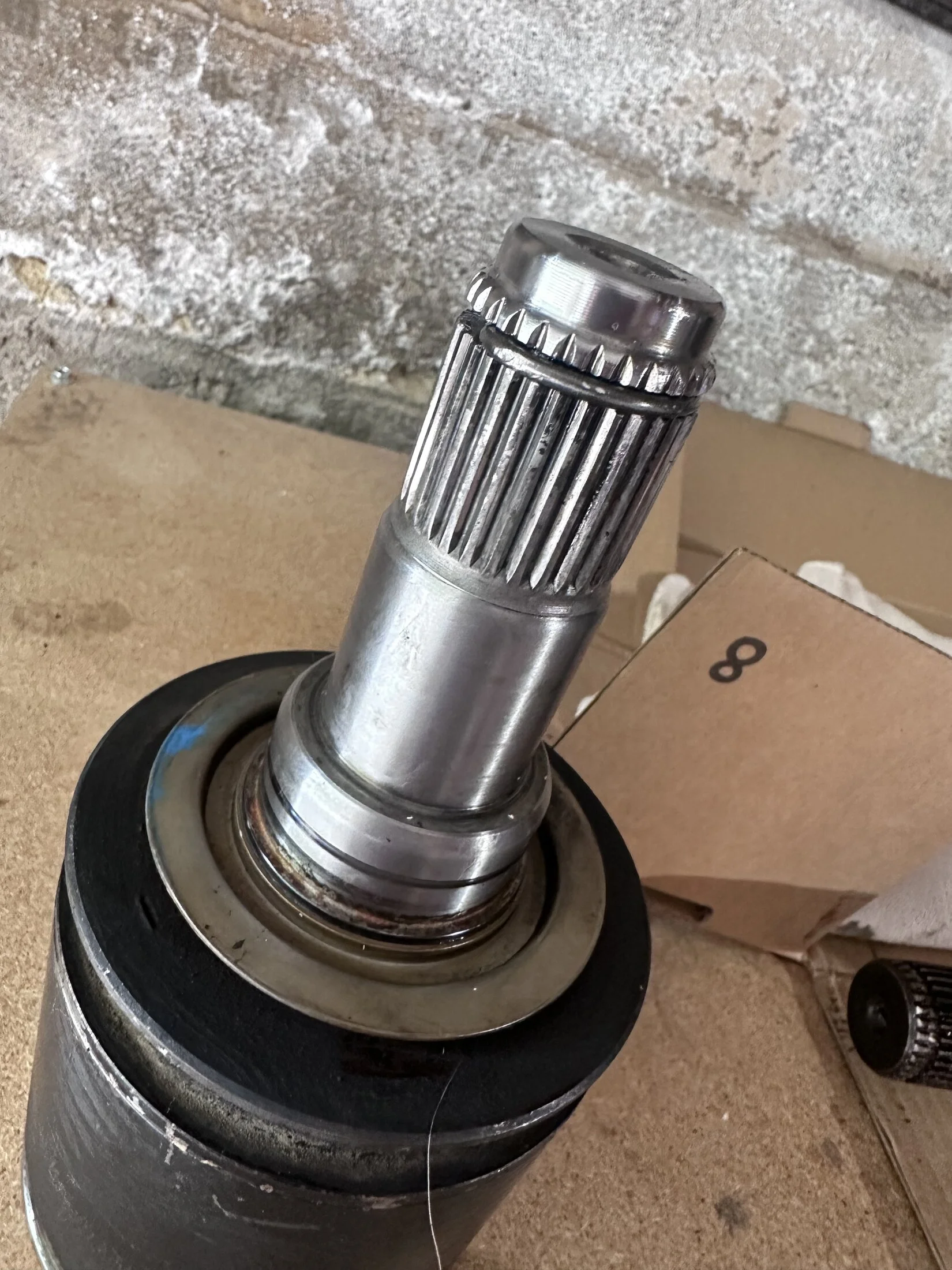

Doing my front end with this kit. Driver side went as expected. When I got into the passenger side, I found this...
It does not fit the splines in the driveshaft kit, so I'm having to Frankenstein it
Looks like a 4 Runner CV- That 3 ball type of CV is pretty weak, won't last long in a 100 series.

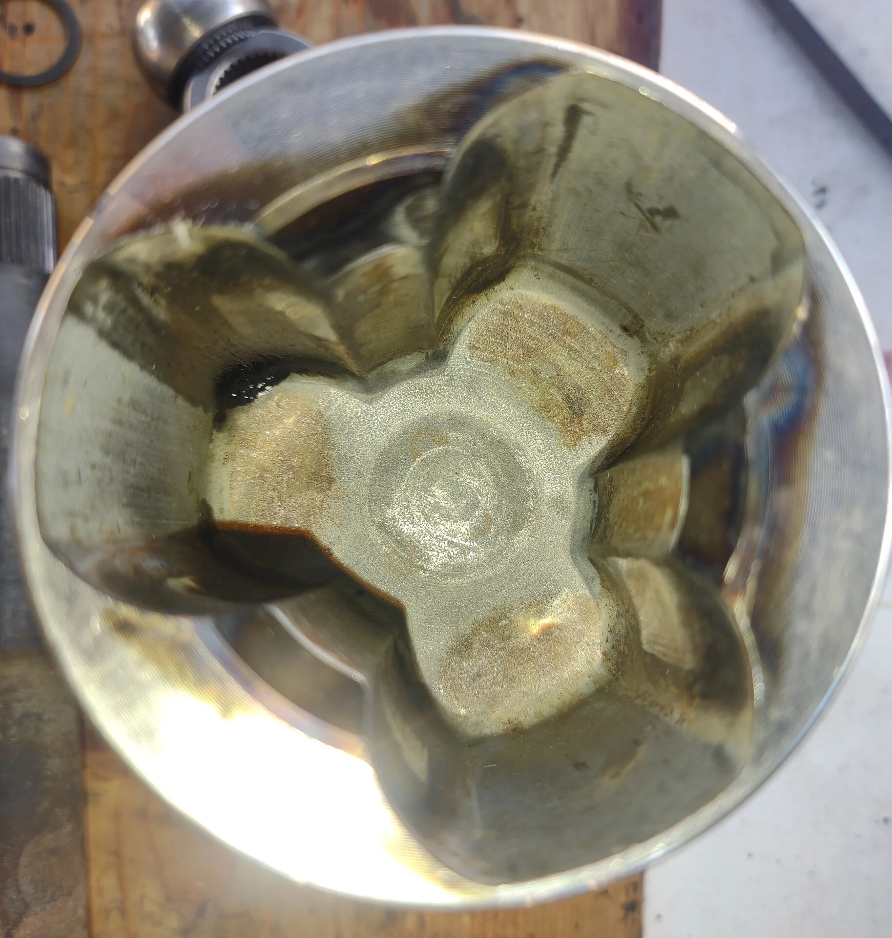

Currently rebuilding my CV axle and just removed the boots and ball bearings. I remember reading about it being very critical to “mark” something on the axle to make sure it’s lined back up the same way?
However I can’t find anything on the forum about this and most of the videos they didn’t do it. Can someone fill me in on what I need to mark and what needs to be aligned the same when I reassemble?

Please go to page-1, 2nd post, 4th or 5th pic.
Mark the ball housing to the shaft.

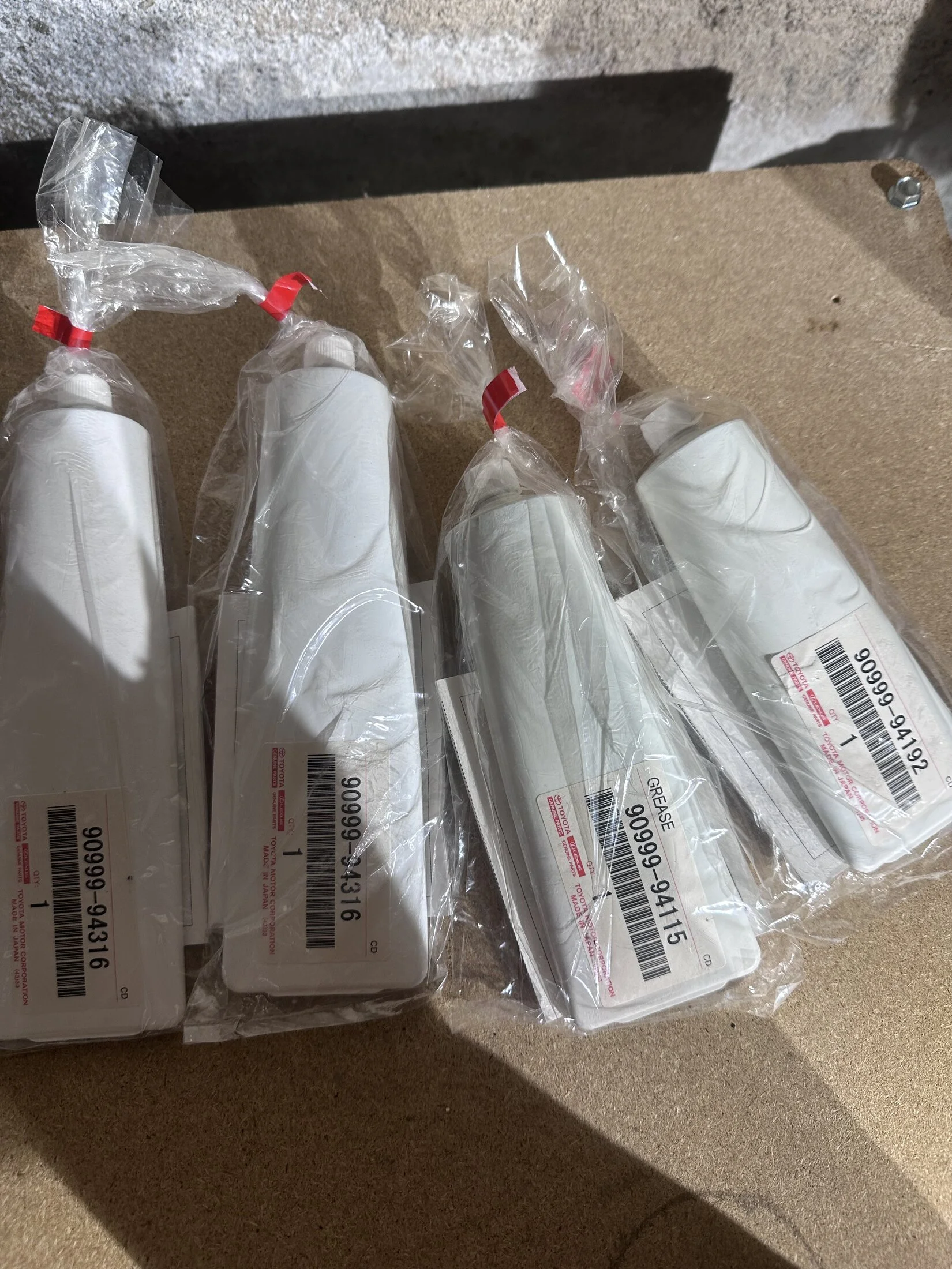

Finally picking the project back up after a busy few weeks. It seems I have 3 types of grease here, I am replacing both inner and outer boots on my cv (seems like no one does that) does anyone know what goes on which end? Also I have 2 boots 1 more of a hard plastic and one more of a rubbery plastic, can someone tell me which is designated for inner and outer?
They’re different sizes. The outer tulip is larger in diameter than the inner tulip.
