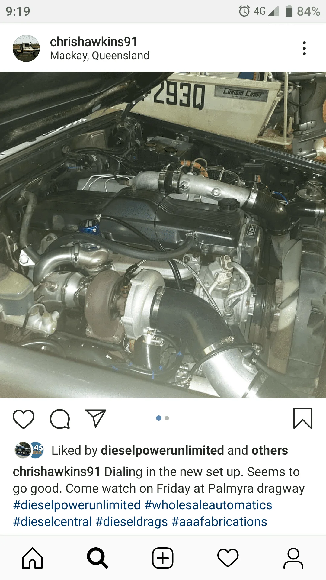

These are the exact diff gears used in one of Australia's most powerful and fastest FTE powered 4x4 so I'm pretty sure that'll do fine. Think he's the fastest non common rail diesel and the 5th fastest overall diesel running 11sec down the quarter mile. I was also deciding between these and the 3.7 ratio but opted for the 3.7 and I'm really happy with them.

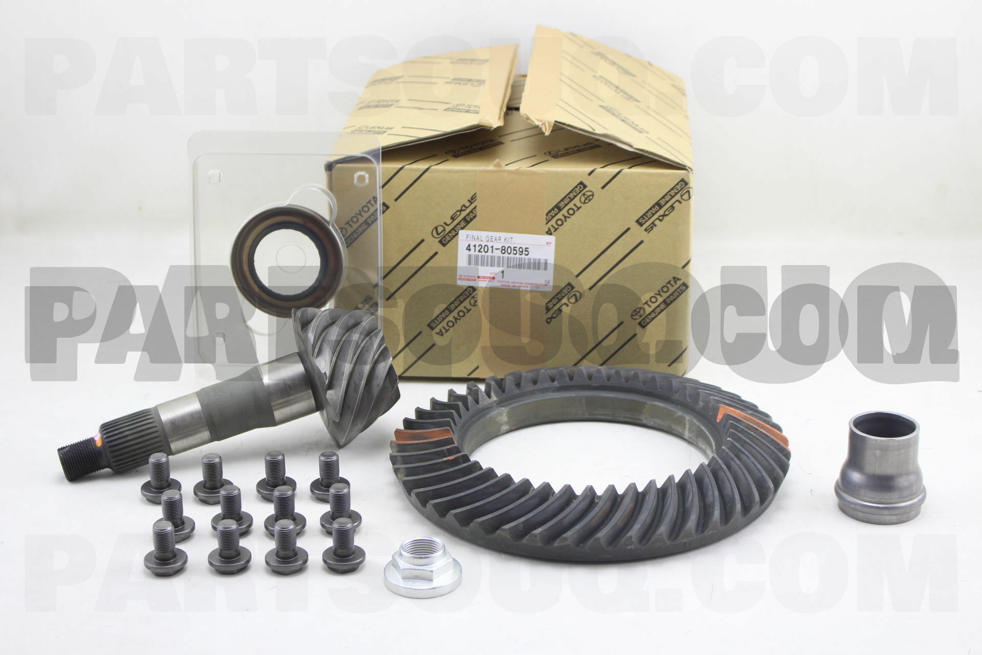

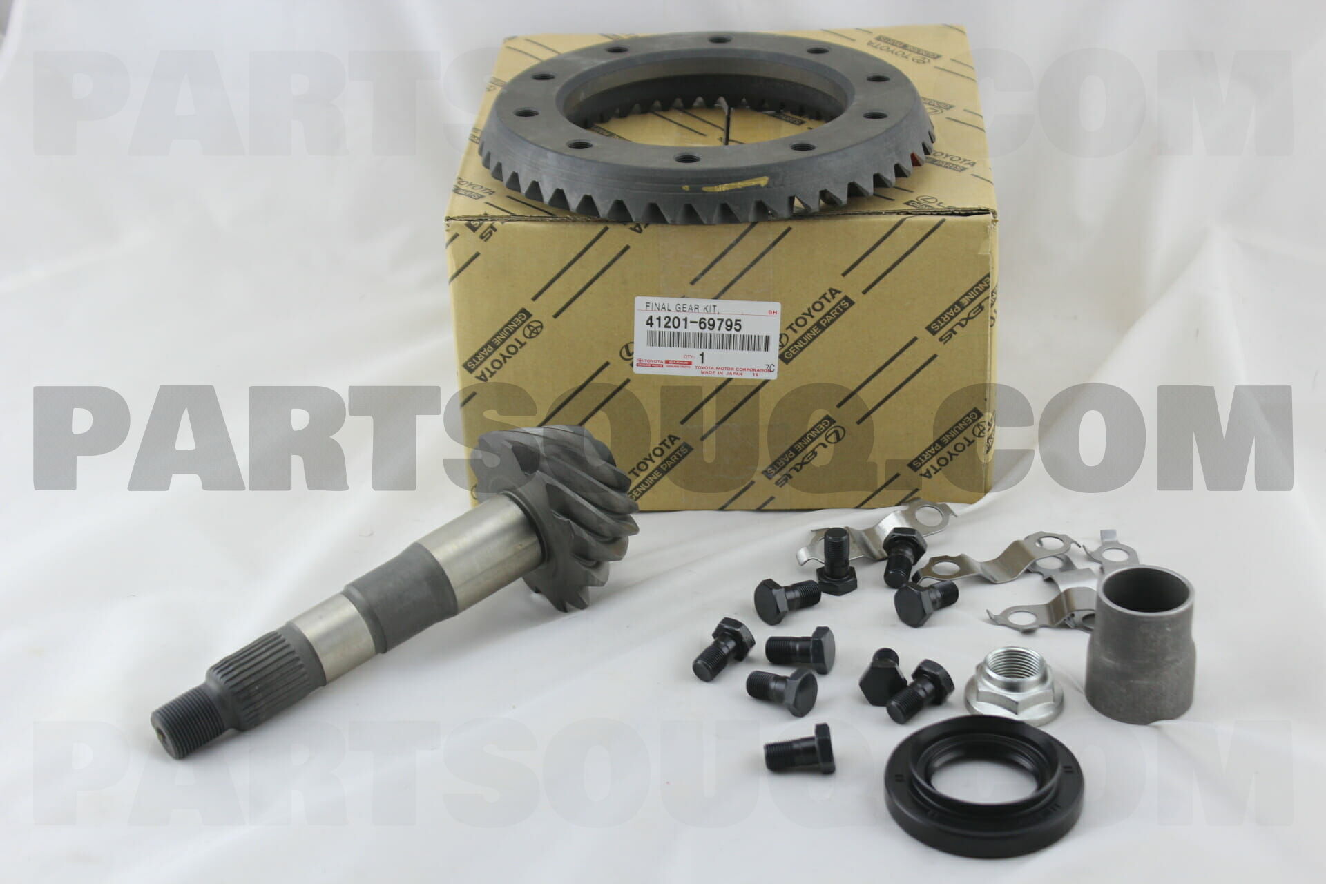

Would anyone care to share a VIN for a 105 that has the 3.9 gears so I can be sure I order the correct rear 9.5" and front reverse rotation 8"? I have been looking on Amayama and Partsouq but they do not list ratios and it is a little suspect to order without knowing what I am going to get. lol.
I would really like to use the 100 series type of gears in the numerically lowest range Toyota offered.
To my knowledge, all auto FZJ105 had 3.9 diffs. Vin incoming by PM
Edit: ignore me, no idea what I'm talking about
Auto FZJ105 are 4.3. Auto HDJ100 are 3.9, aswell as all vdj76/78/79 from 07 to current.
Thanks when I looked for VDJ79 it says the front 3.9 is no longer available. :-/
