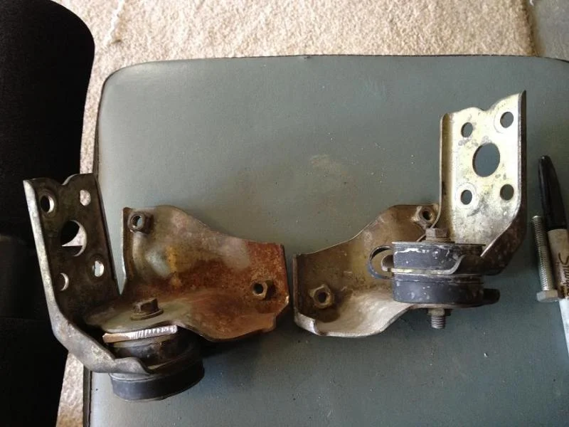

Nothing out of the ordinary really, just a bunch of nuts and bolts. Kind of a pain in the ass doing it by yourself but I needed some extra room for the 37's. I do hate the bumper gap so I guess I need to get off my butt and make some plate bumpers. For the radiator brackets I basically just put the body side bracket on top of the radiator side plate and added a spacer until they were correct. The radiator plate sat 1/2 inch above the other so I needed it to be 1'' lower in order to get the right height for the 1.5'' lift.
