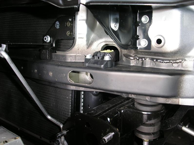

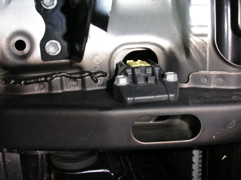

It COULD affect insurance, since the 'crumple zone' sheetmetal has been replaced....Theoretically, I would THINK that with a SOLID bumper, the force would be more directly applied to the frame (since the sheetmetal bumper is gone)...hence your insurance may claim that the bumper caused the airbag to pre-maturely deploy.
The stock bumper mounts to the "horns" on the front of the frame.
The airbag sensors are mounted on the body of the vechicle; above and behind where the bentup (or stock for that matter) bumper is physically attached to the FJ.
Here are some pics of the sensor, and the 2nd pic you can see the frame "horns"....1st pic is passenger side, 2nd pic is drivers side.
Are they impact sensors, or mass shift sensors?
Maybe there not as unique as I thought. From what I have studied most sensors are in the dash or stearing column, although I didn't really look into anything but U.S. car manufactures...
But ya, basically I think thats what I was getting at when I said it could make the system more sensetive as far as premature deployment goes.
I can't see why it would raise your insurance rates or anything though.. I've had a winch bumper on my rig for years now and my insurance has never asked or cared. I guess after an accident they could get after you about it, but theres virtualy no way they can clame your bumper caused a premature deployment and back it up, unless they somehow know for certain the speeds involved and the physics of the crash... to me I just can't see an insurance company caring that much that you air bags wen't off in a crash, but thats only taken from my personal experiance, other people might have had different experiances with there insurance companies.
