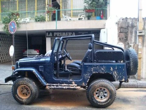

i have installed gas shock absorbers on my 83 fj40. would a switch to oil shock absorbers provide me with better / less bumpy ride?
i have 33.5 x 12.5 inch tires and a 4" sua lift.

here's a description of what i got, i did the lift myself, and it's my firs ttime.
i cleaned the original leaf springs i had, and bent them to gain a few extra cm of height, as a result of that, my shackle angle is towards the inside.
for the moment the only thing i can afford is to make the switch between shock absorbers, i just need to know if it can improve the ride at all.
