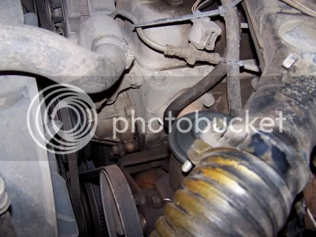

Ever since I had the power steering fitted I have had issues with it. Always a thorn in my side from leaking pump to fitting extactors, we won't go there thou:mad:
So 1st up, I have noticed that most posts state that the 2F block had the holes in the block from around 1979 as shown here in a photo I borrowed form PabloCruis's thread https://forum.ih8mud.com/showthread.php?p=1008741#post1008741
Now I have had a look at my block and been a late 80 model yes it has them, but here is the thing, as far as I can see all right hand drive 40's and 60's have their power steering pump on the drivers side and use the bolt holes off the head as their are none on that side of the block.
Except for mine, for some reason the PO moved the alternator (sensible as it keeps it out of the mud) from where it usually is on a right hand drive (where your smog pump resides) to where your alternators usually sit in the USA.
This meant when the power steering conversion was done they were not happy and tried to charge extra as their brackets had to be custom as did the hoses. I pointed out that my written quote was for a full conversion and he had said "No need to look there are all the same" at that he swallowed his extra costs:D
I have noticed today while looking at a few issues with the 2F-ETI conversion a slight leak from the water pump gasket caused by the design of the power steering pump levering in on the two bolts used to fix the bracket and water pump grrrrrrrrr.
Now for those of you that are following my 2F-ETI thread it's getting close to pulling the engine time, so I think this thorn should be once and for-all finally fixed.
Now even with an oil cooler this pump even after been stripped and rebuilt under load 35's at 6psi leaks:mad:
So do I switch to a different pump, maybe a GM with remote reservoir and a new bracket using the genuine holes or just source a genuine 2F power steering bracket which will have to come from the USA as their are none to suit that side here in Oz.

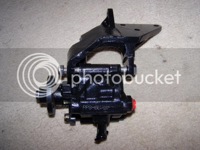

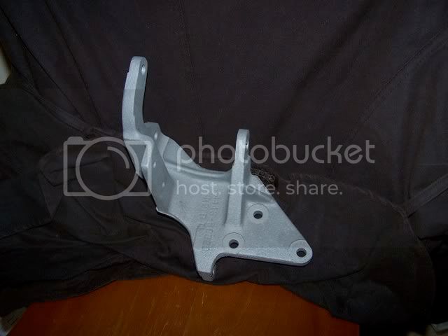

Well thanks to VTcruiser60 I have a genuine power steering bracket winging it's way from the USA.:cheers:
Today I picked up a rebuilt GM/Holden powersteering pump $80Aus
Now to just fit the two together:D
One main advantage to this pump is it uses a separate reservoir moving it away from the headers and turbo.
Once the modification are complete i'll post up.
Power steering bracket arrived today:cheers:
Now how do you usually tension these:confused:
All ready for a new coat of paint
Looking good too the G/M pump lines up with both the mounting holes and only need spacers to center the pull to the right spot for the V Belt:bounce:
Just have to fit the pulley too it and figure out how to tension it:mad:

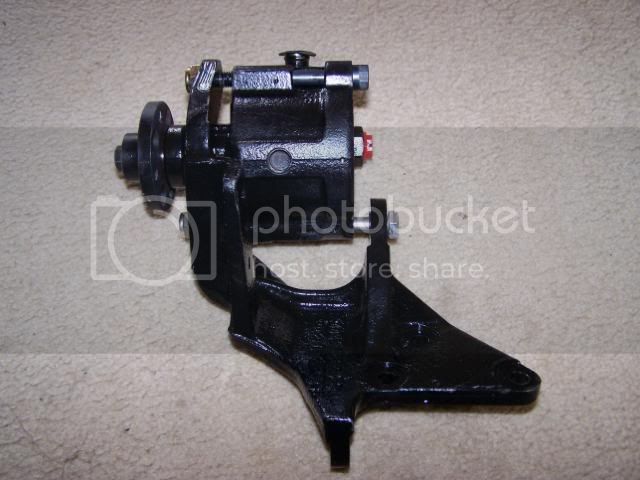

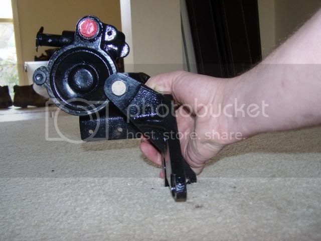

Well some thing just work and some don't this is one of those occasions that does:bounce:
Picked up an new Stainless shouldered bolt yesterday, actually wanted 2 but only had one in stock:mad:so that's on back order, so for now using a Allen cap in one hole.
Well what do you know a GM power steering pump for a Commodore VT and more(most common car on the road here) has the same spacing for the bolts. It fits straight in to the 2F power steering bracket. Off the shelf here fully re-co'd $80Aus.
All I need to do is space the pump to suit the pulley with a few washers or I may even machine up a bronze bush as a spacer. All too easy, the fluid reservoir will be moved to the opposite side away from the heat of the upcoming turbo and exhaust manifold.
One other issue is to fit the pulley to the pump which I will figure out when I swap them over during the engine swap.
