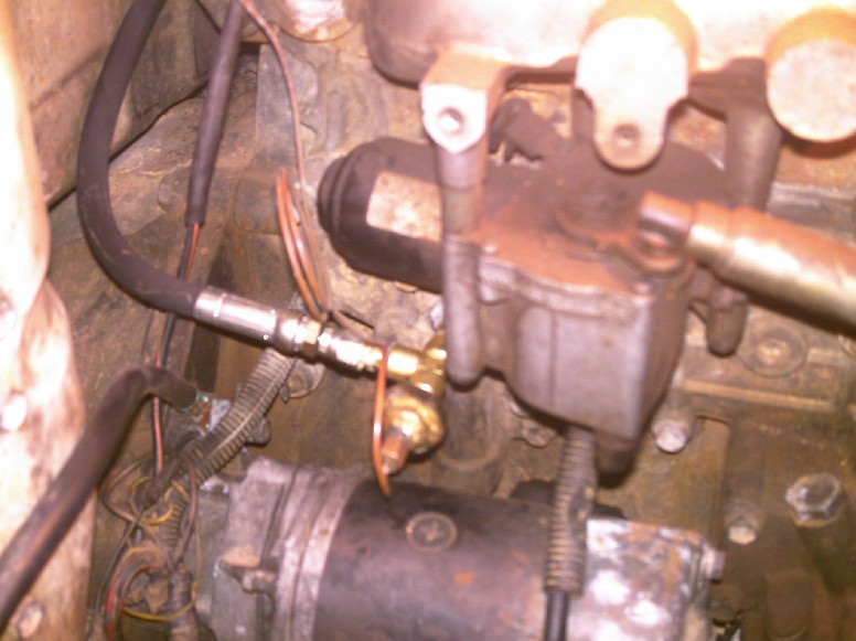

Is this where I tap into the oil galley for the turbo?
Thanks,
MEL
Simply use a "T" in the same location where the oil pressure sensor is located. You won't hurt the oil pressure sensor since it just measures pressure. That's where the AXT turbo takes oil from.

good find for another turbo option! i hope we get a well detailed and photographed build up! the oil sending unit is to the right of the oil filter on mine and it has a couple of wires off of it to feed the gauge, watch you dont short these out or you will burn out the gauge.

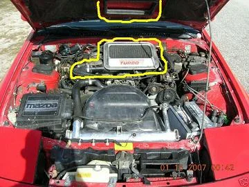

I may attempt a top mount intercooler like the one on a gen 2 rx7.

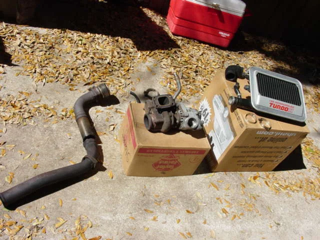

I got the Mercedes Garrett t3 turbo today.
I paid $100 USD for it and it is soild.
It is a model ta0310 from a 85-86 300d Mercedes.
The ta0310 is an upgraded ta0301.
The ta0301is from the 80-84 Mercedes 300d.
The waste gate is spring activated and set to 9psi, where I will leave it.

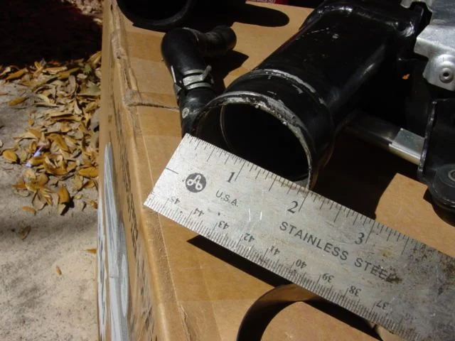

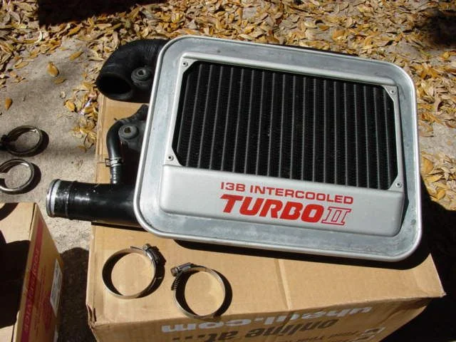

I gathered an inter cooler and silicone elbows from a 89-91 s5 turbo II rx7.
These are plentiful. They are often replaced day one with a front mount kit.
Mine looks brand new. It was $40 with elbos and clamps.
The 86-88 s4 turbo II rx7 inter cooler looks similar but has a smaller inlet.

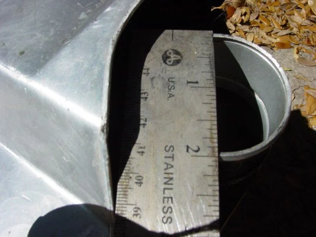

The s5 has 2" inlet/outlet. The 3b throttle body and Mercedes turbo outlet are
also 2". This will make plumbing a lil simpler. (maybe) I will have to cut a
hole in the hood to make it effective. I also to grabed the oem Mazda clamps.

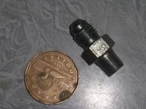

be all apart. The oil line kits are all over ebay. A honda civic also uses 1/8bst
for the oil sending unit.
