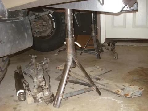

Next step was to decide what type of lift and size tires I wanted to run. The most important objective was to be very road worthy. Most lifts available for the 80 were mostly alike using stock or after market radious arms. The 80 radious arm are alot like the old bronco radious arms not alowing alot of articulation.These systems are very worthy and do a great job but I was on a quest to do somthing different. I decided to use a Rubicon Express JK long arm for the front. R.E. has put alot of R&D into this design and has rave reviews. Believe it or not a well outfitted JK weighs close to an equivilent 80. My first step was to parked it in the garage and put it on jack stands. Two out of four of my home built stands were at my buddies place being used. I had to build a couple of new ones.
Jodo
