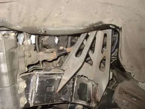

After Moving the steering up front and setting up the radious arm brackets on the housing, I had to make the biggest decision in the whole build, lifted coils or coilovers. I knew going coilover would intail cutting off the factory coil buckets and shock towers. I've talked to alot of guys that were very happy going coilovers on radious arm systems (TJ's). So, I went for it. I found a coilover tower designed by Currie for the Jeep TJ that worked perfect.

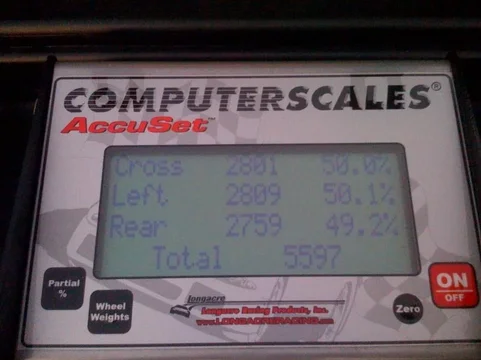

As you can see the Currie tower worked perfect with the factory "Swoop" in the inner fender well. My plan was to use 12" x 2 1/5" Coilovers. I called to find out which manufacture to use and found that FOX was a favorite by more people. The FOX had great customer support to. In order to size coilovers for a rig you need to take vehical weights on all corners.
