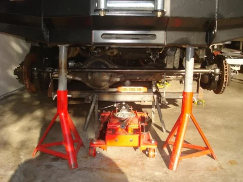

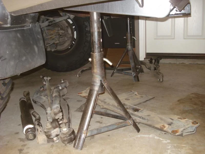

Next step was to decide what type of lift and size tires I wanted to run. The most important objective was to be very road worthy. Most lifts available for the 80 were mostly alike using stock or after market radious arms. The 80 radious arm are alot like the old bronco radious arms not alowing alot of articulation.These systems are very worthy and do a great job but I was on a quest to do somthing different. I decided to use a Rubicon Express JK long arm for the front. R.E. has put alot of R&D into this design and has rave reviews. Believe it or not a well outfitted JK weighs close to an equivilent 80. My first step was to parked it in the garage and put it on jack stands. Two out of four of my home built stands were at my buddies place being used. I had to build a couple of new ones.

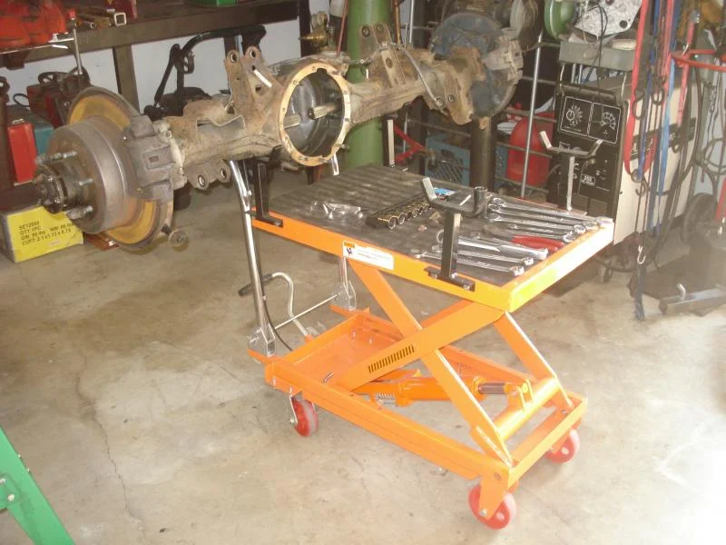

I decided to install factory lockers vs after market. I searched and found a rolled 80 with lockers (minus diffs) for $350. I was able to strip all the parts I needed and more, sell the rest with enough cash to buy new locking diffs from Toyota. I bought a 1000 lb lifting table from Harbor freight for $200 to hold/move the axels around while I worked on them.

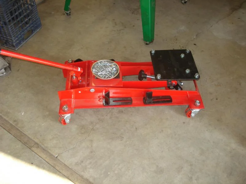

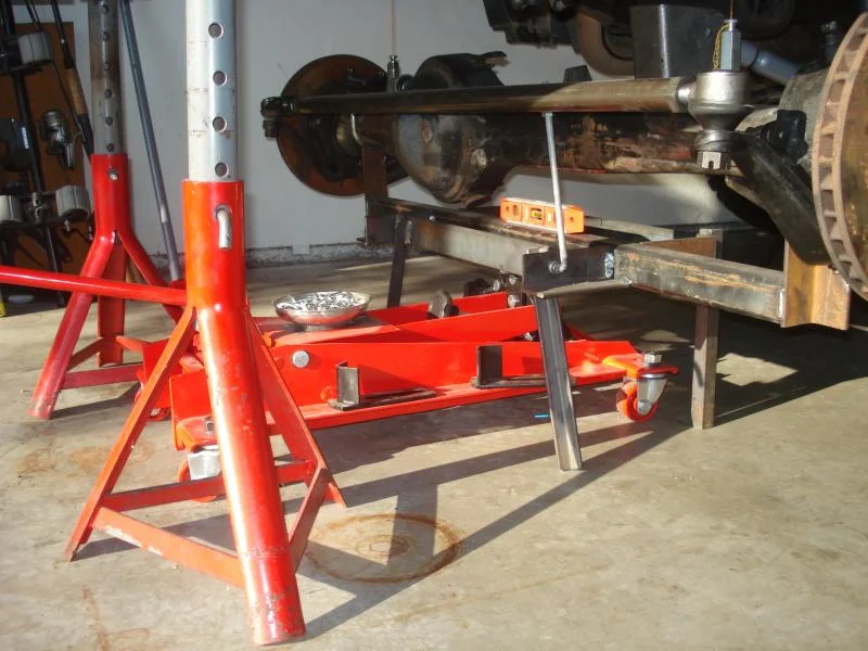

Setting up the front axel was going to be tricky and would take some thought to do it wright. I went to Pep Boys and bought a Close out tranny jack for $29.

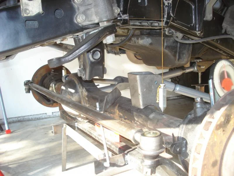

Then I built a holding bracket for the front axel housing so that I could set the caster and hold it in place durng fabrication.

The fabrication started out with taking measurements and contimplating each frabricating move.

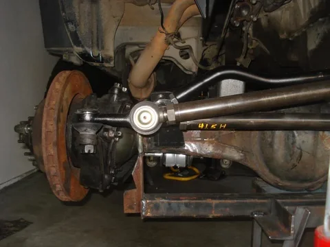

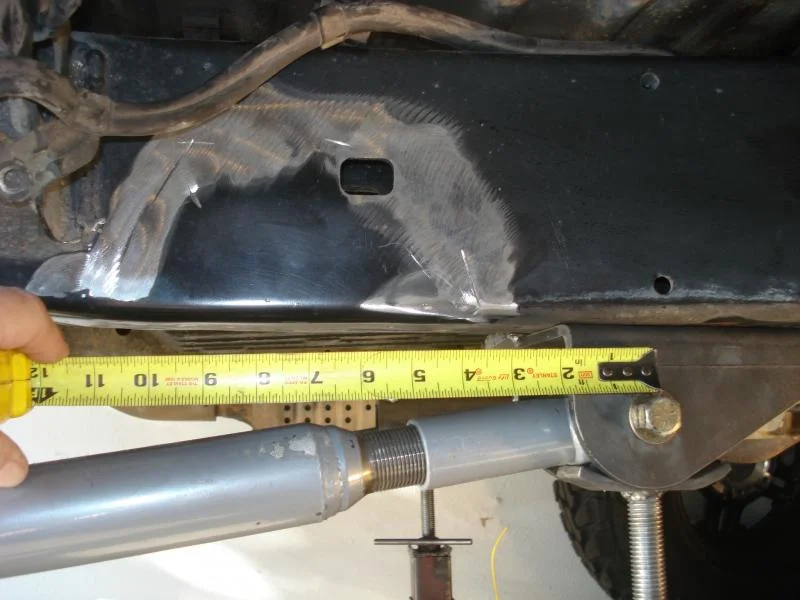

Deciding to go with the R.E. JK long arms for the front, the factory radious arm brackets had to e cut off. here you can see how much longer these are from stock.

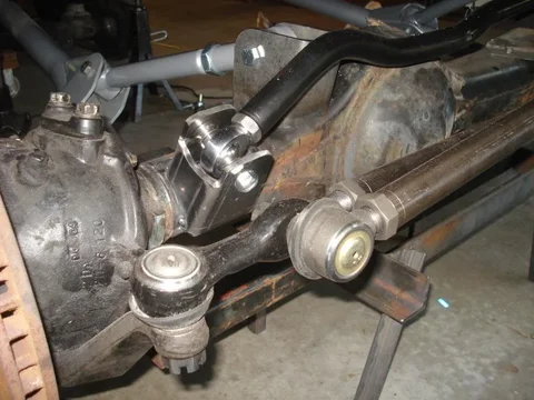

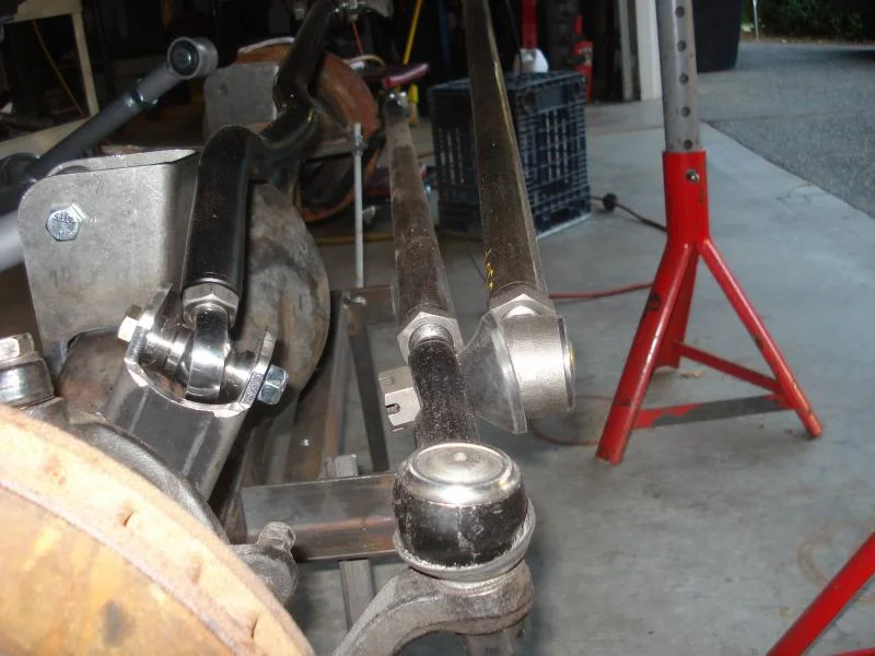

While deciding to use the new radious arm it caused interference with the rear tie rod. I found by using a RHD arm and chevy tie rod ends with DOM tube I was able to move the entire streering up front alowing for endless possabilities for links systems. The axel brackets I used were also from Rubicon Express.
