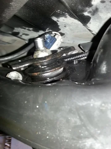

I used that 22 because it was the only one that fit into the recess like in your pic below
I first tried a socket but I didn't have space above the socket to get it in place, then a flat 22 would just slip as there was no grip so 3rd time lucky with that 22 as it fit into the recess, but I was ready to cut a hole in the floor by then, so I know the frustrations

A thought... have you tried putting in the wrench, then clamp down with vise grip to the recessed bracket of some sort? Curious... does that recessed bracket move around... circled in red. If it does, I think you can loosen it around with some long piece of pipe (slipped over the wrench?)

dfrelich- I did try using locking pliers to grab that bracket but the shock body would still rotate.
