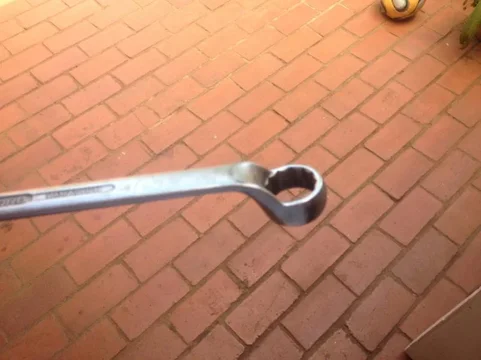

22 spanner & then bought a filter wrench & had to go in infront of the axle and feel by hand, only place I could get enough movement, then had another pair of hands on the filter wrench and slowly but surely it eventually came off
thanks everyone for the replies! lots of good ideas. Shane, I think that 22mm spanner would work great. If it doesnt work, cruiseroutfit's idea of welding a bar onto a 22mm socket should do it. Just have to wait another 2 hours for sears to open... :wrench::wrench:
I used that 22 because it was the only one that fit into the recess like in your pic below
I first tried a socket but I didn't have space above the socket to get it in place, then a flat 22 would just slip as there was no grip so 3rd time lucky with that 22 as it fit into the recess, but I was ready to cut a hole in the floor by then, so I know the frustrations

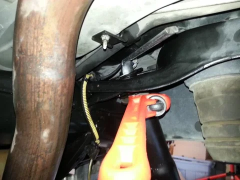

22mm offset wrench with a pipe wrench did the trick. Had to cut off the other end of the wrench so I could slip a cheater bar over it. I had a hard time finding the wrench though. Anymore, sears is pretty worthless with their in store tool selection. Ended up finding one at harbor freight so i didnt feel too bad hacking it up.
At first I put the pipe wrench on the shock body but that must have broken loose from the top mount since something was still allowing the shock to rotate. At that point I was about ready to hack into the carpet but tried one more time positioning the pipe wrench just above the shock body and grabbing the metal just above the rubber bushing. That worked. Install was much easier without the stupid AHC bracket on top of the OME shocks.

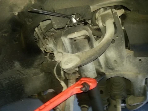

Pretty much the same process for the front, except was able to grab the shock body with the pipe wrench. Again, made a huge mess on my newly expoxy'd garage floor, but it seems to clean up with some acetone. Now I see why some shops charge 4-6hrs just for AHC removal.
