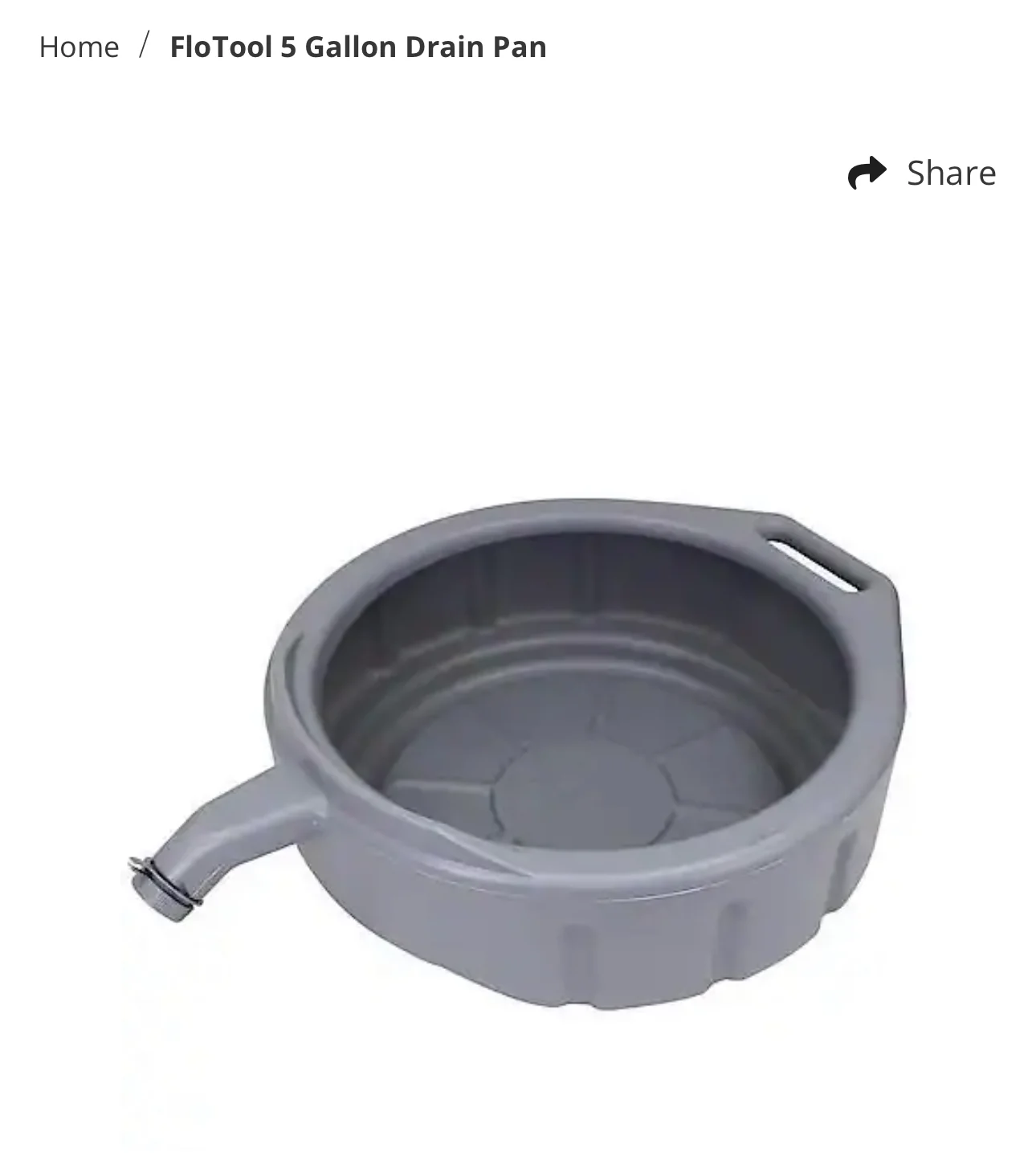

I’ve tried many different solutions over the years. Between myself and friends/family I do between 15 & 20 oil changes in my driveway per year.
By far the best setup I’ve found is the flowtool 5-gal catch pan and two standard 5 gallon buckets and lids from lowes. The home depot lids aren’t as good. The lip being curved inward helps a ton with preventing any splashing getting outside the pan.
The self contained pan/containers are bad about splashing and inevitably the pan plug will crack in a year rendering the whole thing useless as a container.
If you’re OCD like me only glitch with the flow-tool is the downturned drain spout makes a small pool behind the cap after draining. This will eventually drip on the ground. Stand the unit up for 5 minutes after draining but before storing and this won’t be a problem.
I have two buckets because I only put 3-4 gallons in each to avoid any sloshing during transport hitting the lid and increasing cleanup.
