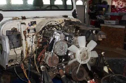

It's a 1984 truck.
I swear I think I saw this truck here on mud, because I have many pics of it. Here is another view of the engine:
That's my 84. It's a Swiss model. Most of the FJs here were modified at the dealer in Safinwil with this compressor and a nice tank and air brakes for heavy-dutry towing.
I no little about compressors and still am on a hijack to know what my compressor style is called.

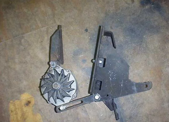

I'm coming to the conclusion I need to get a three position pulley and put the compressor under the hood. That means the alternator will have to move to the former smog pump position to make room for a York. Or I put a regular AC pump in the smog pump position and plan on replacing it periodically.
Unless somebody has other ideas???
Engine mount and bracket idea... although the belt routing needs to be changed to include the crank pulley for main drive source..........

You need to see Mudrak.com. He makes a bracket that mounts where the alt is but it also has a provision for the alt. Its a slick setup.
Not affiliated, just happy with my York Bracket.
Good luck
Good luck

I'll look into it.
mudrak is a great guy dan..
Good to hear.
