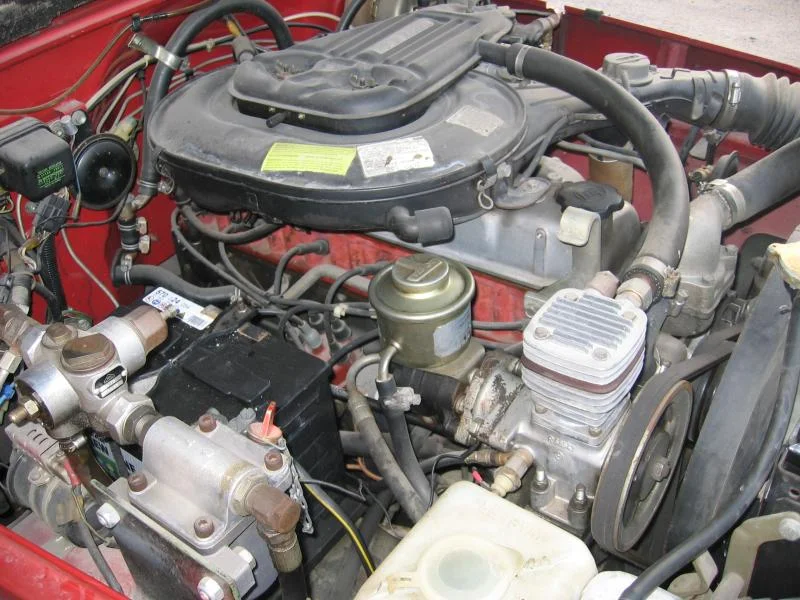

Is this a York?
Reading about York compressors and how they're driven normally by belts, and knowing little about anything, I jack this thread and ask if this is a York-style compressor, and if not, what type is it?
In any case, I am always filling my air tank (used for pneumatic brakes) and burning extra fuel since it's attached to my power steering pump.
i dont know if this includes toyota fj 40 but all the trucks i have driven have a big red sticker that says do not drive vehicle with pto engaged. i would check this first before you do this plus you will need a belt drive to increase rpms. maybey another air tank would help good luck
I don't believe it is. But it is a very cool setup. I'd like to see more pics of the belt arrangement. Pretty slick with the power steering pump.

It's a 1984 truck.

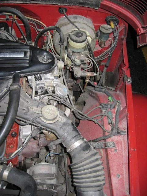

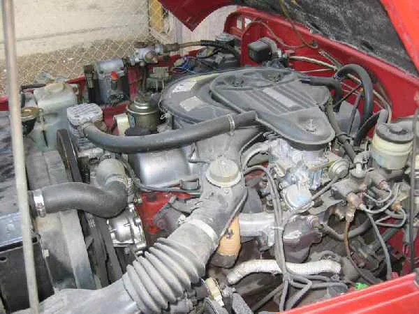

I swear I think I saw this truck here on mud, because I have many pics of it. Here is another view of the engine:
