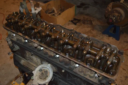

Still fighting with the distributor. All I have managed to accomplish is this, oops.
Usually I try to keep parts I am not going to use in good condition in case someone else wants them, but...
if the oil pump mounting block was ever disturbed, it may be binding the dizz...I had to pound one out from underneath once...ugly...so make sure that block is aligned and never move it again...you can align it once you get the old dizz out by loosening the bolts a bit and installing the dizz, tighten a bit at a time making sure the dizz still moves- that may not be the case here, but be aware that those 2 bolts below the dizz above the pan rail hold a block to the block which receives the oil pump which receives the dizz shaft...it should never be moved from the factory position...trust me.
Oversize SBC valves are extra work and only needed IF the guides are worn. Having done this mod and this dance with a machinist, here's my line...Jim says that he does this on heads that need new guides. drilling out and pressing in new inserts costs money and usually the guide inserts aren't as good as OEM...Now a SBC valve stem is just a bit fatter than the toyota, so a quick ream leaves the OEM guides square and sized right for an SBC valve stem. Now, take advantage of the stainless option not found as affordable for the toyota, if at all. this prevents warping in the event of exhaust leaks- there is no chance of interference in the F, 2F, 3F, so when the machinist expresses concerns over shattering valves, poo-poo them, and insist on stainless. Also insist on 1.50 not 1.60 exhaust valves and 1.84" intakes...the large 1.6 exhaust valve will have the guy need to grind out the seats and install new inferior seats. by sticking with the regimen, your existing high quality seats just get opened up a bit, cleaning them in the process. new springs and hardware don't have to be fancy and are cheap. I believe it is a Ford valve stem seal that is used...don't forget to have the gally plug threaded and plugged with a real plug...HTH

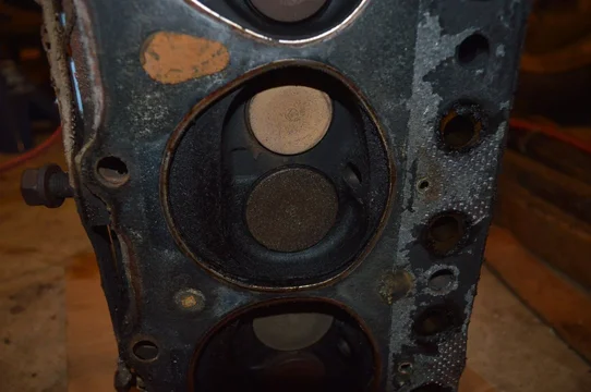

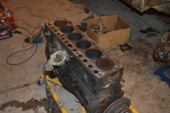

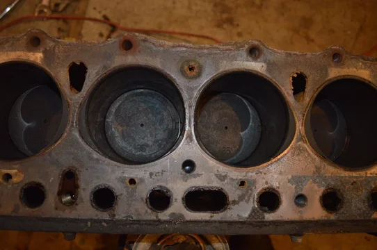

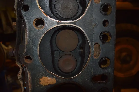

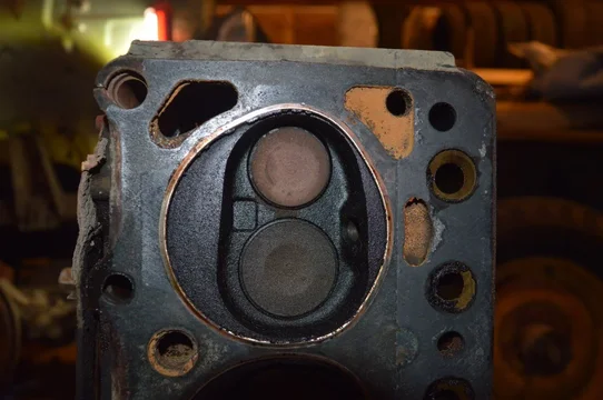

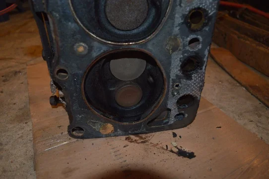

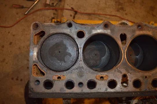

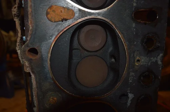

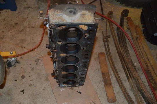

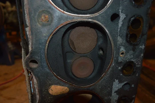

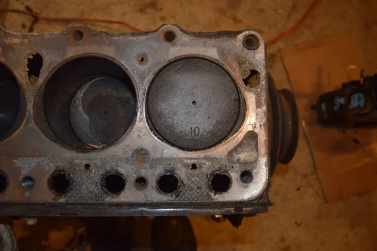

Alright I got the head off of the 2f today. It went pretty well, although a few of the head bolts needed a bit of coaxing to come out. The cylinders look very good. Cross hatching is visible on all of the cylinders and there are very slight marks on the 3 and 9 o'clock sides of all the cylinder walls (when viewed from the front or back), I am not concerned though because I think that is normal and you can't feel them with your fingernail. Think in terms of smudges on glass. The walls of the cylinders have a mirror finish to them which makes it hard to photograph. But here are some pictures,
Jan 5th, 2016 - 2f head removal 005.webp Jan 5th, 2016 - 2f head removal 007.webp Jan 5th, 2016 - 2f head removal 009.webp Jan 5th, 2016 - 2f head removal 008.webp Jan 5th, 2016 - 2f head removal 012.webp
More,
Jan 5th, 2016 - 2f head removal 019.webp Jan 5th, 2016 - 2f head removal 020.webp Jan 5th, 2016 - 2f head removal 022.webp Jan 5th, 2016 - 2f head removal 024.webp

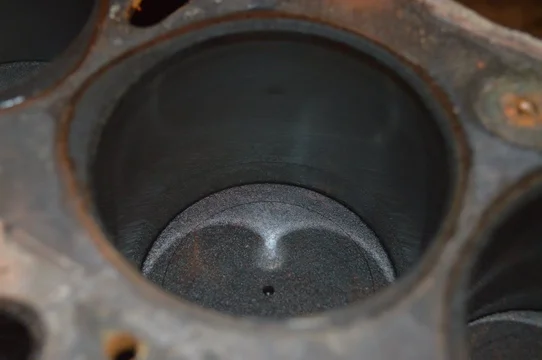

Utilizing the manual focus and having the camera very close while shining a light down at an angle I was able to take this picture that shows the cylinder walls better. In the bottom right of the photo you can see the scoring marks I was talking about,
What do you guys think? And why do pistons 3+4 have 35 stamped on them but the others have 10?
Edit- Here are some better pictures of the cylinders,
