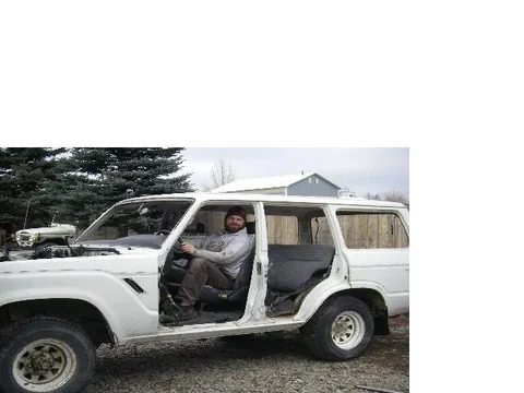

I pulled all the doors and glass. Stripped every piece of chrome.

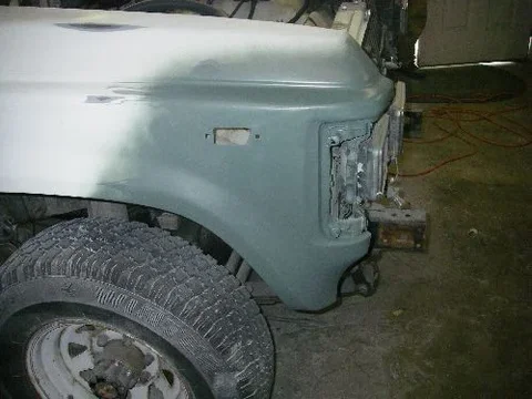

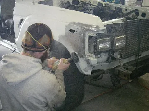

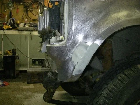

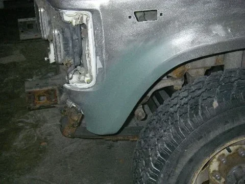

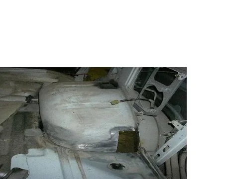

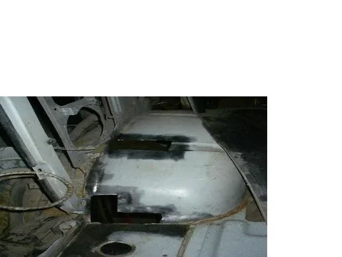

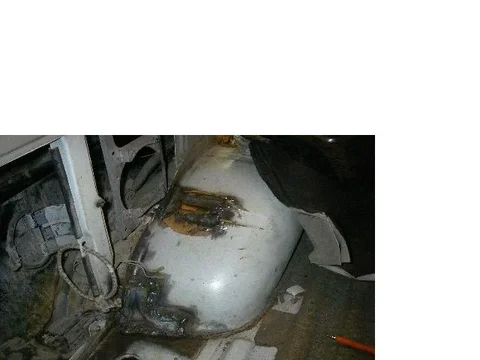

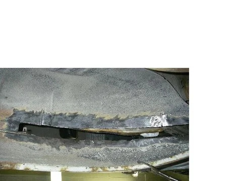

And started in on the bodywork. First order of business was to fix the rust in the rear quarter panels. Started with cuttin' and patchin' under the fenders. six patches total
im not gonna show ya the patches cause they aint purdy
done

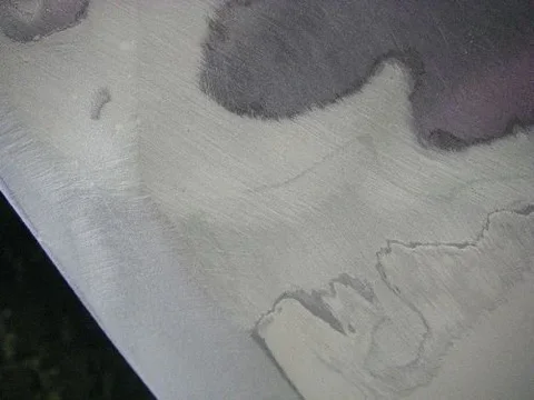

Next I did a thorough full body preclean. It took about two days and 12 rolls of shop towels to get down to the paint. Changed 6 shades of white.

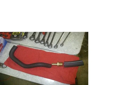

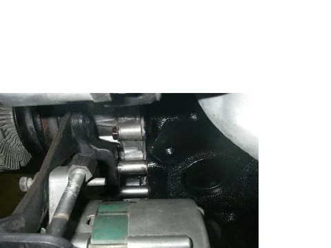

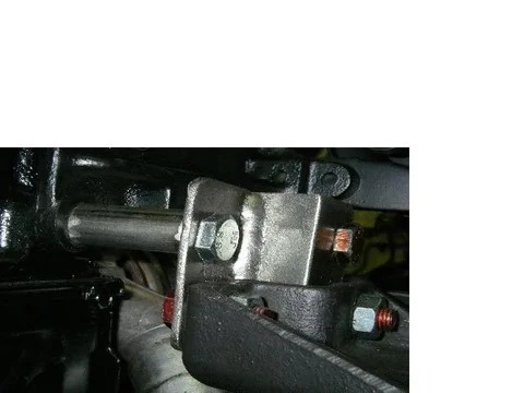

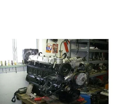

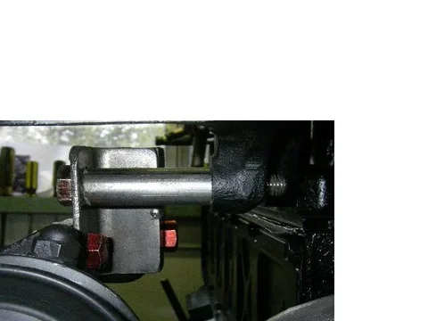

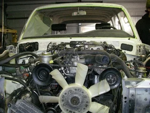

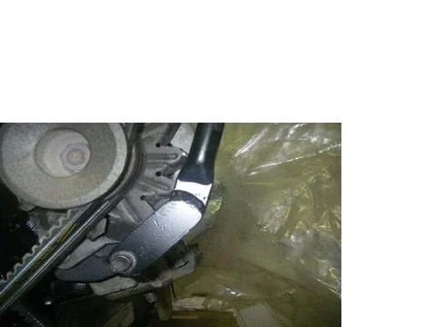

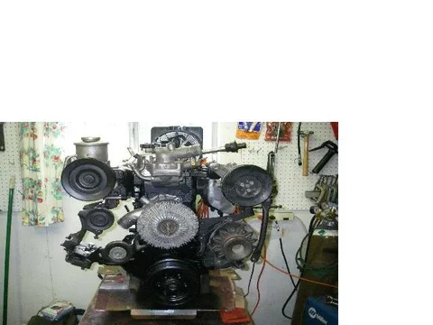

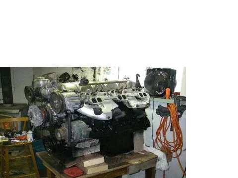

Meanwhile, PER had finished the engine. So back to Portland to pick it up. Ordered all the underhood hoses, plug wires dist cap & rotor, O2 sensors, etc, etc, etc, from TGAPJH. (John Hocker) www.sierratoy.com. I couldn’t resist the temptation to start puttin' er back together. I had already fabbed the brackets that I would need thanks to Tonkotas write up on the 2FE conversion. :cheers:Tonkota www.steelnthings.com. Now it was just a matter of remembering how it all went together. Took about 2 ½ days fartin around to get everything together and all the belt sizes just right.

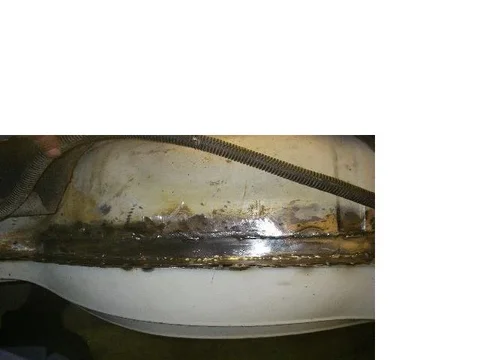

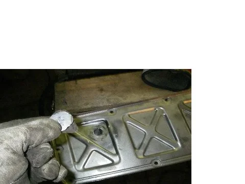

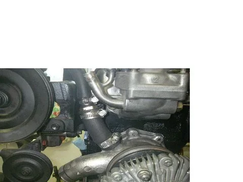

cut the pcv tube off the 2F side cover, welded a patch in

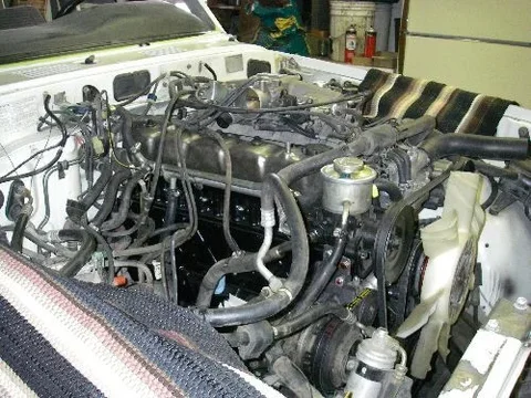

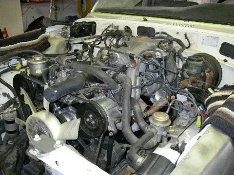

2FE INSTALLED:bounce::bounce2::clap:
Well as soon as the motor was dropped in and all hooked up work slowed down for the winter, a lot. So this summer has been spent playing catch-up and not a lot of progress on the cruiser. Waiting for exhaust before I fire her up.:cheers: More to come.

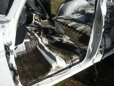

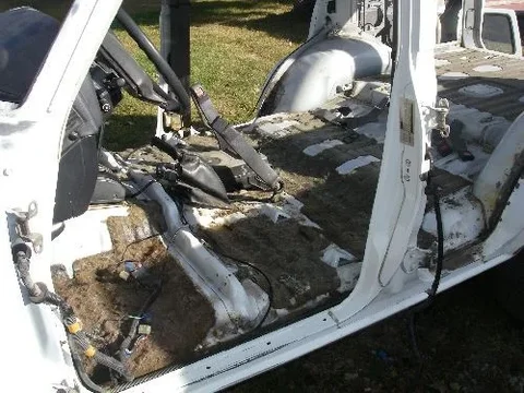

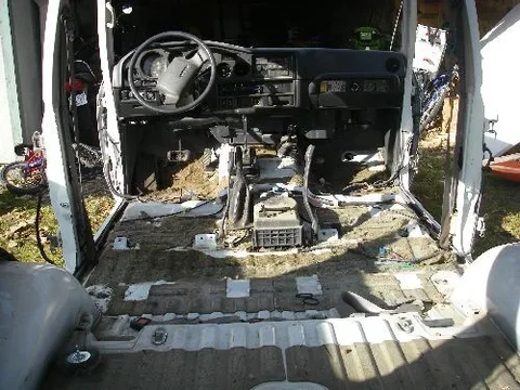

tore the carpet out today and cleaned up all the fuzz. Was this sound deadener stuff Original? If so has anyone been successful in getting it out? seems like it would take some hella stout chemicals to even make a dent.
