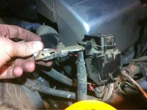

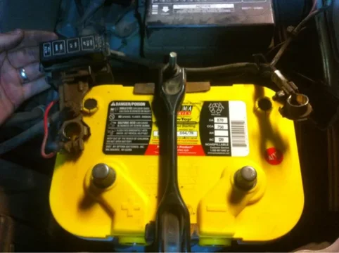

Today's projects have been one road block after another. Wasn't expecting a battery install to throw me for a loop. Installing a optima yellow top but neither positive or negative cables reach the battery terminals. The positive is tethered to the fuse box by a pretty short leash. Can't really flip the battery around either to get the terminals closer to the cables. Suggestions? Gotta have this working tonight? Should I just rebuild the cables?
Not to mention the huge kludge of fuses attached right at the en of the cable.

Ran into this problem wi my FJ. Turns out I bought the battery with the terminals on the wrong side of the battery. I believe it was called something like reverse pole or something. Seems like the only thing you can do now is extend the cables. Try not to cut anything though.
Is this Optima designed as a primary battery in the stock location? I think most put a Red in the stock location and use a Yellow as a second battery (where there's more flexibility with orientation, cable routing, etc.).
All the batteries were the same at the store. There were no switched terminals. The red and yellow both look the same except for color. This is my primary. No way I will be able to extend these cables tonight. The extra fuse box thing on the positive is welded on there pretty good. Not even sure what it is there for.
Paul, keep the yellow battery for your secondary battery. Red is for your primary. For one night, you should be ok on your old battery... If not, bring some jump cables for the morning start. We will be driving most of the day Sat, so your alternator will charge battery and power your fridge.
Looks like you bought the wrong battery. I would return it and get the correct one rather than hacking together extenders from the OEM terminals. Also, IIRC, red is more of a deep cycle starter battery. The yellow tops are more of a deep cycle battery. I believe the Reds are better at powering a starter and the Yellows have more charge cycles before they "die". Blues are similar to Yellow tops, but i can't remember the difference between those.

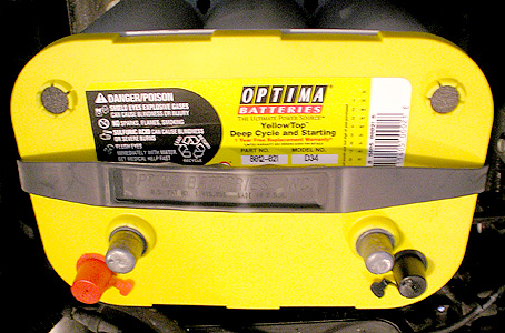

That looks like a 34/78. You need a 35 series battery. I actually did the same thing with my FJ Cruiser. I just bought a dual battery kit and used the optima as a secondary battery.
34 series
Correct orientation, 35 series.

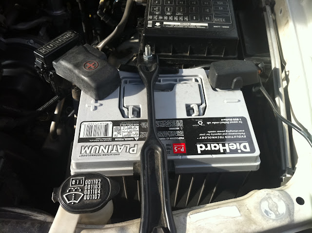

Yeah. Lesson learned. Bought a sears die hard for primary. I'll keep the optima for dual setup later. The optima came with a nice spacer to adjust the height. Now my problem is the sears is too short for the restraining bracket. If its not one thing it's another

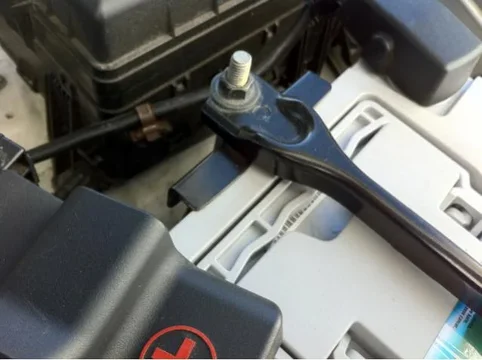

This once fits like a glove. look closer near the red sticker, the clamp on this side slides down around the side of the battery. the bottom of the strap is firmly down on top of the battery, works great :cheers:
I just needed the vertical spacer. Plywood is working temporarily. I feel pretty stupid having rushed all this to be able to get my new toys up and running for the weekend trip.

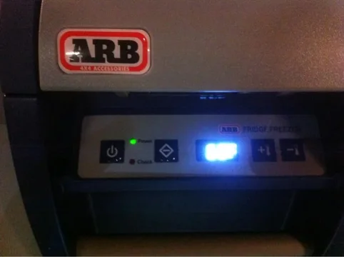

Let there be cold beer
