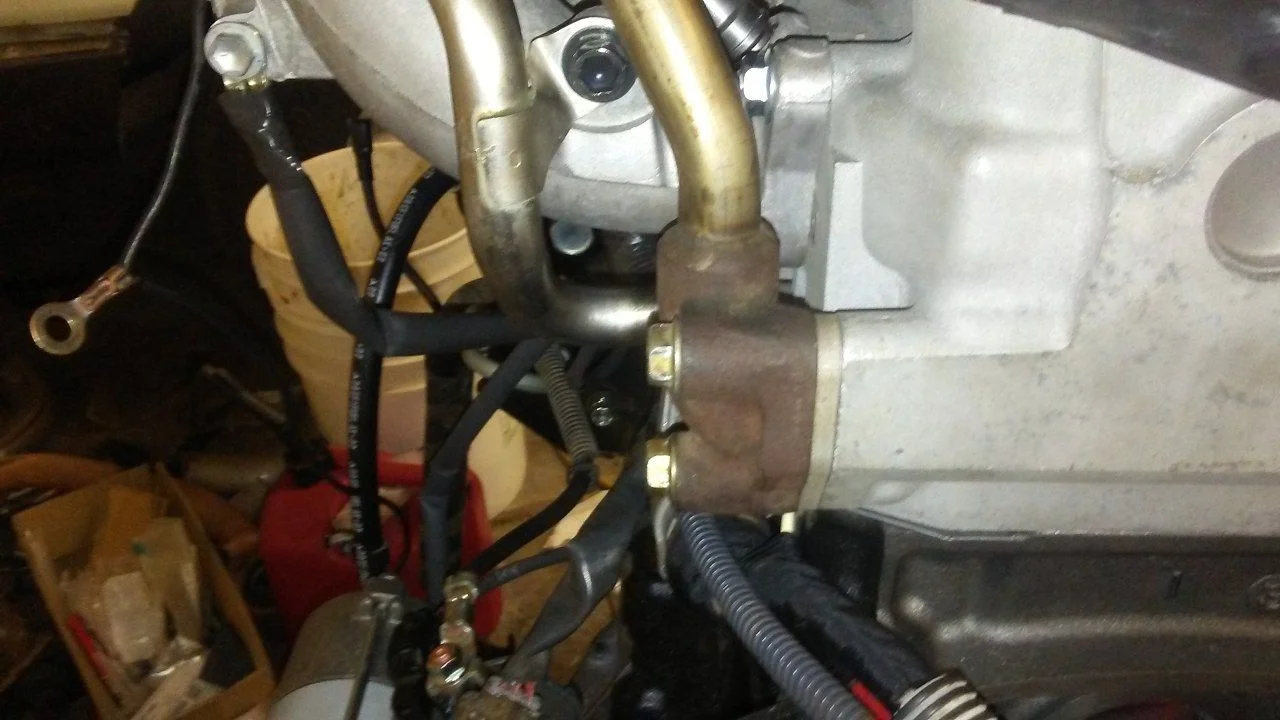

I wrapped mine with lava rock heat wrap. I can't imagine that a foot of pipe is designed and moreover expected to shed heat, so I just did it.

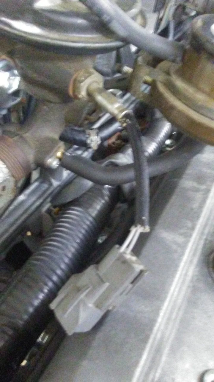

Sand which a block off plate an call it done the restiot goes between wire or find a resttor plug off a 93 the discontisold. solder the reztitor bring the two wires together
82824 35020 93 only harness has reztitor built I plug easy 2 pin connector
Cut wire on engr temp sensor an install resistor. Give false restiance values. That's if you dont want cut your harness an make a plugin in resttor off egr
plug
take that egr connection. Snip it use radio shack part. Solder both ends together then plug that into your harness. It will give a false reading no egr needed an no hot pipe I have block off plates gotta get me a Paypal account 1st though.
Egr is us spec non us spec dont have egr. Egr is for the feds the philth the control. Just smile at the Dmv with restior an block off plate an dummy egr replace intake egr gasket also. Cuz u wanna keep 14/1 gasburn no intake leak

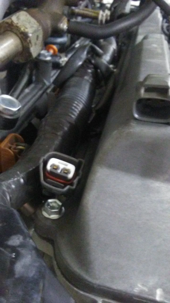

OK, the part I don't understand is where people say to plug it in to the harness. Plug what into what? Do you take the resistor and bend it so that each end goes in one of the wire ports on the connector the car came with? Does it matter which end goes where, etc? The pics help, but it is still kinda fuzzy in my brain. This is why leaving it alone seems like the better option for me.
I like greentruck's advice. I think I am just going to wrap the pipe and see how it looks. I may wrap the wire harness too with the rest of the fiberglass tape.
I bent the ends of the resistor and plugged it into the harness, then sealed it up with electrical tape. Be careful when bending the ends since they can break (having the radio shack 5 pack is handy in case you break one). No cutting of the harness needed. It doesn't matter which end of the resistor goes where since its just closing the loop.
A temperature sensor (like the EGR one) is just another type of resistor that the resistance changes depending on temperature. With the resistor in place the system is "seeing" a temperature that is within the expected range.
Irregardless of the resistor method make sure to secure the harness so that it doesn't touch the EGR pipe. As long as you have some clearance and the wires are safely within a loom they wont burn up. The point of the resistor method is to further protect the wires by not allowing the EGR pipe a chance to get hot in the first place.
