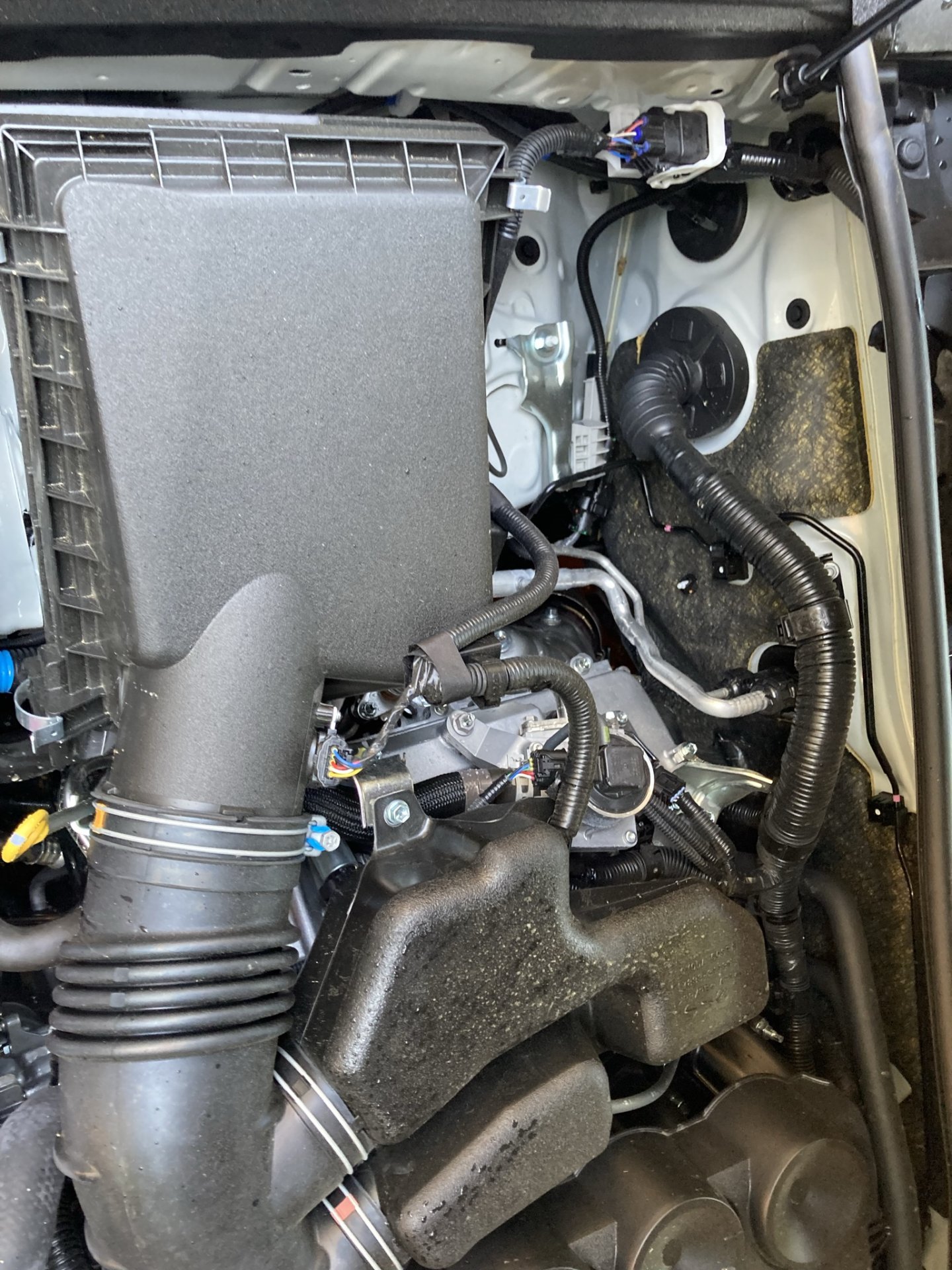

When I went looking for a new 4runner last year I bought one that arrived at the dealer with 3.3 miles on it. Being that the Tahara test track is 3 miles long, I was fairly confident mine had been test driven at Tahara and that made me extra interested in snagging it that day. It drives very smooth like it was dialed in really well. Couldn’t be happier…
Another thing that really surprised me was just how bare bones and well laid out things are under the hood. Very different to the GX in that regard. It looks like it will be a bit easier to work on.
