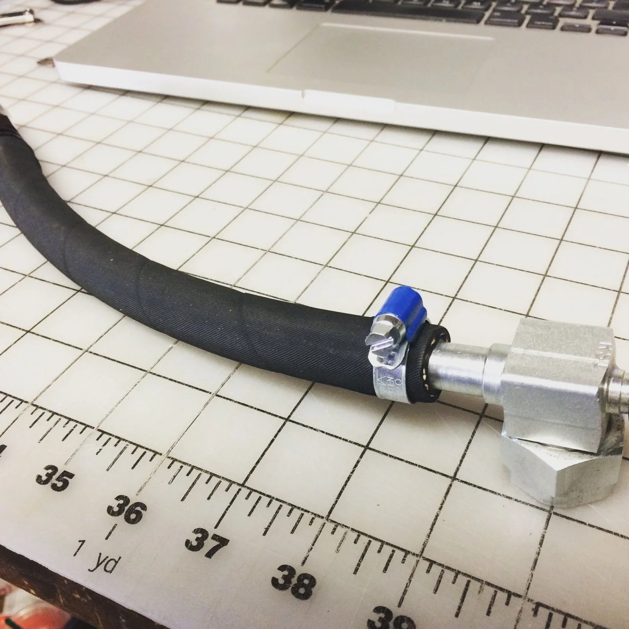

I need to go pick up more 210 fittings so that I can cover everyone for hoses that needs them.

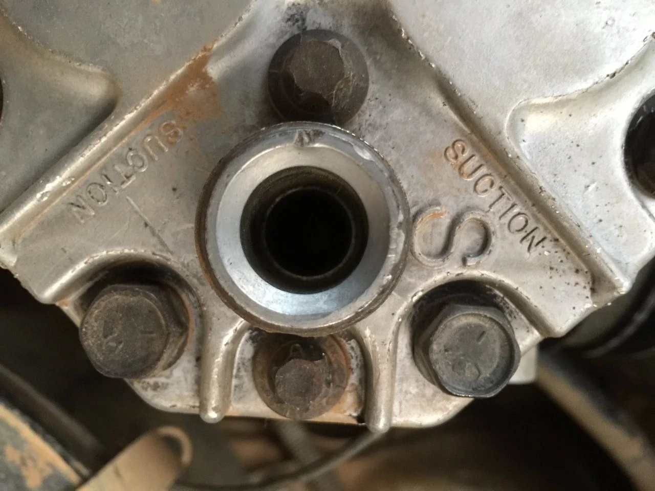

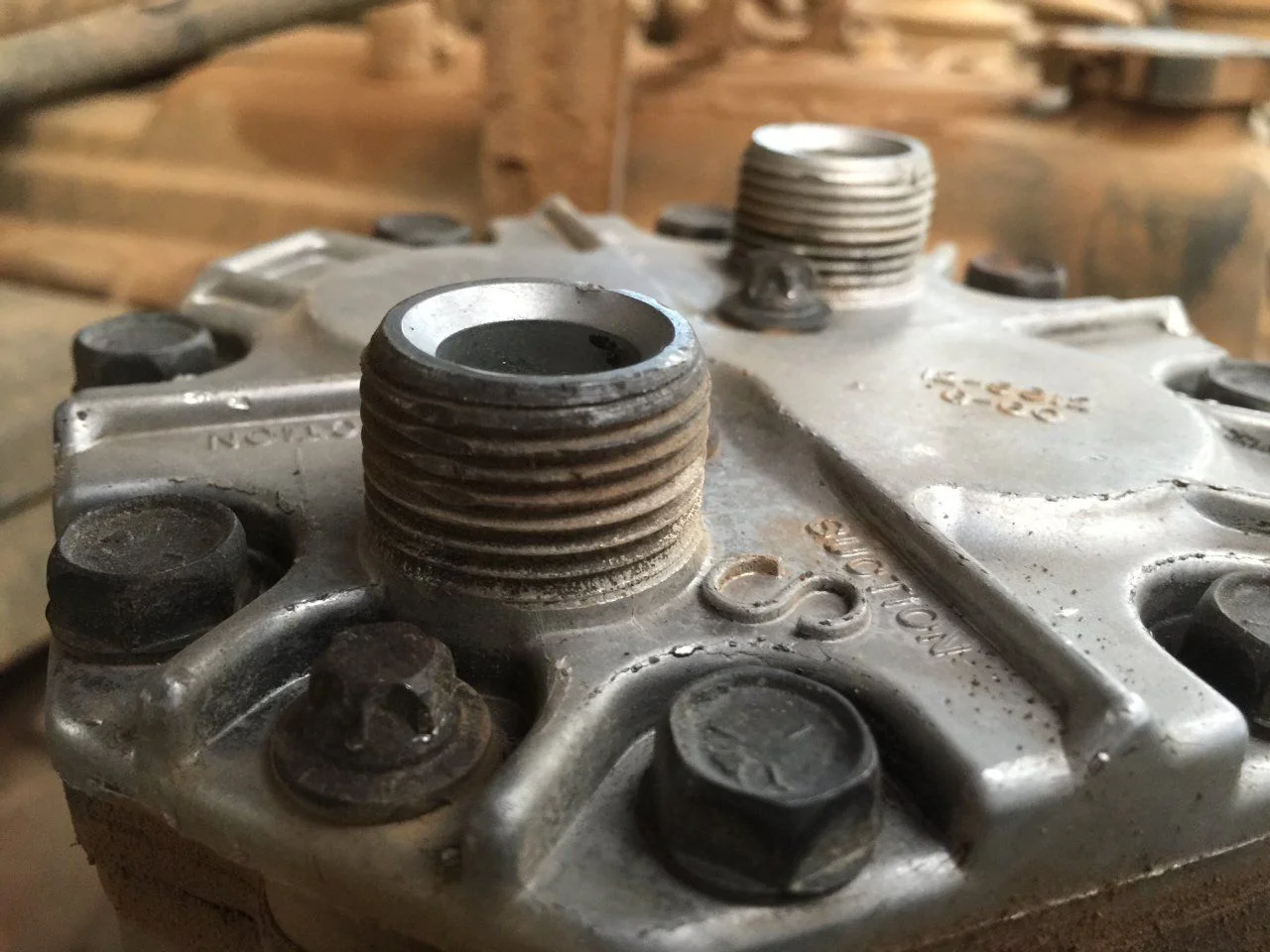

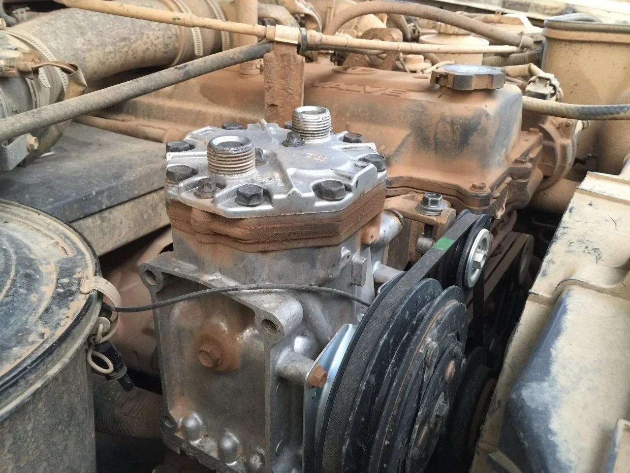

@Razorbackcruiser on Monday I am going to send you out the suction line that fits your set-up. I'll need your report on that to make sure I'm good to go.

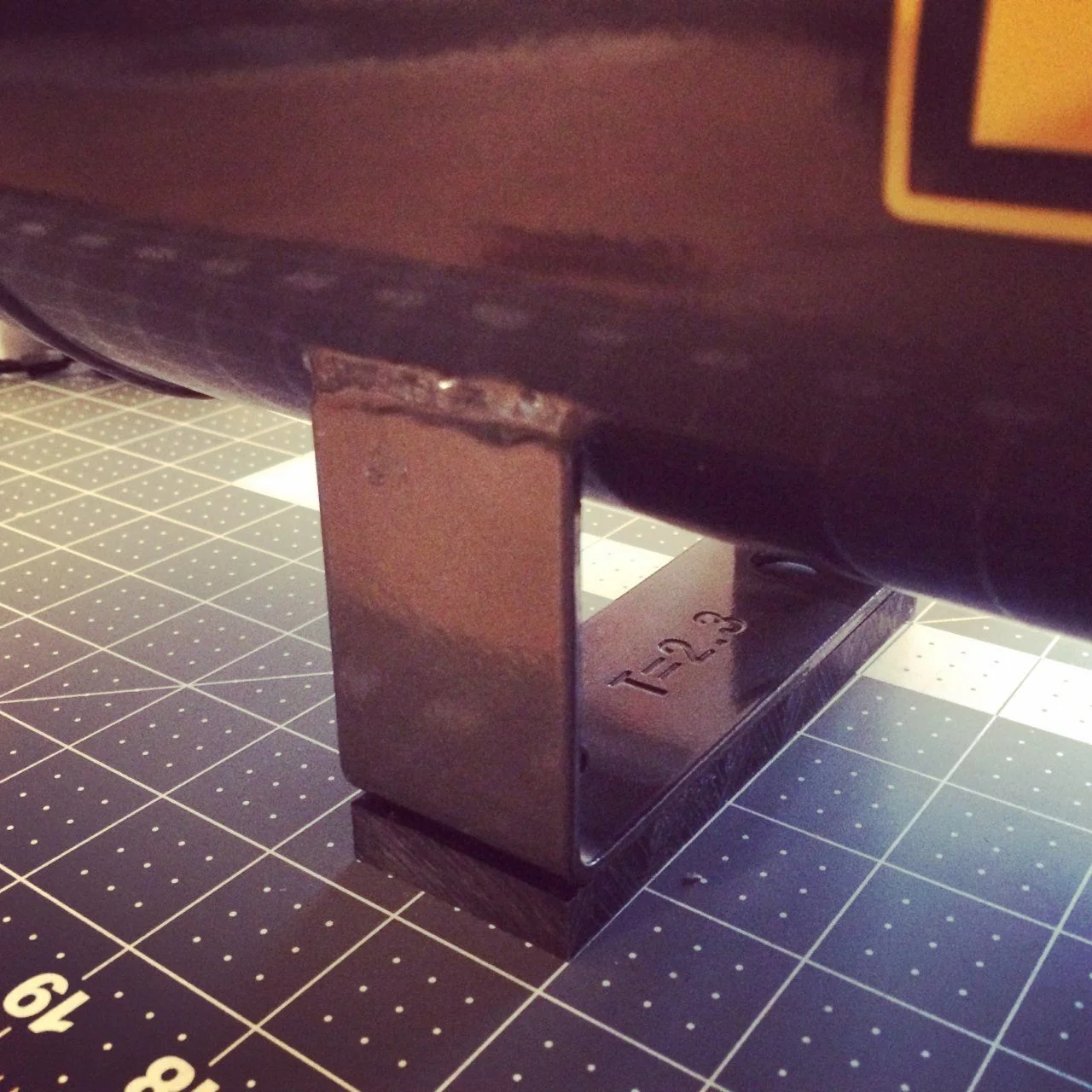

Something that gets overlooked a lot when you are mounting an air tank to your vehicle, slope. You want all of the condensation to pool to the side of your drain valve. Otherwise you run the risk of rust inside the tank. On my air tank kits I include a piece of 3/8" Delrin spacer block to raise the end opposite the drain valve.
#themoreyouknow

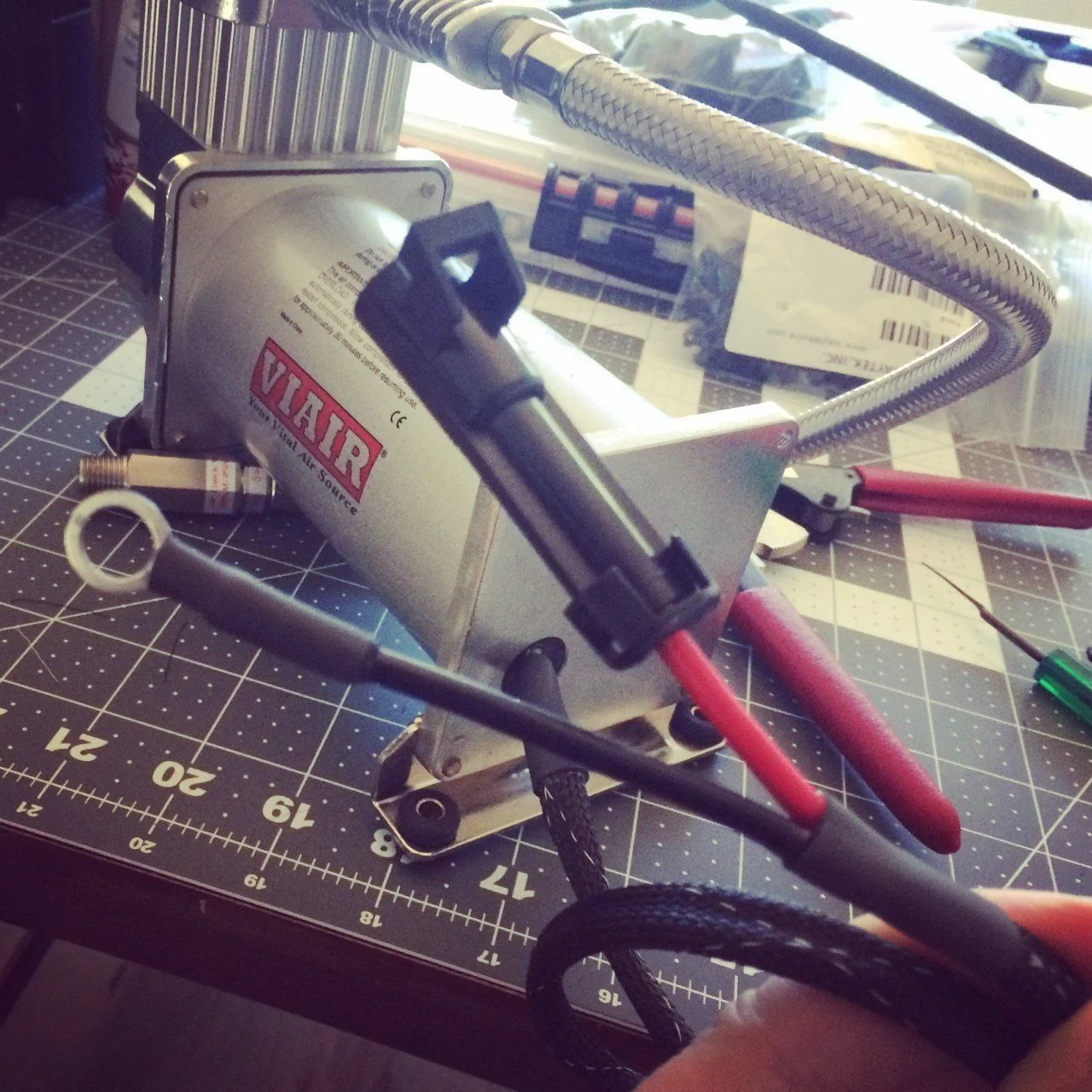

About to wire up a Viair 400C AirCompressor. The wires come pre-terminated but I'm not a fan of the connection terminals especially if this is going to be mounted under the truck and exposed to the elements. Trying to decide if I want to use the Anderson SB50 with the environmental boot or take both wires and use my MetriPack 2-pin weather tite connectors or just use their ground eyelet and just run a 1-pin Metri-Pack.
Shown: The SB50 in the left, the wires as is, the 2-pin Metri and 1-pin Metri.
So here is how the final looks. It's no big deal but tons better than what the compressor comes with. The stock wiring is 12awg so I re-did the heatshrink on the ground ring, ran PET sleeping to protect both wires, used adhesive lined heatshrink and then finally the MetriPack 1-pin connector for the positive.
Well...now that I committed to it I've changed my mind. Here's why:
* have the ground wire be a ring means the compressor doesn't have a true disconnect.
* only the positive wire is a true disconnect
* the ground still need to have a bolt removed in order to make the compressor removable.
* instead I should use a device side 2-pin Metri-Pack on the Viair keeping it truly a quick disconnect.
* on the source side I should have the ground go straight to a solid ground point where it never needs to be removed
I'm going to go ahead and switch it over to a 2-pin.
