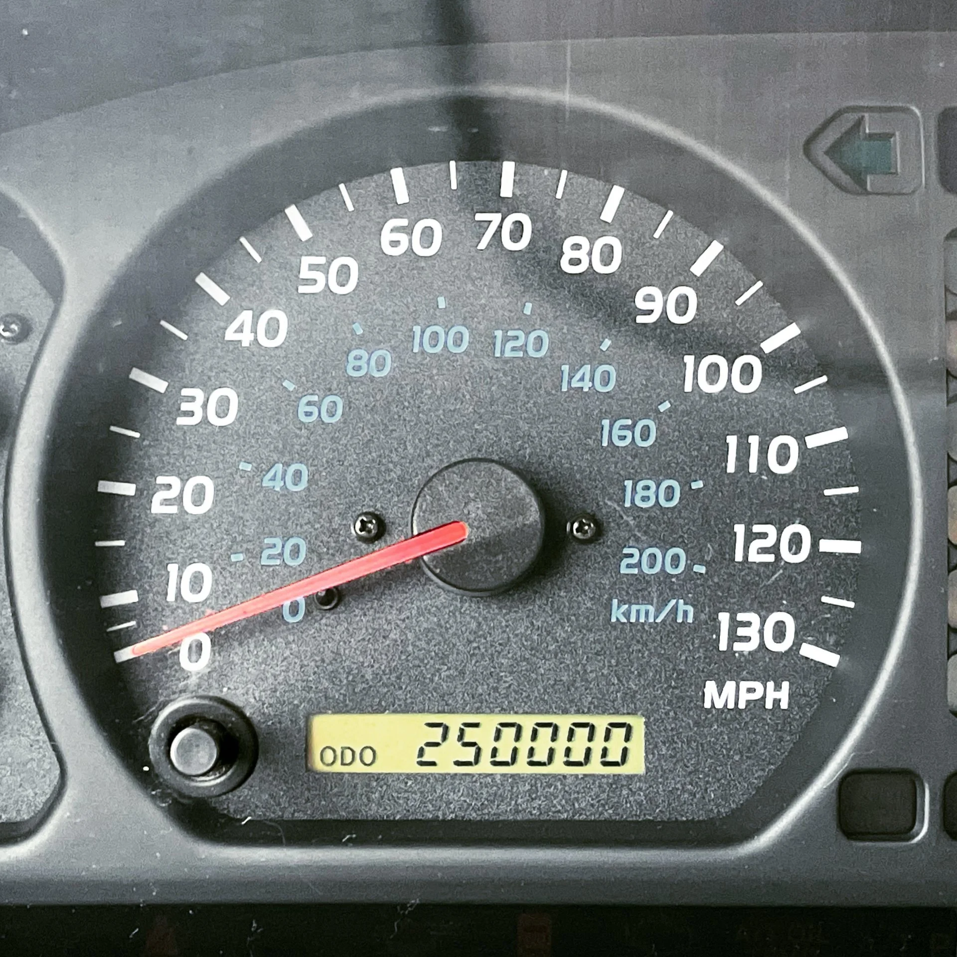

Nothing to report except I just hit 250k

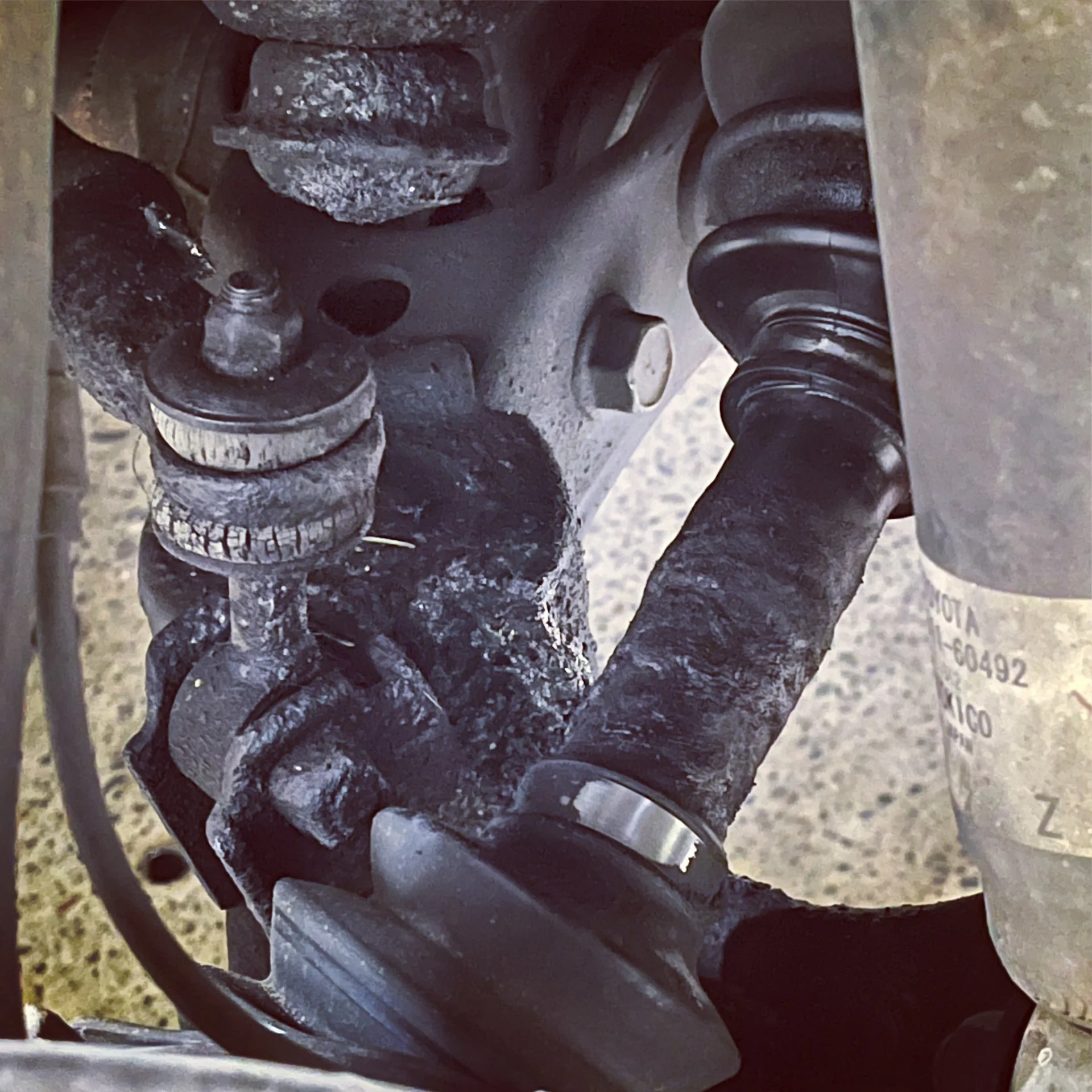

On my own 100 I was tired of looking at much of a rake the truck had. Single fix is to adjust the torsion bars to lift the front and level it out. Did this knowing fully well that it’s not the smartest thing to do without dropping the diff or else the CV axles are at too extreme an angle. My reasoning, at the time, was I didn’t feel like diving into the suspension yet AND I’ll wait til it’s time to do other axle/steering stuff.
Well, I lost because since this is a truck that just sees street use for the shop I figure it wouldn’t be an issue. I lost because the torsion bar adjustment was too much and sure enough the CV boots leaked. On both sides. Ugh.
I wanted more time to work on other stuff but instead I forced a rebuild. Poop. At least I can take care of the ball joints and bushings and end links and and and…

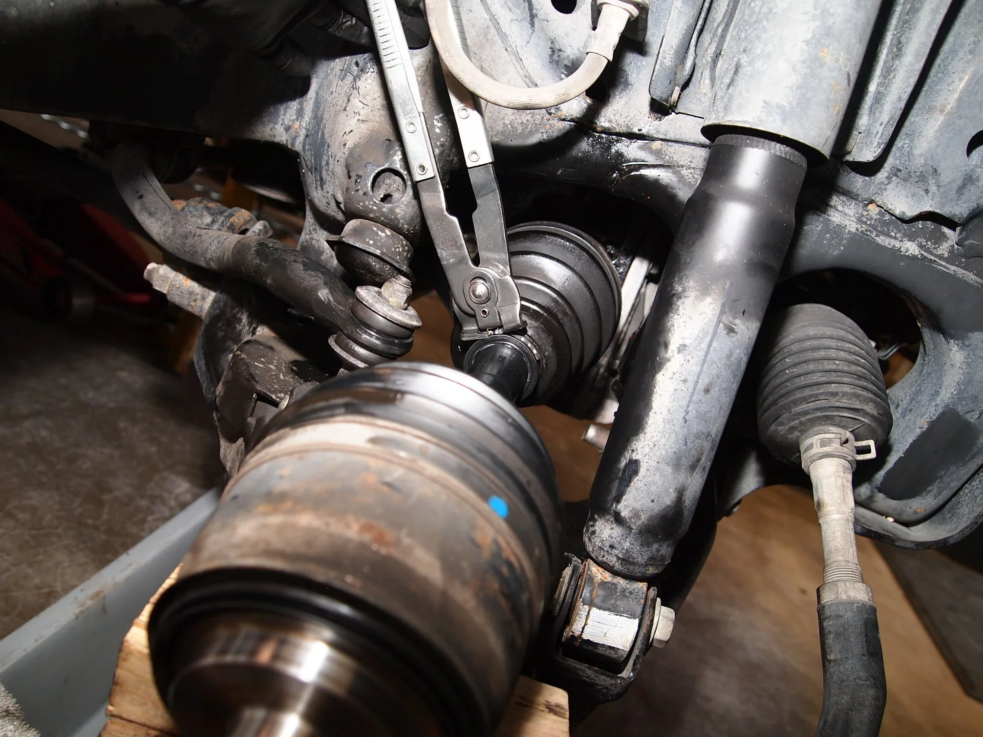

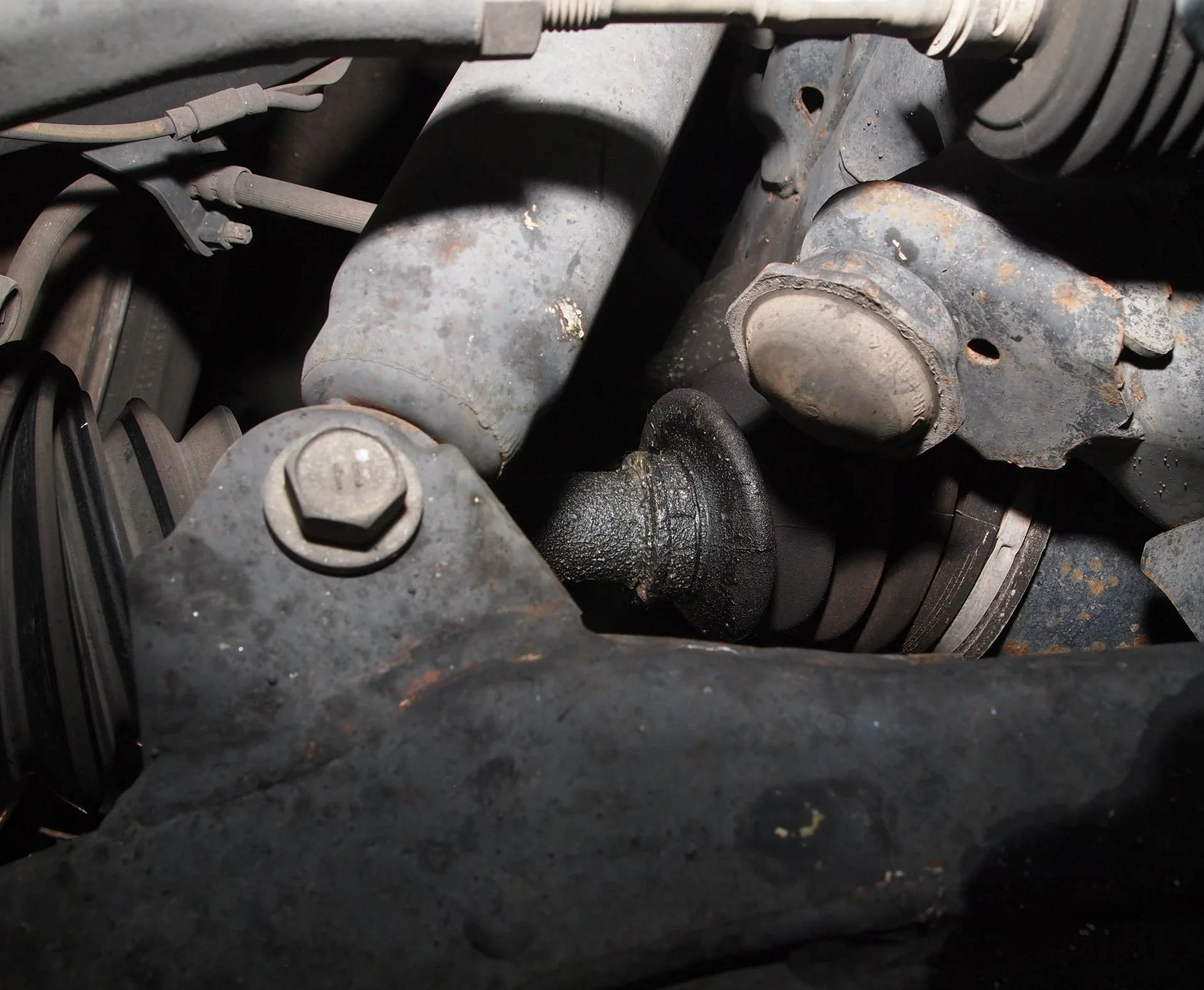

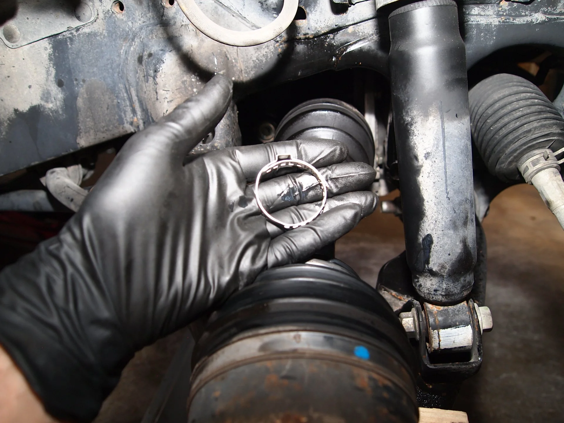

Hi Joey, Nice work!
I find most times these FDS slinging grease, is just weeps from loose clamps. What I find when I look close, is grease (grayish) weeping from between boot and axle from under clamp area. If no rips or holes in the boots. I just re-clamp. NAPA has a large and a small CV clamp. Typically no grease need be added.
That said I've found changing height, even with a diff drop. FDS (front drive shaft) go bad. Reports of this are from 5K to 20K miles after lift. Drop seems to buy extra time.
I do a lot of:
R&R of: FDS, hub flanges, cone washers, diff side seals (your seal install tool works great, THANKS) with knuckle & wheel bearing service and lower ball joints if needed.
If rack & pinon & tie rods, factory and still good. I R&R rack mounting bushing, if I feel HWY wondering in steering and all else as it should be. Along with refresh stabilizer system. They then hug the road in the curves, like day it came from the factory.
Which is all par for 250K miles.

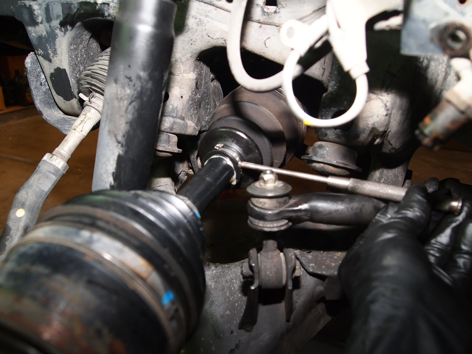

Clip off old clamp and push back boot, to clean axle groove boot seat in.
NAPA small clamp
Clip in band to tightest hole and crimp. Inspect every 5k miles and re-sung as needed.
Tap in tail of clip band for a finished look.
