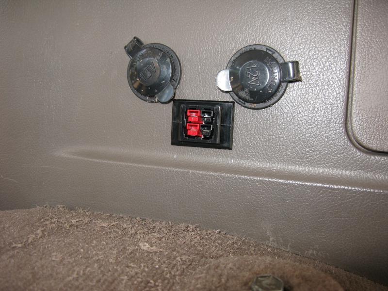

I've been running an ARB for several years now, and I agree that the temp variances are not insignificant, and I also agree about setting the temp lower. I've been running mine at 33 or 35* and it's perfect for keeping beers cold, meat fresh, and veggies crisp without getting anything close to freezing. Use the back shelf for things that don't need as much cold, like yogurt, butter, fruit, etc.
I'll also mention that I gave up on the 12 volt socket plugs after trying several different varieties including the Marinco. The first problem was that I couldn't get a secure enough lock (which I finally solved with the Marinco), but the other, more significant issue was with voltage drops at the plug. I was having trouble with the unit doing a low voltage shutdown when the compressor cycled on, especially in temps > 85*. My battery had > 12v at the terminal, and no measurable voltage loss on the wires to the back of the truck, but when the fridge compressor cycled on, it was dropping below 10.6 IIRC (the low voltage shut down point). I got a recommendation from Christo and some other guys to try out the Anderson plugs - a popular upgrade for the Aussie guys with trailers and travel rigs. Here's what I ended up with:
Removed the male socket plug from the ARB cord and replaced it with an anderson plug.
Voltage has been solid since I made the switch, and even when my aux battery is down around 11V the compressor still fires up and keeps cooling. And the plugs seem to be pretty vibration resistant so far, and they do make pins and links to further secure the plugs if needed.
Just another option to consider.
OK, where did you find the panel mount Anderson socket? I've always just used dangling wires with a connector on the end. Panel mounting would be better.
