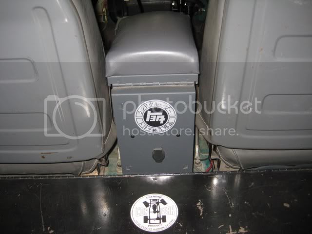

+1 on the Hella socket. Bought them from a Triumph motorcycle dealer. Here is one installed in my Tuffy console:
2,500 mile round trip, 10 days, no socket problems.
Love this thing!
