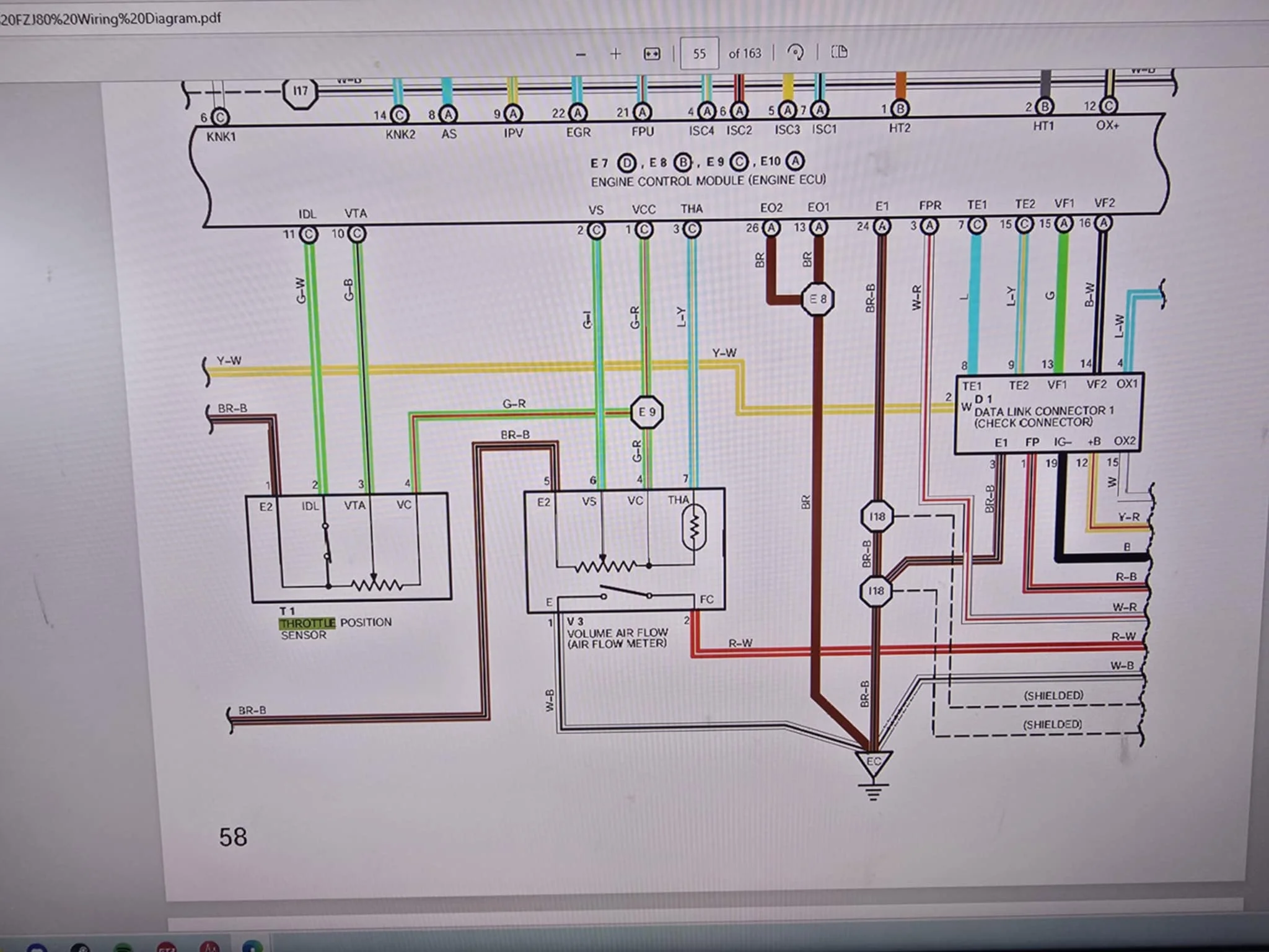

After checking codes, I found I have Diagnostic Trouble Code (DTC) 42 which from research is a problem with the Throttle Position Sensor (TPS).

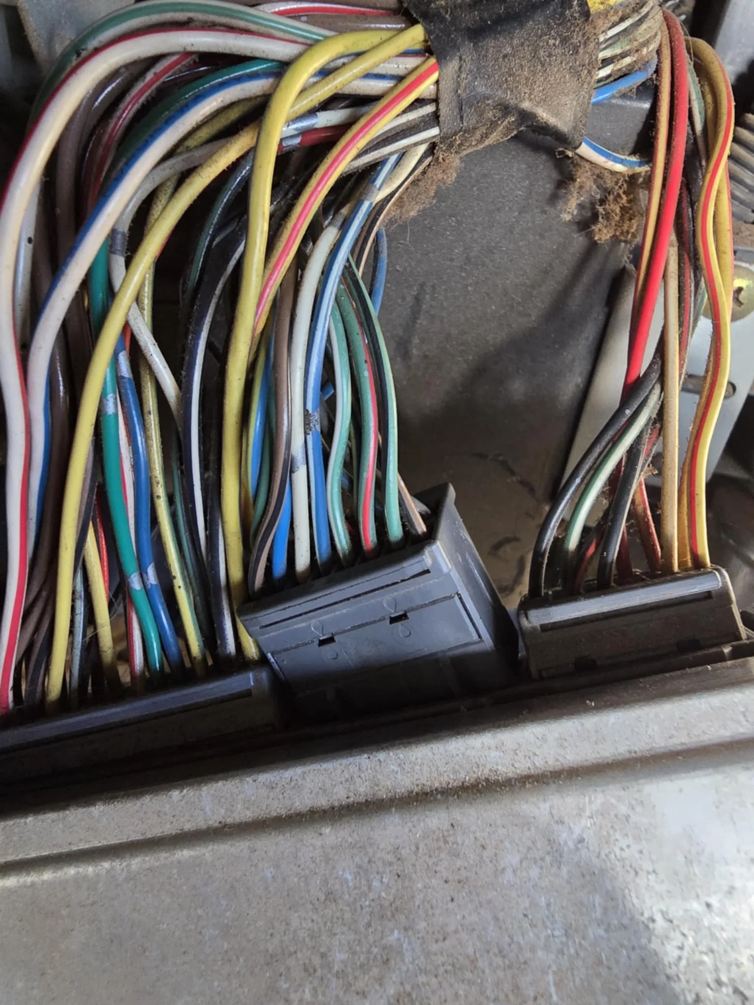

The reason I am chasing a wiring diagram so specific is because the wiring diagram I've been using doesn't seem to be correct as I have found a discrepancy between what the 1994 wiring diagram says and what is on my plug for the ECU. Please refer to the photos attached for what I'm talking about.
So, the middle ECU plug, from right to left starts at pin number 09 and finishes on 16.
Pin 10 (VTA) is a green wire with a black trace (correct as per the photo and wiring diagram)
Pin 11 (IDL) is a green wire with a red trace (incorrect as per the photo and wiring diagram)
Pin 12 is a green wire with a white trace as per the photo.
As you can clearly see, pin 11 is green with a red trace (VC) on the ECU but as per the wiring diagram this is incorrect.
After doing continuity tests, I have confirmed the pins on the TPS are in fact correct and correspond with their colours, however their wiring to the ECU has completely thrown me off.
Thoughts on this? Surely it's something I've missed right?
