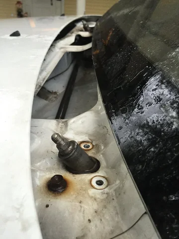

Unbolt the wipers. You need to fully extend and release tension to get them off - again be careful so you don't strip the splines inside. Then work to unbolt the linkage from the body where it mounts (10mm socket, with extension for clearance over hood)

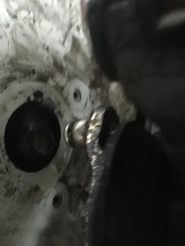

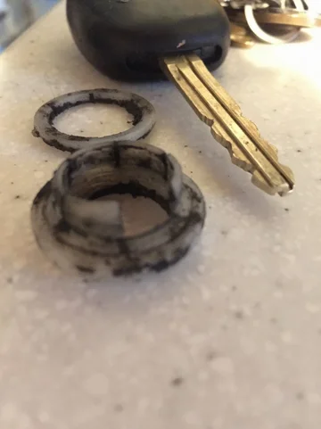

Here is a picture I the failed component. Dorman makes linkage bushings, not sure of the part # though. Will try to take measurements and post back up at a later date.
