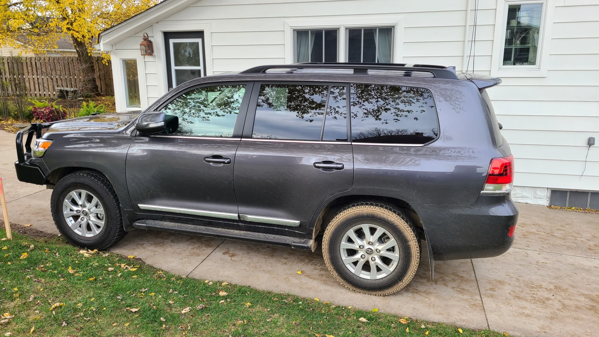

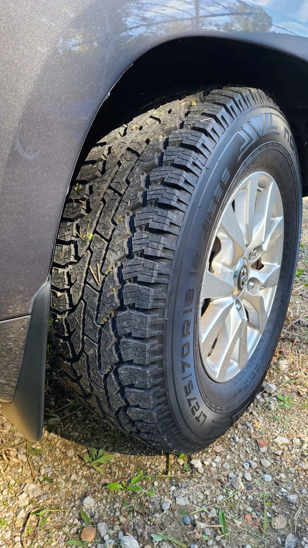

I've had a 3+ hour commute in Michigan for over 30 years, driven it in a lot of blizzards, sometimes over 8-hours to make the run. I've run Blizzaks and Hakkas and a lot of others. Two winters in my 200, running Nokian Rotiiva AT+ 275/70-18, I've never run a better setup in ice and slush at road speeds. I don't know if it the truck or the tires or the combo, but I'm very impressed. I run around 42psi cold, that makes a big difference in traction. My current drive around the bottom of Lake Michigan is dry more than snow all winter, but sometimes I'll hit a blizzard when it was sunny at home. I run these year-round, they are wearing well, much better than dedicated snow tires.
These are "all weather" tires, and AT. They seem to be discontinued, replaced by their Outpost AT tires.

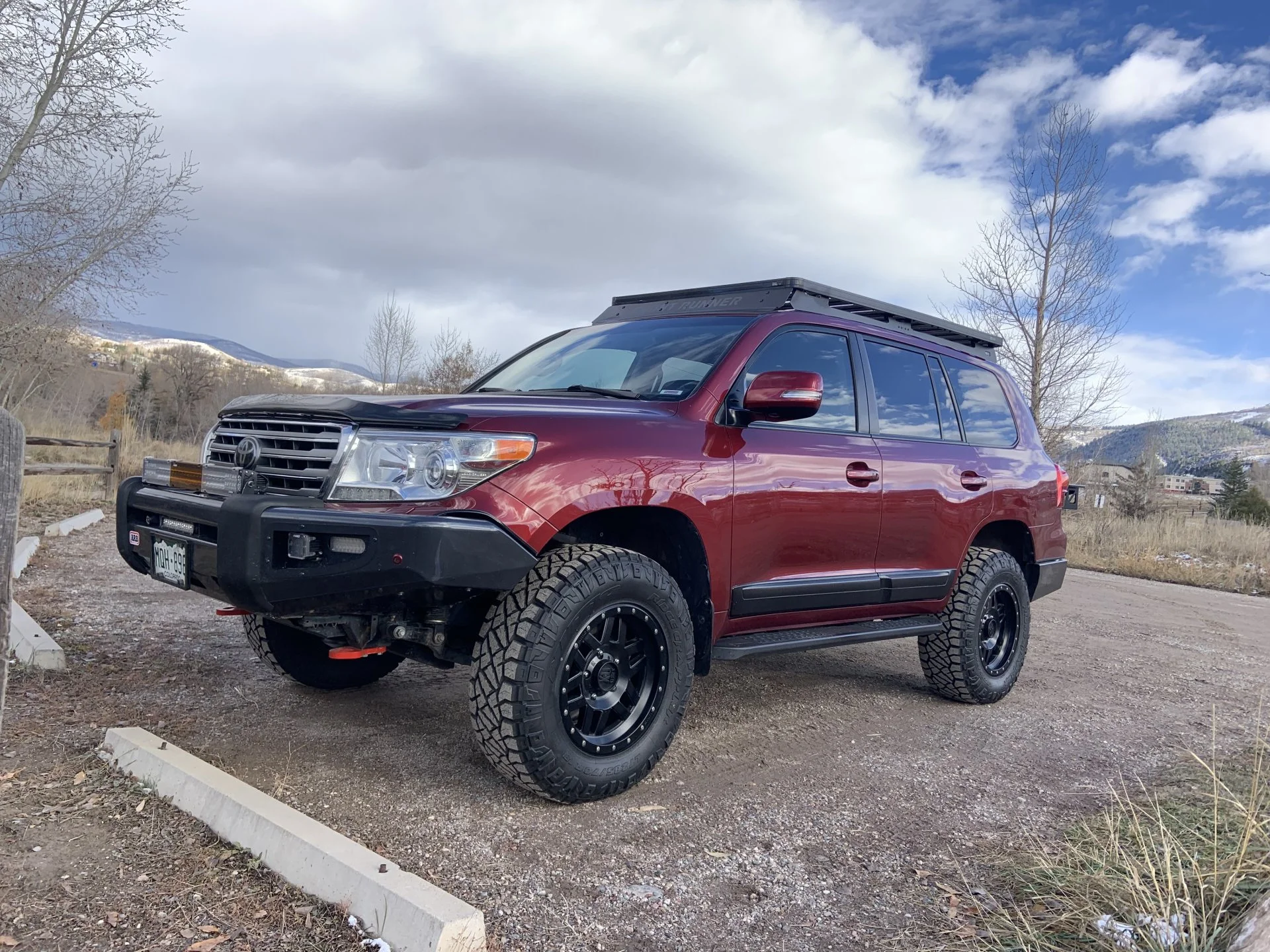

I second this. Can't say enough about the versatility of Nitto RG's. Live in Edwards, CO (Eagle Valley) and besides constant, rugged winter driving in 200" average snowfall I also make frequent winter trips to Denver over the passes on the legendary "bad" I70. I have used Nitto RG's year round for 8 years and they perform great for all the on-road and off-road adventures we do. LC weight is no joke (good and bad) so regardless of the tires they are still a handful on ice. Feel and speed matter most.

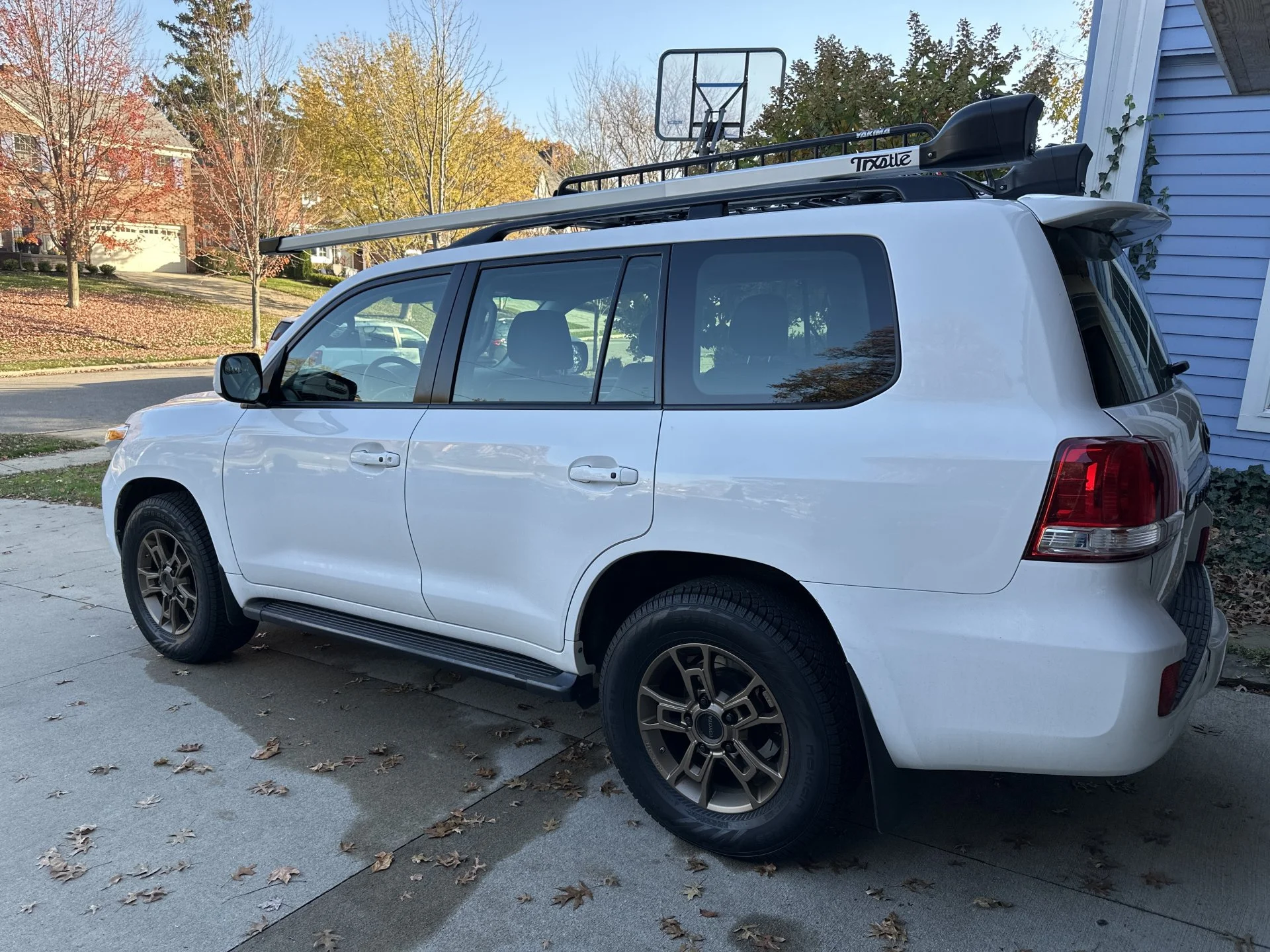

Hakka R5 SUVs thrown on. 275-65-18. Def quieter than the R3 SUVs. Only observation is it seems like the channels are narrower vs the R3 so unsure how it will do with slushplaning/hydroplaning. Maybe a bit more body roll due to the narrower tire.
Did consider beefier ATs but with how cold it can get in CO and some nasty stuff I’ve hit going and coming from Denver on the I70 corridor, I usually go with snows due to their ice and near frozen slush performance.

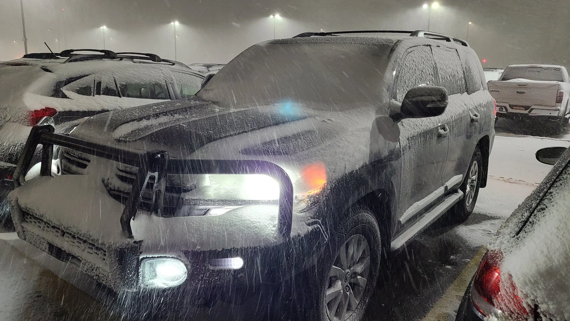

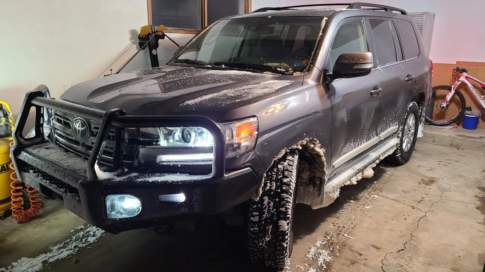

I went 1" narrower and 1" taller. Proper inflation is 42psi min, and definitely no body roll at that pressure, plus these are stiff tires. Some noise, and I run for hours at a time, but not fatiguing kind of noise. Rougher ride at 42psi, wife took notice of that. I air down for long runs with her to about 35psi, it is smooth and a bit more noise from the edge blocks, but again not fatiguing for me or wife. I can feel the truck is less crisp at 35psi, but not wallowy even at highway speeds.
I felt the stock tires at stock pressure were very wallowy and not confident, these taller, stiffer tires feel better at that same pressure, a bit harsh at 42psi and above. Probably shouldn't run them below 42psi, but I've checked and double checked with an infrared thermometer at gas stops on the highway, not noticing the tread getting warm. Wet and snowy runs, I keep them at 42psi+, and they are incredible in the snow and slush on the highway.
