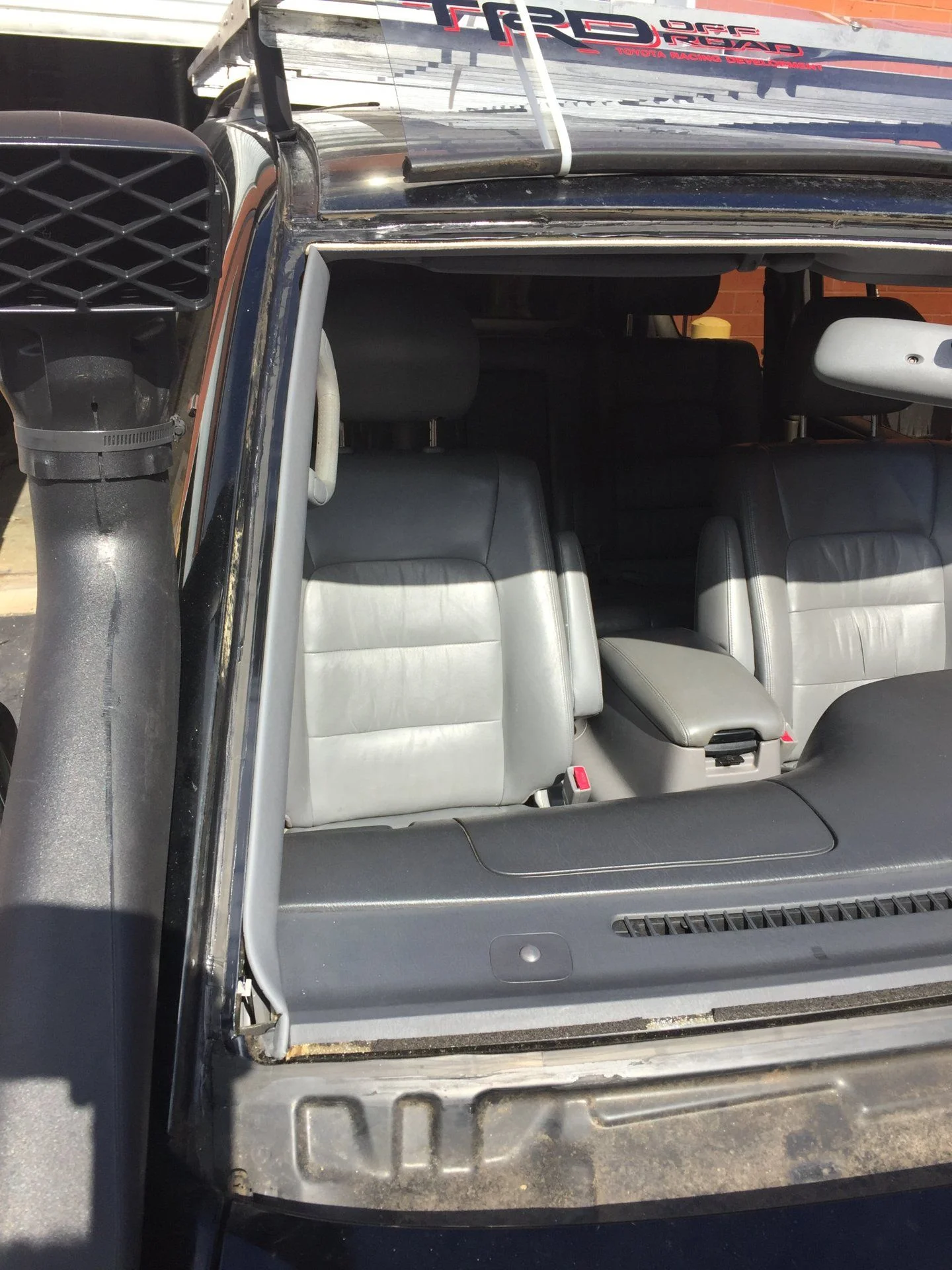

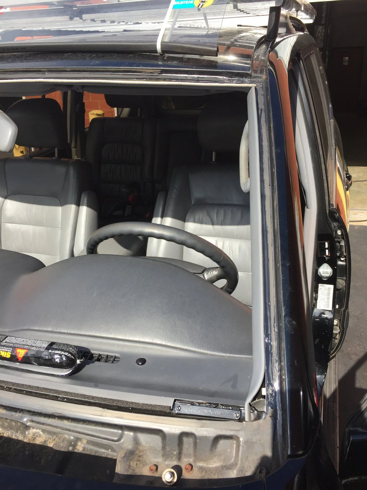

View attachment 1572591 View attachment 1572592 Zoom in and inspect the rivets on the post!
I see some signs of rust on heads of wiper arm mount bolts. But none around windshield area. I'm very interested in the history of your 100, I assume is a 99LC w/117K.
What area of the country has it spent any meaningfull (6 months or more) time in?
Number one was this the first time your windshield was replaced? Any sign of rust under windshield?
If this was not first replacement was any paint or coatings previously used on body metal under windshield that you know of or looks like ?
I ask because there is a debate whether our factory installed windshield area rust due to design issues, or only after a subsequent install.

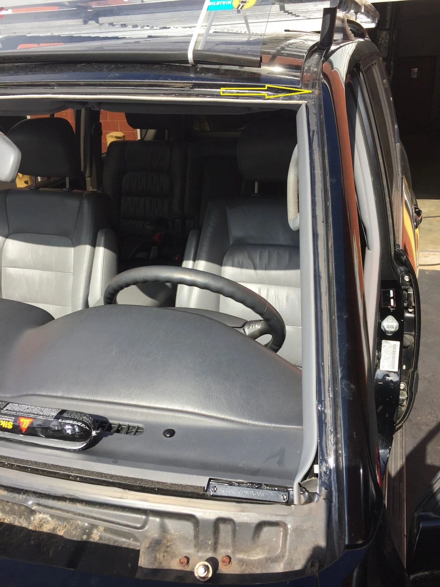

I see something in corner. I can't tell if it's just dirt or is paint worn off?

Good eye, there was a small spot of surface rust on that corner and on one of the lower corners as well. This truck was buried under 14" of pine straw and dirt for eight years from sitting under a forest of pine trees. That is why I figured the windshield had those two ares. Truck is a true southern Atlanta truck with all dealer records up until it was parked.
On the good side the interior is mint, the downside is the paint on the top of the truck is trashed....

So was glass in when you bought Lexus (again assuming) windshield glass?
I see some paint or urethane (overage) along top roof line where molding would cover. This is a second clue that makes me think it's not the factory install. But really I can't zoom in with this low res picture. I also have never pulled a factory install, so don't know if factory would have that "overage".
