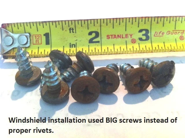

Because 9 out 10 of them will be just exactly as they described. Installed incorrectly, screws instead of rivets, poor attention to detail and installation...resulting in rust behind the windshield, especially at the pinchweld. They have other, easier, more profitable vehicles to work on where they don't have to give the 'bad news' to the owners. That's why.
Here are the screws that came off mine when I had mine replaced. And yes....I had rust behind the windshield that had to be repaired. My truck is Texas truck all its life and even garaged for most of that time. Still.....a poor installation is nothing but a headache somewhere down the line.
Look at these damn things. You could use them on gate hinge!

Same for me. Had to drive 40 miles one way to get mine done. They were aghast at the screws and kept them for me to see.
Wow! That's ugly!

It's pretty easy to check. The side moldings have a little rubber strip that covers the rivets (or screws). The screws have thicker heads and will show a big-ass dimple under the rubber strip. The factory rivets will be nearly invisible. If you see big bumps, you've got screws. You can also just peel back that strip (it's only held in by friction) and reveal the fasteners used.
