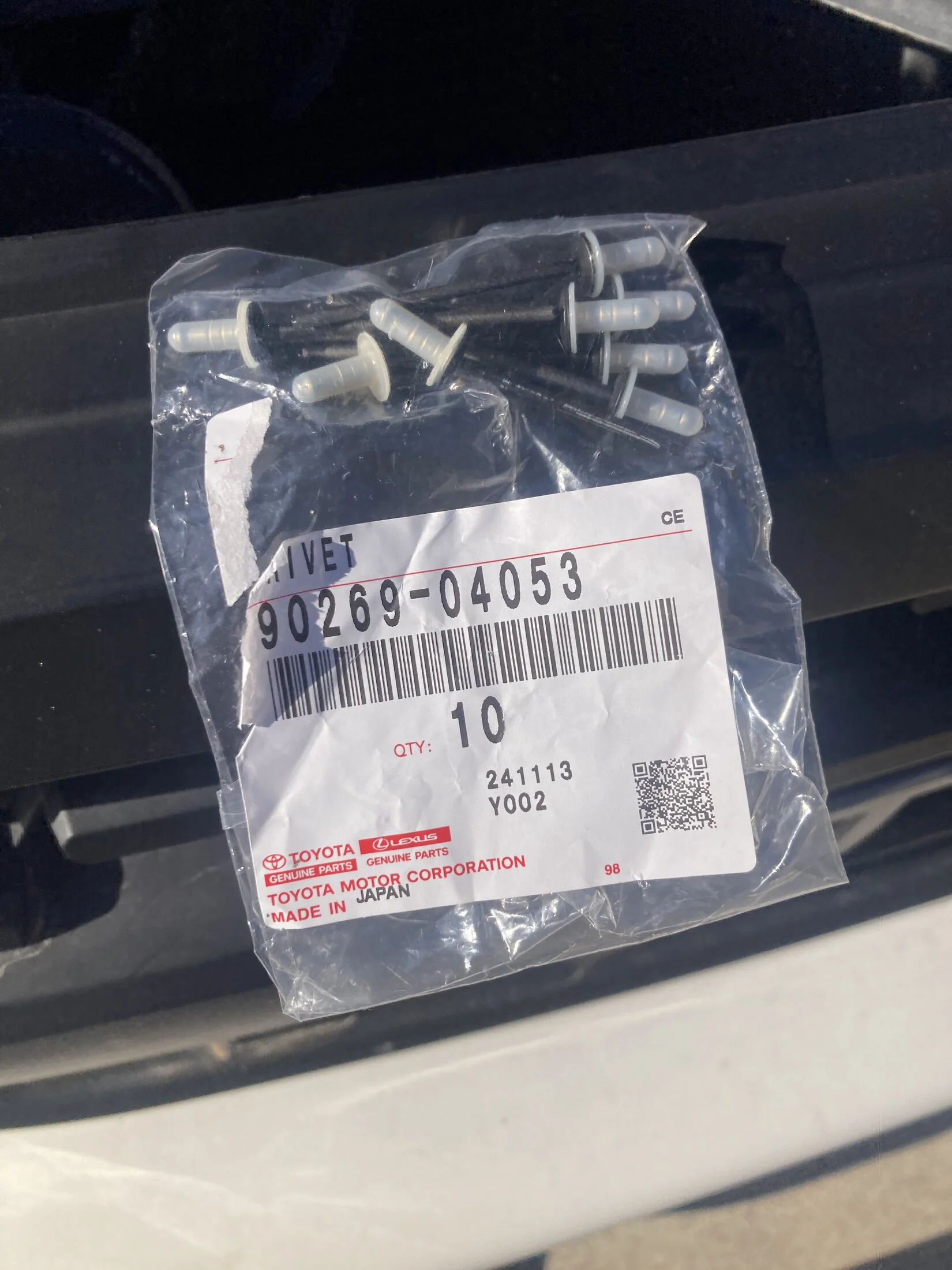

Sounds like we may have had the same tech. He was talking about how he had just done a 100 and I said was it white and he said yes. He was good an knew his stuff. Unfortunately had 3 of the rivets not seat properly on the passenger side. Hope this is more to do with installation error and not an issue with the holes. I have two more OEM rivets so while its under warranty I am going to get them to come back out. Although I am debating on just doing them myself so I can drill them out and not worry about damage. Wonder if I can use a slightly larger plastic rivet for the other one. Need to research. Either way its great to have a windshield again and thank you for the recommendation. Hopefully mine will be on the road soon and I will see you out.
Nice! Glad that worked out. I was wondering myself about the rivet being potentially undersized. The previous windshield replacement with a previous owner had the moulding glued down instead of riveted, so I had no idea what they would find behind them when they pulled the old ones off. Luckily mine were fine, but I had saved this post listing a number for an oversized rivet just in case I needed to do the same:
Thanks @aging fleet. I found 90269-04053 in a thread - maybe the thread you're looking for. The over-sized rivet mentioned in that thread is 90269-05034. I guess the thing to do is buy both - if those are the correct over-sized rivets. Any idea how many are needed? Toyota sells them individually.

By the way, I would need to find where I put them a few weeks back, but I had bought extra rivets just in case any broke during installation, if you would happen to need any.
Mine is RiverRock Green. Still need to decide on tires and install rack and diff drop and then I can finally drive it around.
If you did have an extra I would gladly buy one off you. I know there are three that are pulled away and I ordered only two extra.

Thank you for that thread. I went ahead and ordered the oversize ones just to have some on hand if needed.
Finally was able to slow down to look for them - I’ve got 8 more left, you’re welcome to any you’d like!

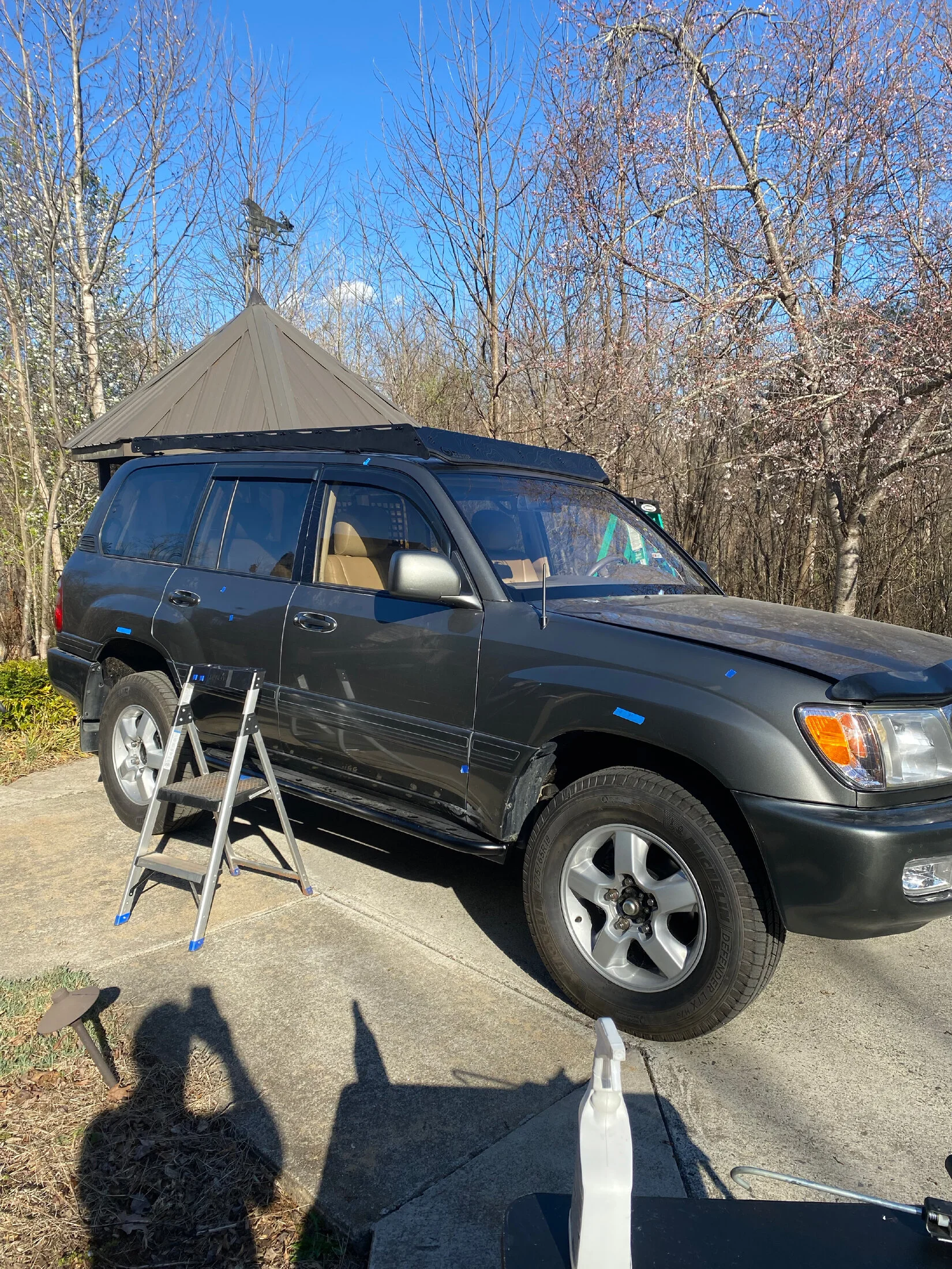

I appreciate the offer of rivets.. I knee-jerk panicked and got some more. I am trying to decide if I do the drilling of the old ones myself and probably just get a rivet gun to install myself too. I am so worried about them nicking paint when they do it and at least if I do it I can pay attention and add paint. Got to do touch ups anyway.. hence all the blue painters tape haha
