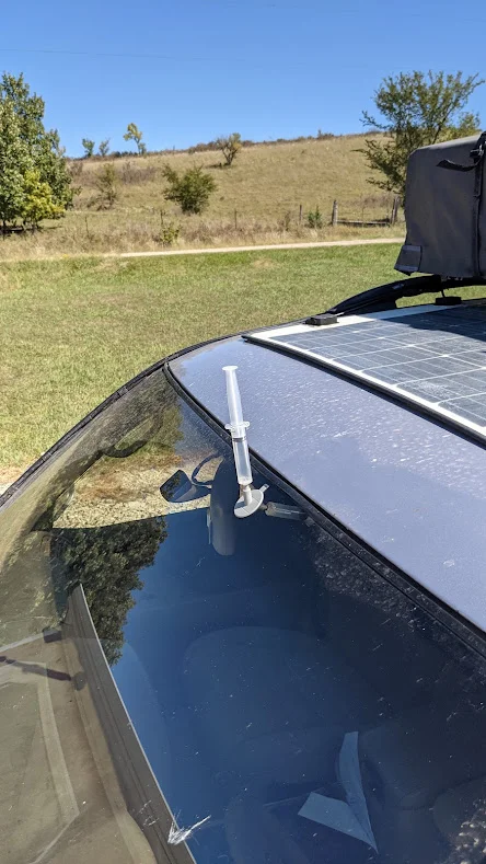

You can then get those $5 windshield kit. Also get a UV light to cure the glue/filler. Follow the instructions and it is easy. I messed up my first repair but now a kind of a pro in this! Vacuume and vacuum to remove air (use the syringe provided): Wear goggles as sometimes when you force the glue to go into the cracks, it can spray out!

I repaired my glass with one of the cheap single use kits and it’s been fine for 6 months through high heat. Not as perfect as unchipped glass, but it stopped the chip from running and no one would notice if they didn’t know.
