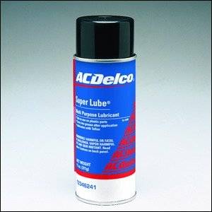

I use this:
Most GM dealerships keep it in stock.
