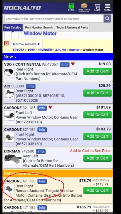

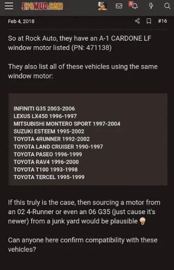

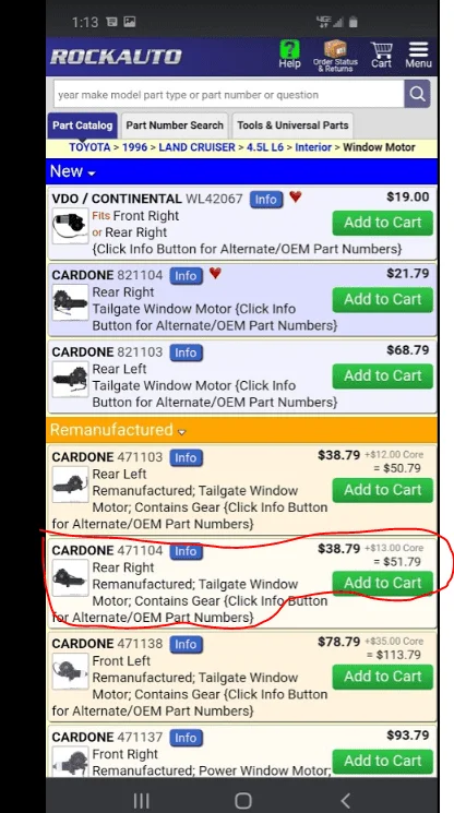

If you go to Rockauto and punch up our vehicle, you'll see the new and remanned motor options. What's cool is that you can also open up other vehicles and open up their window motor offering. I'm including a pic of a thread that discussed all the various vehicles that are compatible with our 80 series. I was at the U pull n pay last weekend and pulled up all the vehicles that use the same motor as the driver front window then proceeded to pull out their motors.

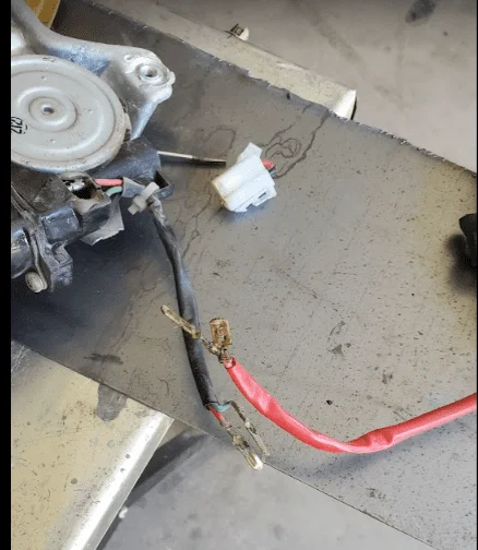

I pulled a right rear from a '99 4runner and a '04 Montero Sport. At home, I tried de-pinning & re-pinning into the Toyota harness but that didn't work out so I cut/butt spliced wires as needed. Incidentally, both the Mitsubishi and the 80 have identical wire colors but I had to wire them opposite, go figure.
