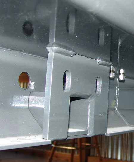

OK, here is my take on it. The receiver is welded to into the bumper, and on the back of it, there is a plate that bolts to the crossmember. (Picture attached).
I do believe that it is pretty strong, but to say that one can winch of it, I can not. Just now someone hooks a 16.5k lb winch to it and tripple line it and pulls the bumper right of the frame. Who's fault is that? Probably mine since I said you can winch of it. :D
That said, I am also not in favor of receiver winches.
1. They require an elaborate mounting system to make them as strong as a fixed mount winch when pulling sideways.
2. All your pulling is concentrated on one 5/8" receiver pin.
3. Storage of winch when not in use. Hard to do it safe inside the vehicle.
4. Electrical quick connects are not as good as proper connections.
5. Loss of approach and departure angle in most cases.
6. It is never installed when you need it.
I feel that it is important to you to have a winch on the rear of the vehicle, then install one behind the bumper in the rear and have it come through the bumper. If cost is an issue, I would rather have 2 x 8000lb winches, one on each end, than one big winch mounted in a cradle.
