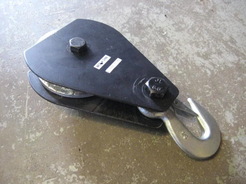

The snatch block is very cheap...$10 at HarborFreight (china and cheap) I wanted an aluminum roller ...my thinking is that I want the roller to wear before the cable does...at least it made sence at the time :)

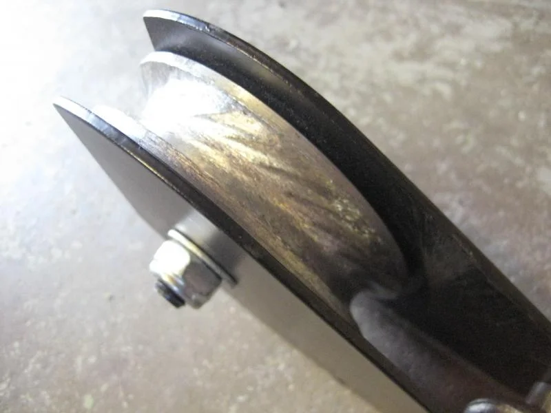

As you can see the roller does wear-in ...i have used the zip line several times already...6X maybe...and thats non-stop use for several hrs of fun.
No damage on my winch line...actually...you can see the aluminum particals inbedded into the twine'd steel cable...i do regularly spray the cable when i do landscaping.

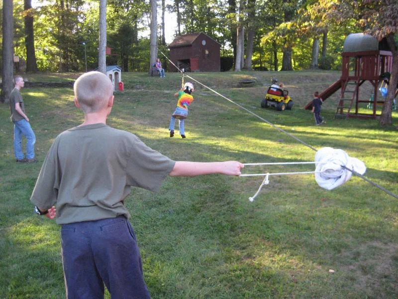

The distance that I use is about 80-85 feet from roller fairlead to tree...i have a mini hill in our back yard that makes it easy to get good speed ...its just one step up on a chair to the zip line 'seat'

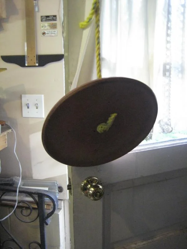

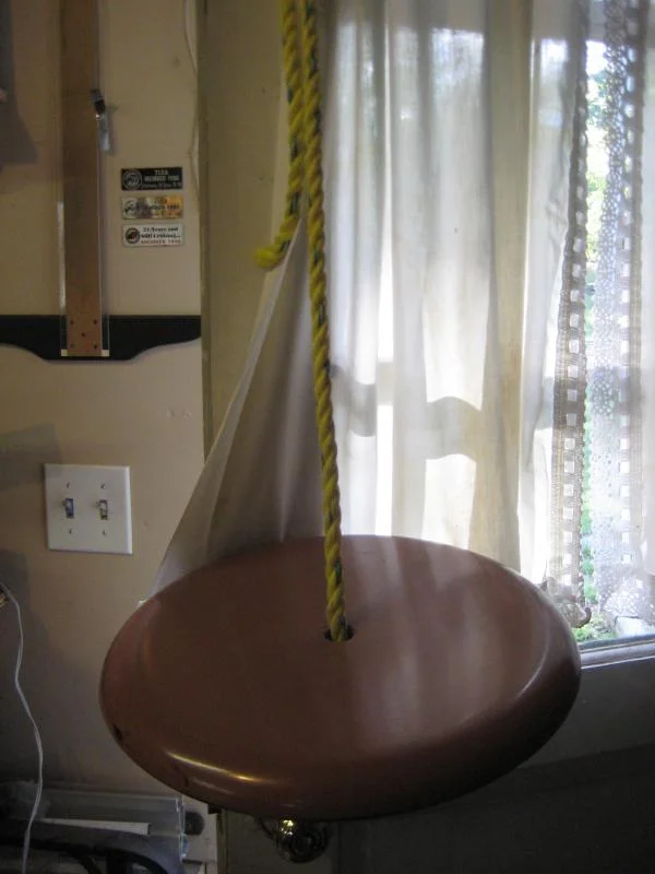

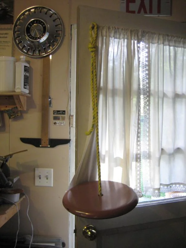

I made a simple seat from an old school stool...you hold the rope and away you go...

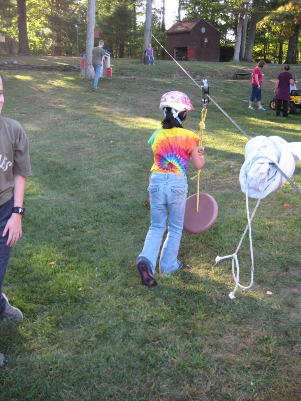

at the end we have a towel raped around the cable and tied with a knot that gets tighter when pulled...the 'brake' as well call it did not budge...
I had one of our young marines guarding the bottom and giving reminders to put feet down to stop...if you hit the 'brake' hard it gives you a big jolt :D
my daughter just finishing and going for another run...she's a bit of a kamikaze...she tries to let go at the end and go for a tumble...good thing the 'brake' is a safe distance from the winch.
