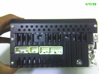

Hmm, just looked up the pics on your install (the detailed ones of the connections. I wish I took a pic of the back of the stock FJC radio. I cant remember if it had three or four connections in the back. There were ones on the back right side (the antenna, and a second one), I remember those. I guess I will have to tear the radio out after my head work. Oh well. Thanks for the help guys. I just wish I could find a pic of the back of the stock FJC radio. Cant seem to find one.

Found a pic
attachment.php
Wish I could get a closer one, but thats the rear of my radio. Same connections as the FJammer? I found on this thread someone saying the 20pin (far left) is for the steering wheel, AUX. The 12 pin is for CD changer, nav, etc.
https://forum.ih8mud.com/80-series-tech/218820-fj-cruiser-radio-installed.html
Doesnt look like the connector i originally posted will work. Dang. I will ask the dealer for more possibilities when I get there again.
