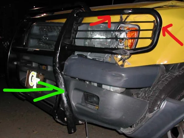

My thought on the "damage multiplier" brush bars are that they're a huge lever that's pinned at the very bottom. Any force applied along the entire length of it just pushes the whole thing into the car - even touching panels well away from it's anchor. Hence, damage multiplier.

The concern here is all small impact stuff. For the hard impacts, I'm not sure the brush guard multiplies anything. A good off-road "armor" bumper might help even out the impact zone quite a bit and reduce cabin intrusion.
Example of a damage multiplier. Impact near green, damage spread out to the red. Without the brush guard, perhaps the hood may have survived. Hard to say. It's all a minor issue, imo. Don't crash your car and carry a thick wallet or good insurance.
