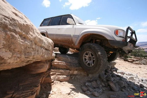

... On the other hand, if you're planning on just having big tires to show off on the driveway, go for it.
I even found a driveway to show off in!:flipoff2::p
