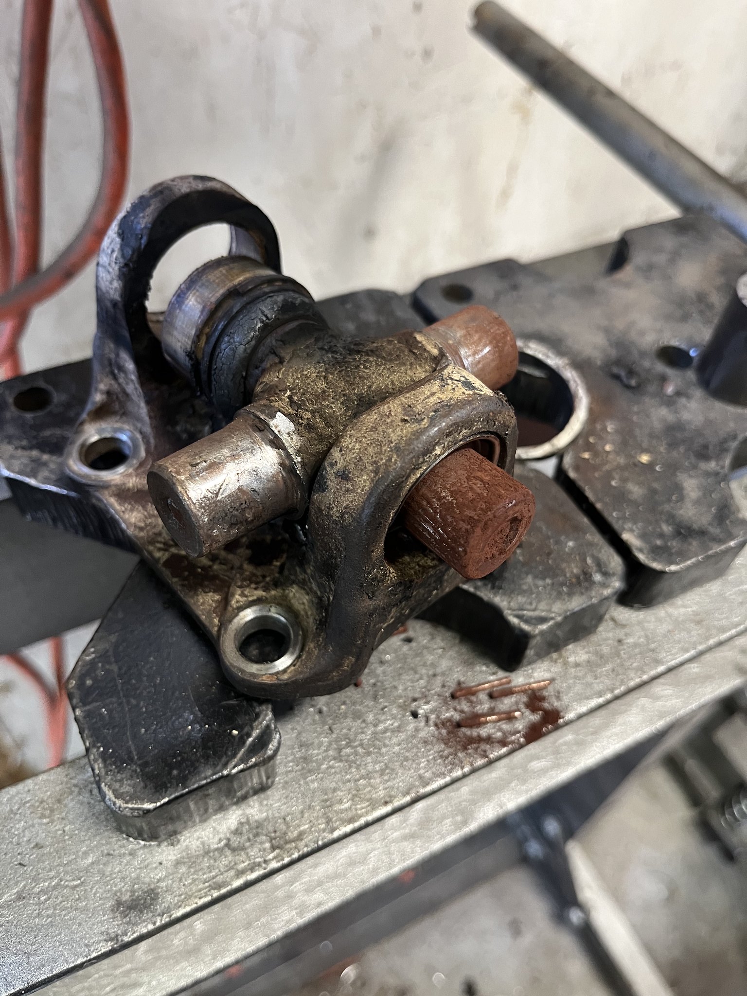

Got all the new U joints in today and it made a HUGE difference. I think I'm going to skip the alignment, but still get the tires balanced. No more vibration at all.
The old U joints were BAD! Filled with rust and found multiple cracked bearing caps.
Untitled by Jeremy Nugent, on Flickr

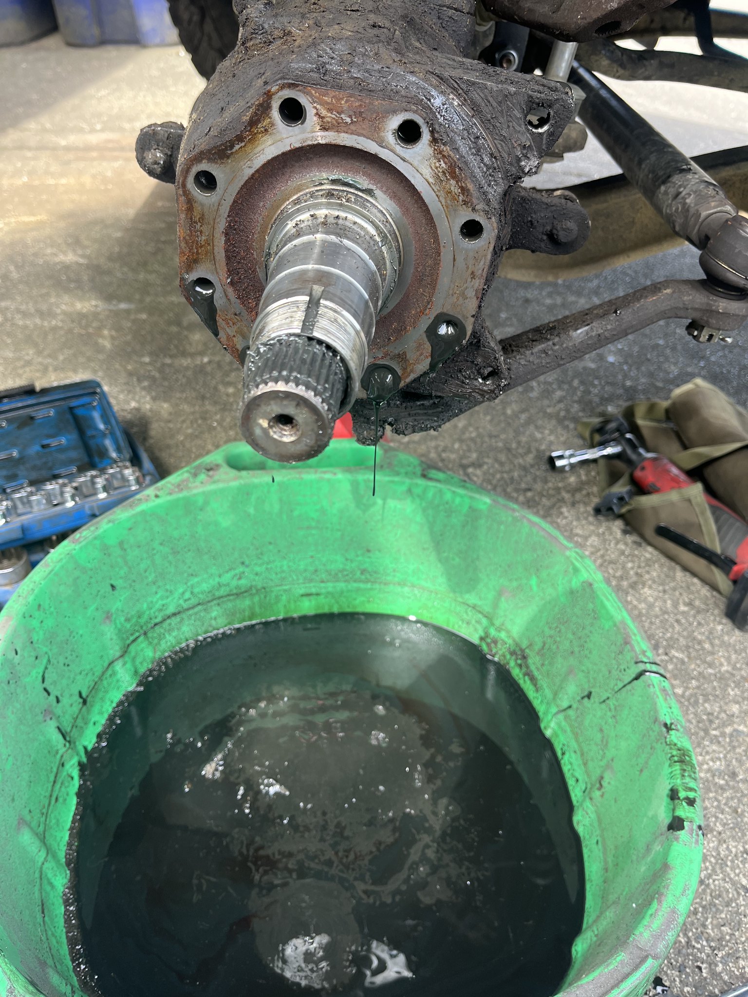

Spent the weekend rebuilding the front axle knuckles. They were baaaad. Another piece of maintenance work that has made a huge difference in ride quality.
Took everything apart, power washed it, and scrubbed it, and put it back together with a parts kit from Trail Gear. Good kit.
