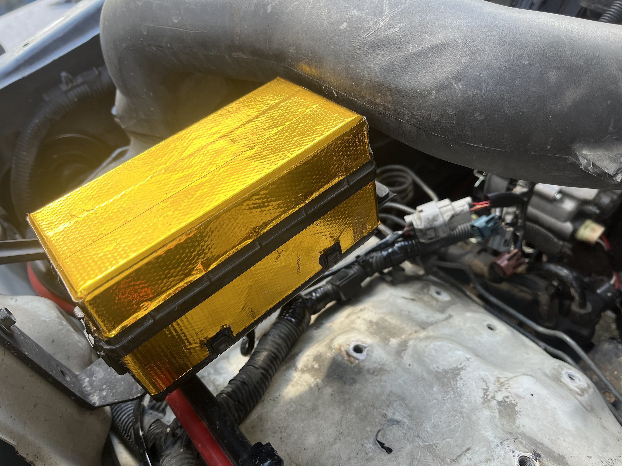

Moved the engine bay fuse box farther away from the exhaust with a custom bracket and wrapped it in gold heat reflective tape, cleaned all contacts, no more starting issues

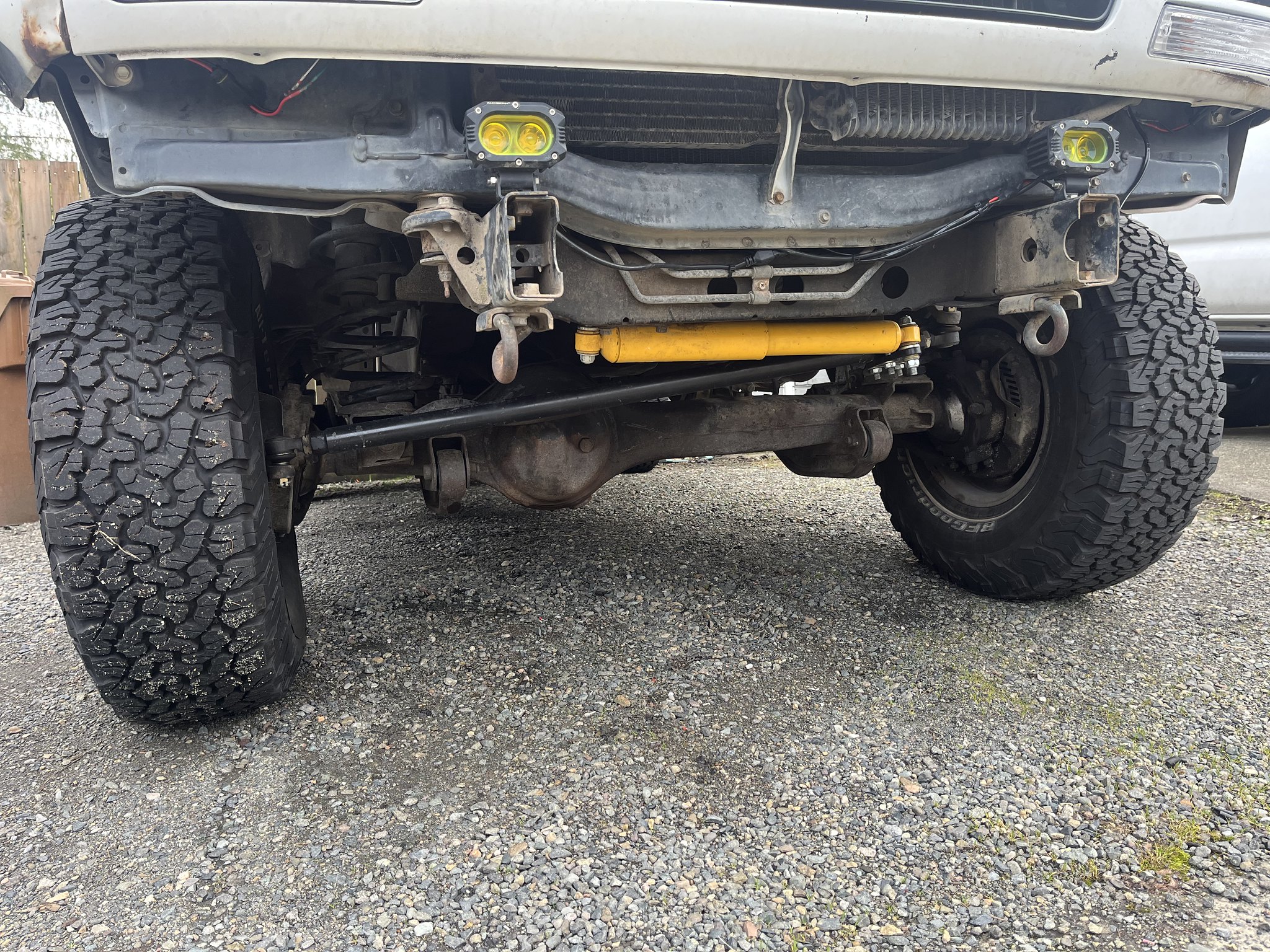

ICON stage 1 3" lift kit
New urethane bushings everywhere
Delta panhard lift bracket (this made a surprising amount of difference in handling!)
Steering:

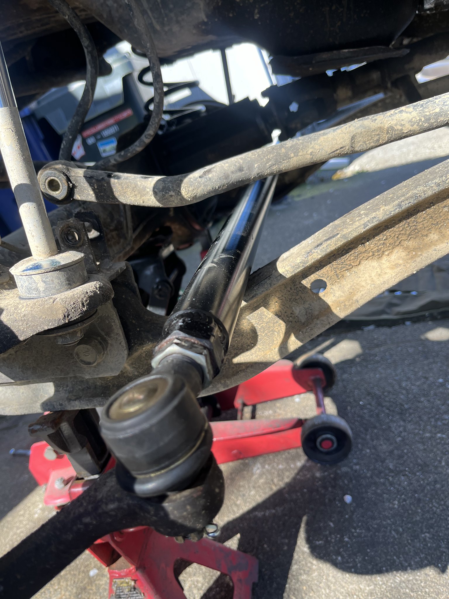

I TIG welded new steering links with DOM tube (steering wheel now stays center)

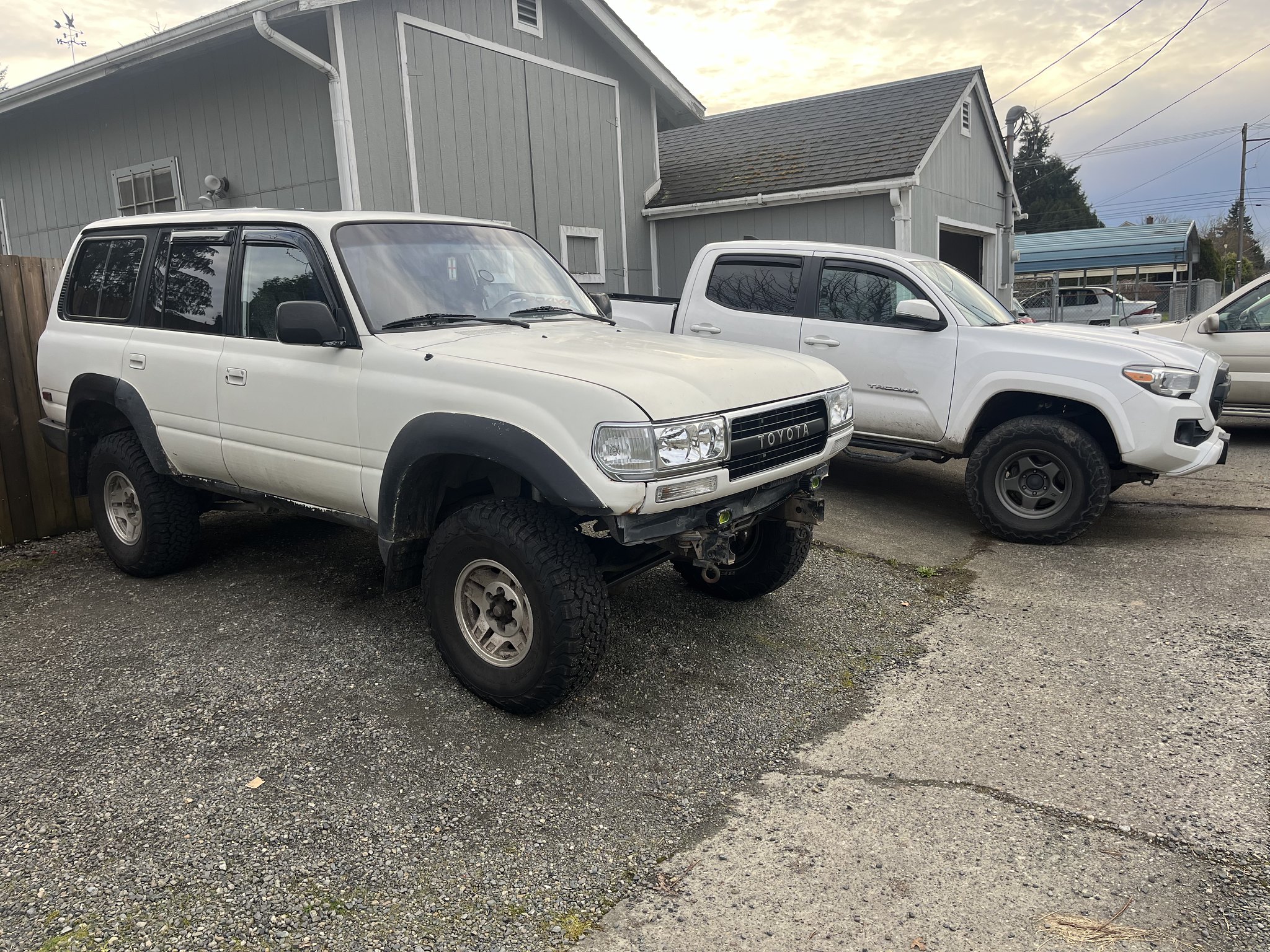

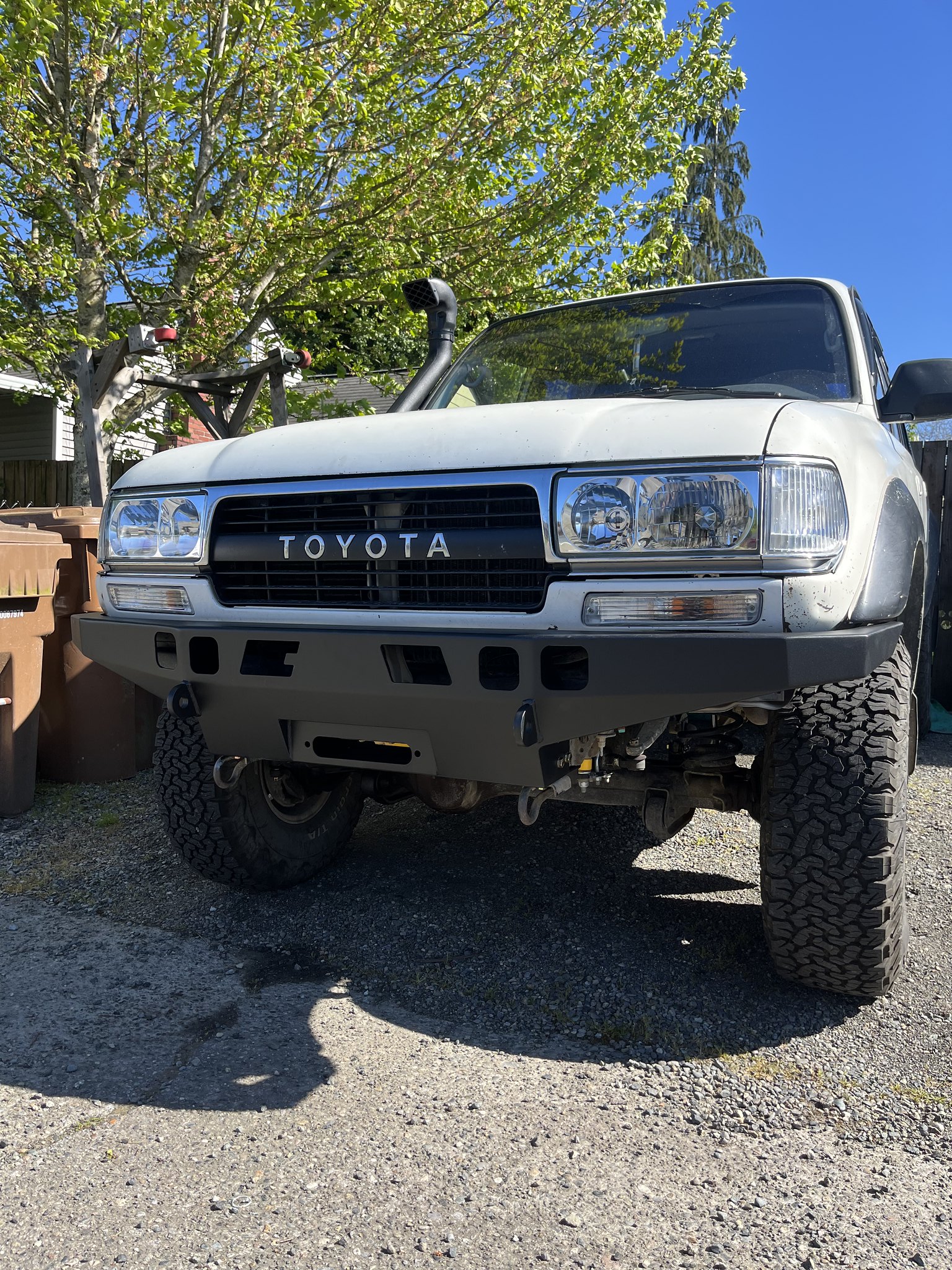

This is how the car sits now.
Untitled by Jeremy Nugent, on Flickr

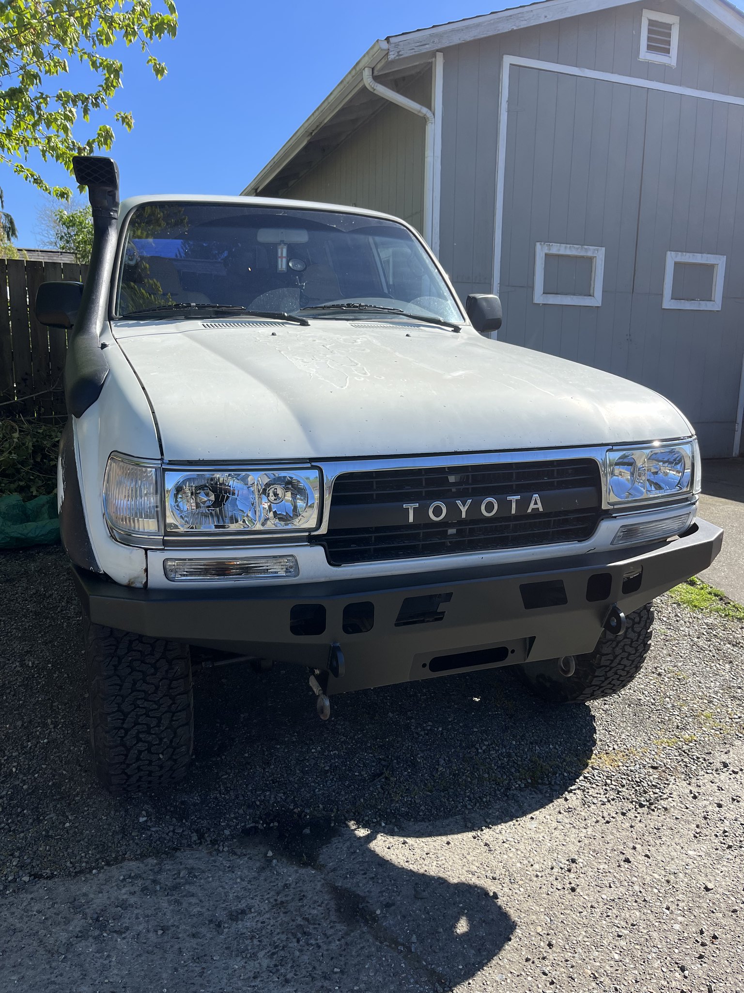

Plans for this year are to get some bumpers on, and prep the truck for some overland trips. New seats are a must. I have a bad back and the driver seat is missing a lot of foam on the left which makes me sore. Maybe build some drawers for the back, and get a tent mounted up. We have driven most of the WBDR in my Tacoma, and have learned A LOT about what we need to bring and what is not necessary.
I also want to keep improving the look of the 80. Maybe a bed liner paint job as the paint is totally shot. I need to rebuild the axles too, the front axles are leaking.
Next year I want to do new wheels and some 35" KO3s with gears and lockers. Some Rock Jock sway bars are also in the works eventually. I'm also planning an LS swap down the road.

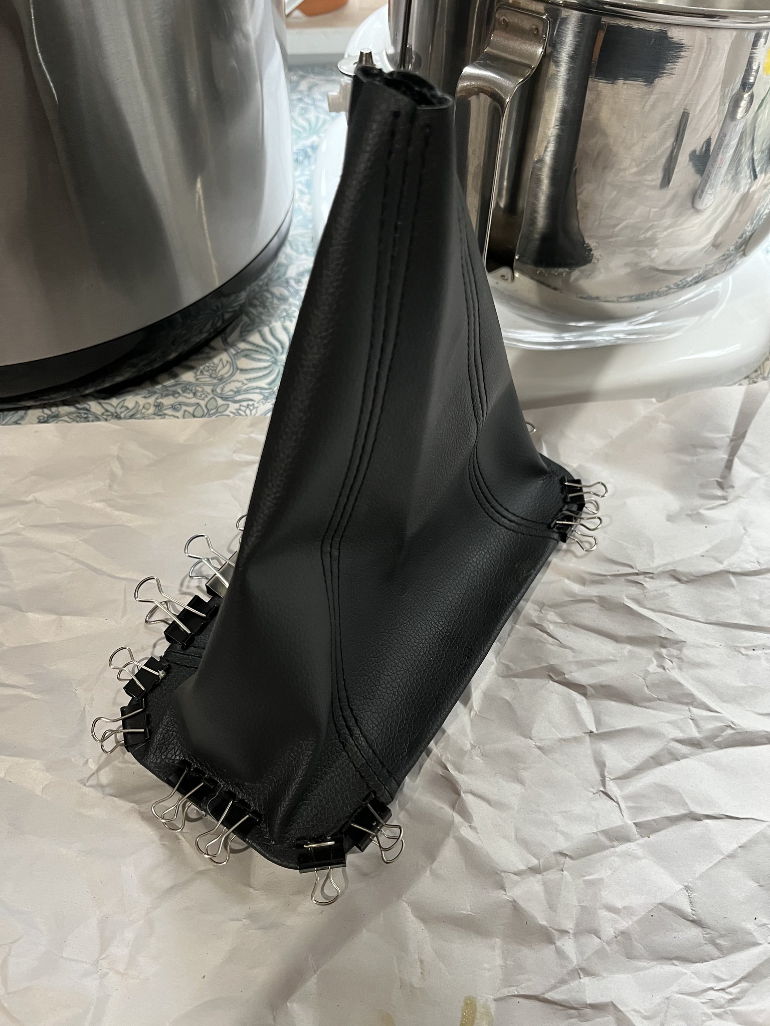

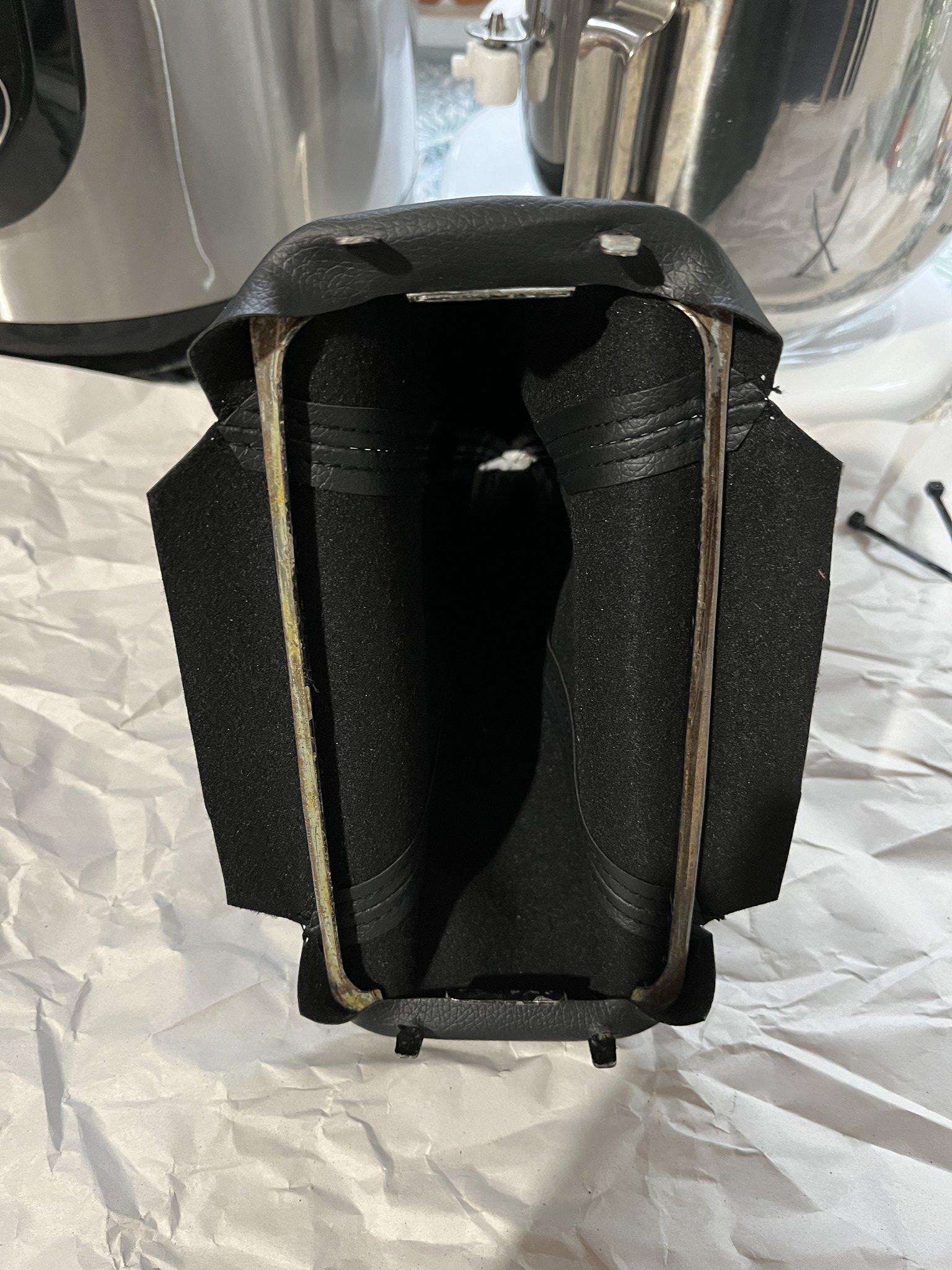

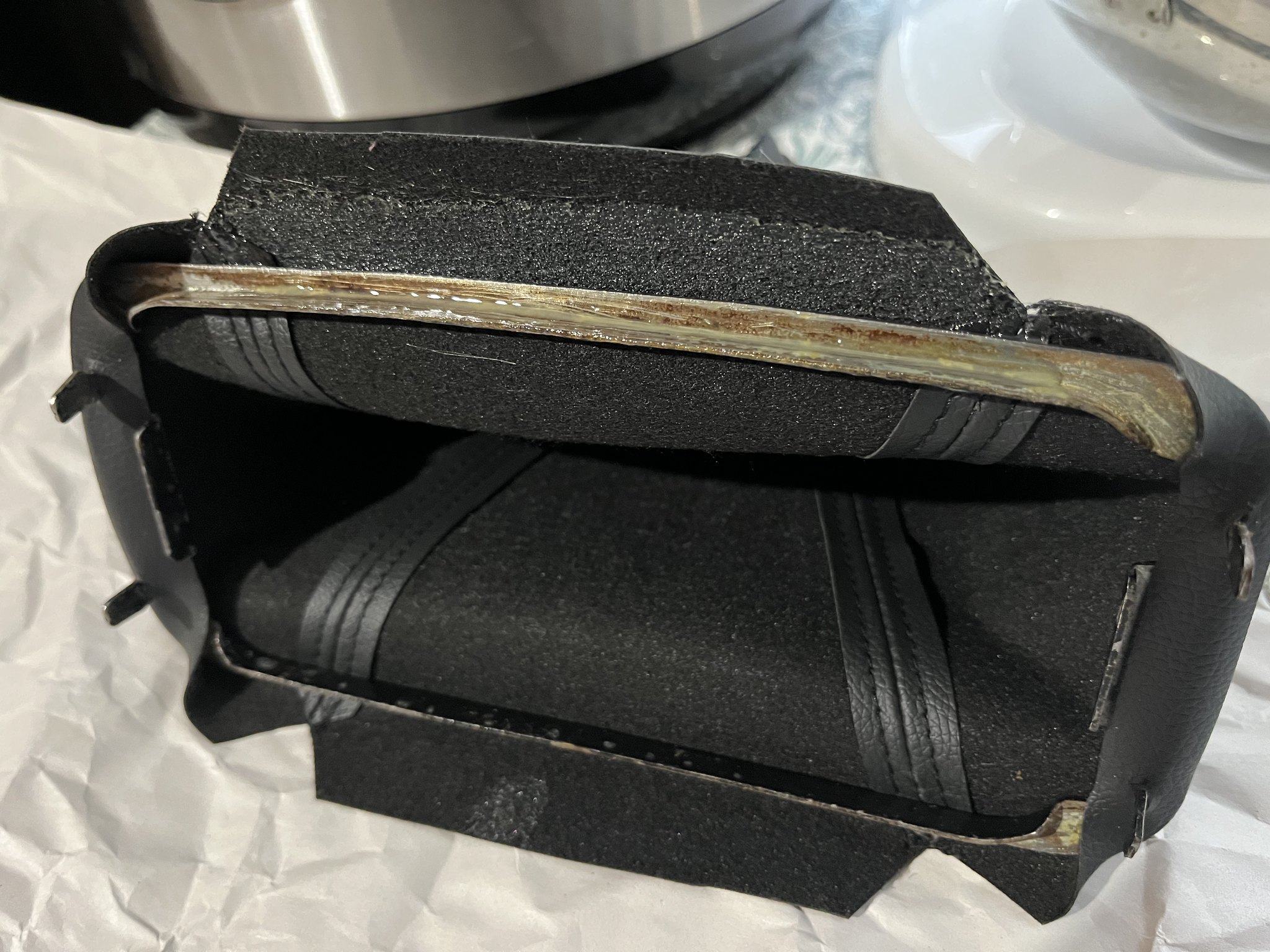

Today I re-did the shifter boot for the transfer case shifter. I dicked it up the first time, because I'm impatient and kinda slow some times. To quote Dr. Pooh, "for I am a bear of very little brain, and long words bother me."

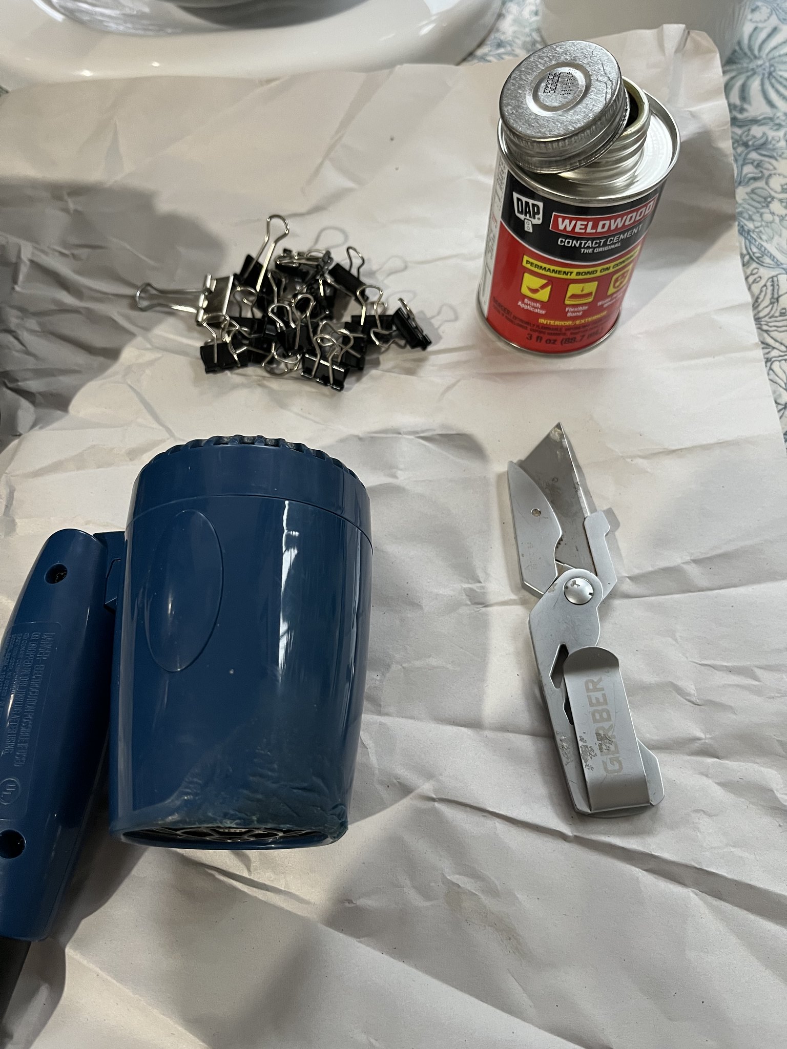

Here is a quick "How To" with a link to the boot on Amazon, and things you will need.
Shift boot. This thing fits perfectly on the LC80 metal shifter boot frame and its only $11. Its not real leather but it looks good and the stitching isn't bad. I wasn't able to find a Toyota boot for less than $100.
Tools you will need:
Hair dryer that you will need to use while your wife is gone (I already melted my wife's travel unit while trying to start some BBQ charcoal more quickly, so I don't think it matters if I get some glue on it)
A bottle of contact adhesive (this stuff stays a bit flexible and is used often in upholstery work)
Lots of small binder clips
Some sort of razor blade knife or exacto knife
A clean work surface you don't mind getting glue on. If your old you'll put some news paper down.

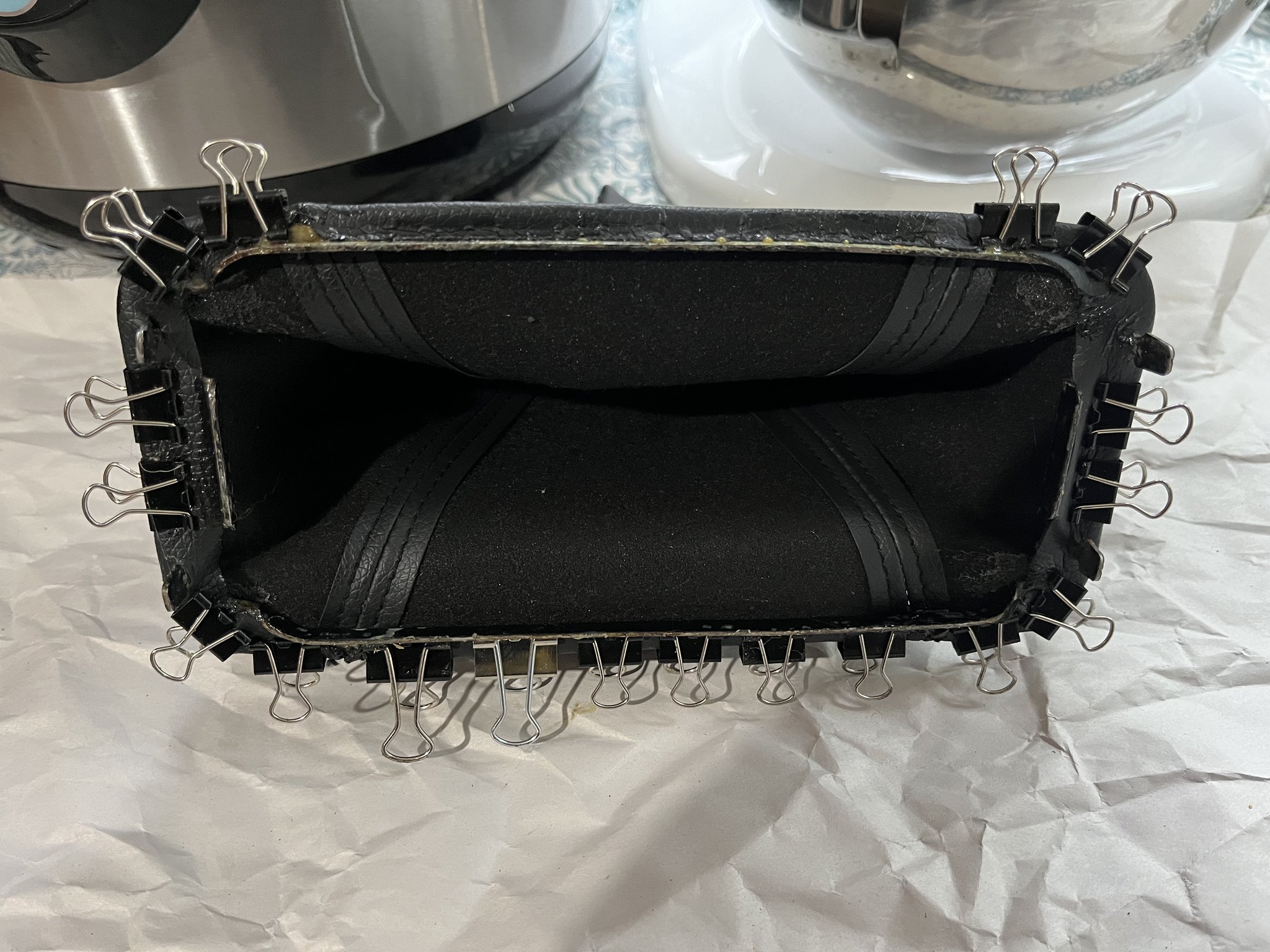

First clean all the old glue off the metal boot frame. Doesn't have to totally shiny clean, you just don't want piles of old glue and dirt on it.
Then dry fit the boot to the frame and see how it fits. Get it stretched around the frame the way you want it, and then carefully cut two small slots on each end of the boot so the little metal tabs on ether end of the frame can go through the boot and help hold it in place. I pulled the edge of the boot over the tabs and then cut the slots over where I could see the tabs pushing through the boot. That way you know you have them in the right place.
Now you can start thinking about applying some glue. I didn't have enough binder clamps to do the whole thing at ones, so I did it in stages. How ever you do it, I recommend doing one side at a time so you aren't racing the glue drying out.
I started on the long sides. Fold the edge of the boot back to expose the underside of the frame, and apply a modest amount of glue to the frame and the boot material. Give it a quick bit of hot air with the hair dryer to set the glue off. You want the glue tacky and sticky, not dry. Ones you have the glue right, fold the boot material over the frame and secure it in place with the binder clamps.
Repeat the with each of the four sides of the frame. Then let it dry, I'm going to let it sit over night.
Before installing, trim any excess boot material off with your knife.

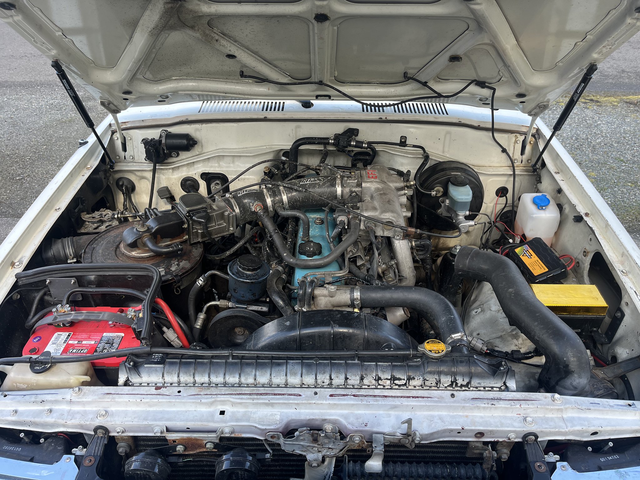

Let's see a photo under the hood. How many miles on the mighty 3FE?
LOL. Wife's 80 sounds a helluva lot more like YOUR 80. Paint looks OK, OEM wheels can't be improved upon IMO.

I'll post up a picture of the 3FE later. Its not beautiful but it runs well. Its got ball park 300k miles on it but I don't know the exact number off the top of my head.

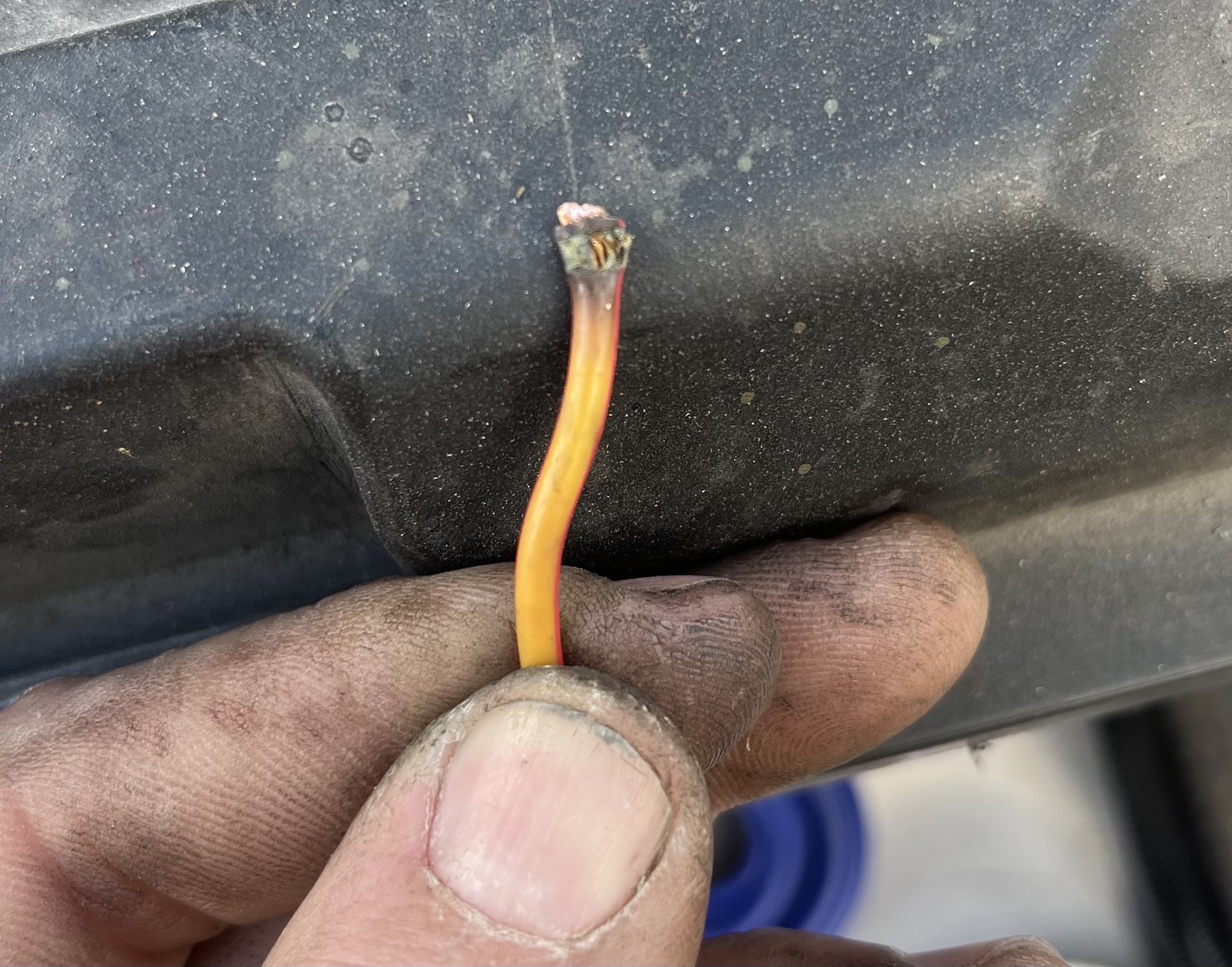

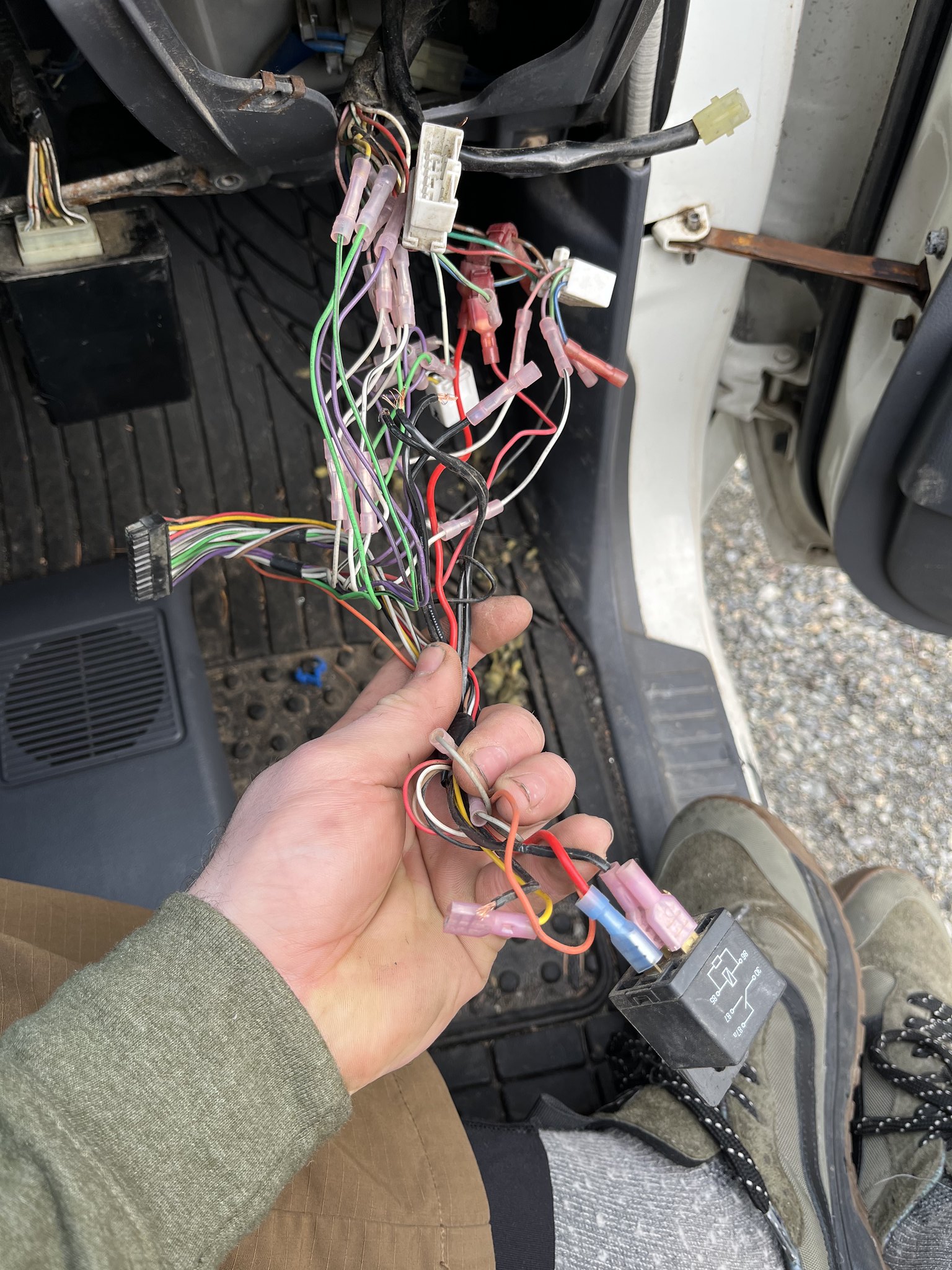

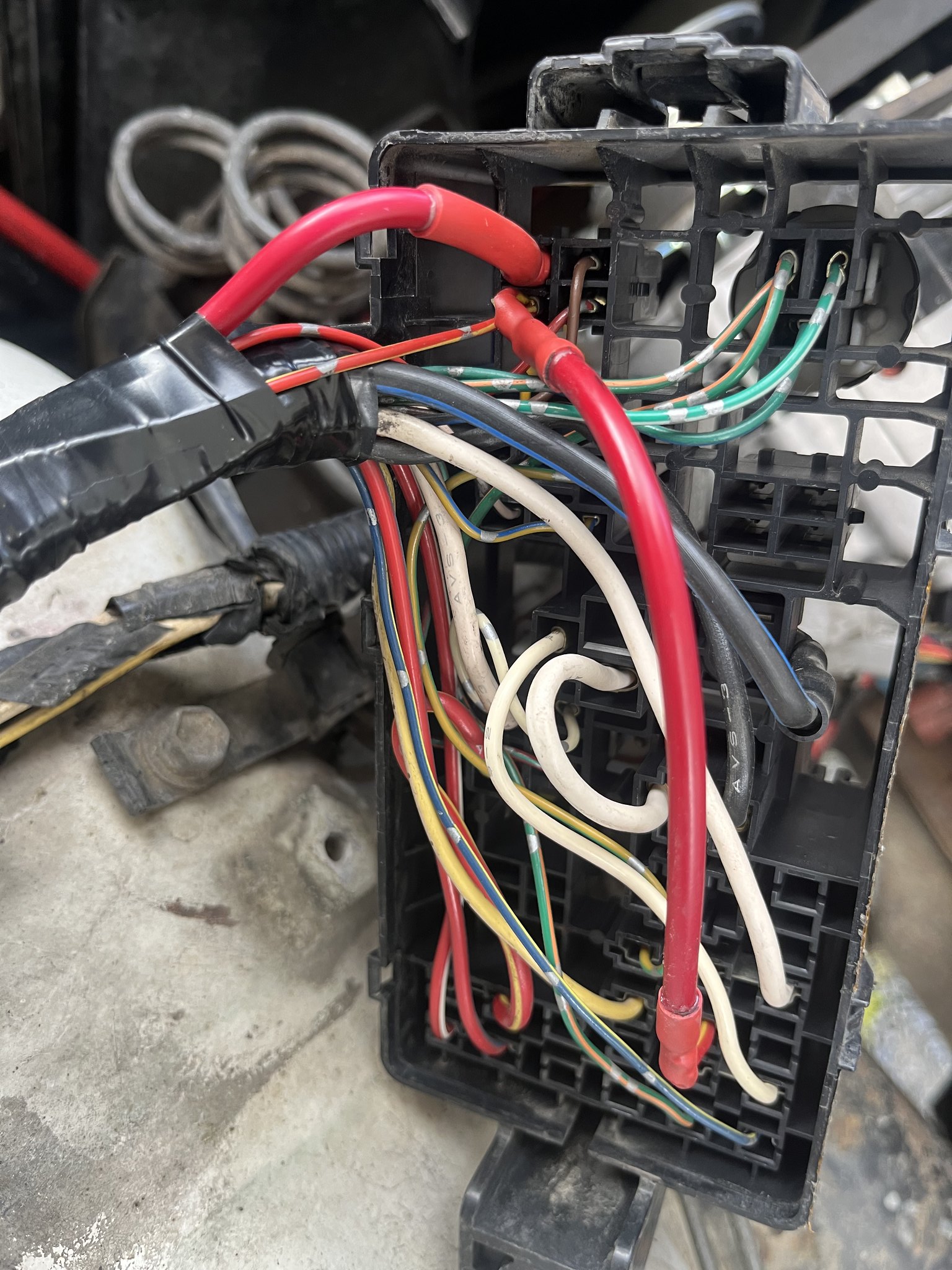

Today I removed this rats nest from the Landcruiser. The speakers stopped working for some resin last week, so I started trouble shooting. When I got down to checking the factory amp, which I never did before for some resin, I found this mess.
Luckily it was easy to snip out. I just soldered the factory wires back together, that the former owner had cut and spliced. Speakers work again. I have no idea at all what the heck was going on. The PO wired in some sort of after market plug and a relay. What for? Your guess is as good as mine.

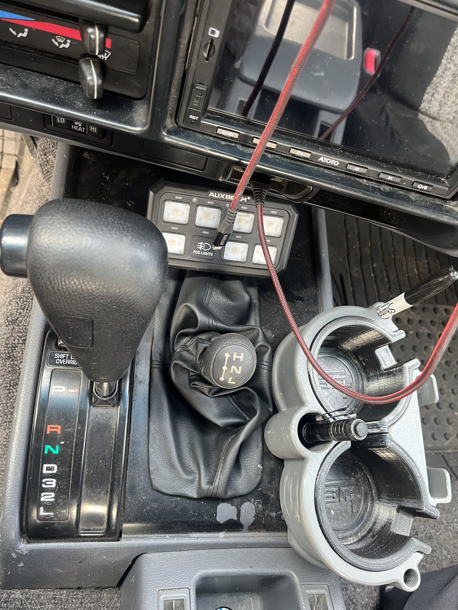

Wired in an AUX Beam 8 gang switch

I thought I'd fixed the EFI issue by moving the relay box away from the exhaust, but yesterday on the way to a hike with my dad the LC died twice. Refused to start at the gas station until it cooled down, and then a few miles later it died on me while driving. Pulled over, let it cool down again and plugged in a spare EFI relay. Drove it home and parked it.
So today I'm going to do some re wiring.
Anyone have a part number for the plastic body EFI relay from the Camry that plugs into the 3FE relay plug?
Got the EFI relay rewired with some 10g wire. The ends of the original wires were definitely corroded and and looked like they were getting kind of toasted brown by heat.
Replaced the wire from EB1 to the relay, and the wire from the relay to the fuse.
If this doesn't work, I'll make a little extension harness and run the relay into the drivers footwell, away from the heat like a few other people have done. I feel like the LC starts up just a tad faster now that the wiring is fixed.
Some one was asking for a picture of the engine bay, so here it is. Its dirty and there is some messy "temporary" wiring for the Auxbeam switch relay box. Originally I was trying to fit a second battery in the space that opened up by moving the relay box and deleting the OEM wiper fluid bottle, but I could get the hood to close no matter how I oriented things. That's why there is some real heavy duty wire running from the battery to that area. Right now that wire is only running the Auxbeam unit, which is way over kill. At some point I'm going to down size the wire and make a nice mounting bracket for the Auxbeam unit.
I wrapped the relay box in some of that fancy gold foil tape to try and keep some heat off of it.

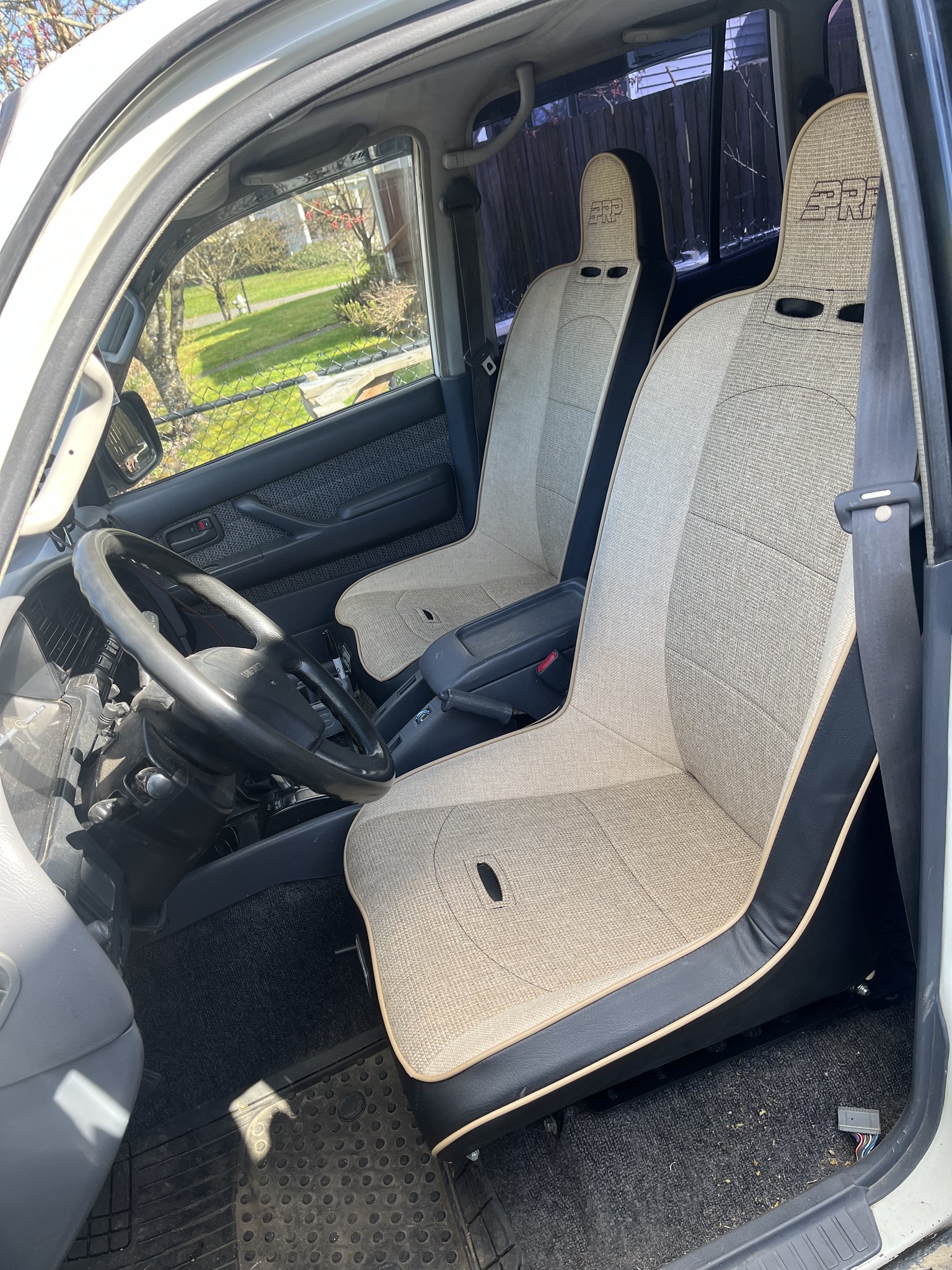

I also stuck the PRP seats I bought for my Jeep in the LC. My wife already informed me that they belong to her now, so I guess I'm buying new ones for the Jeep 😄
I ordered some Planted seat brackets for the seats because they are suppose to be great, but the aren't. WAY over priced for what I got. They are over $200 each, and they showed up with the powder coat rubbed off a bunch of the edges because of bad packaging, and the passenger side bracket was real hard to bolt in. Had to use a pry bar to pull it around and get the bolt holes to line up. Next time Ill just order some cheap ones.

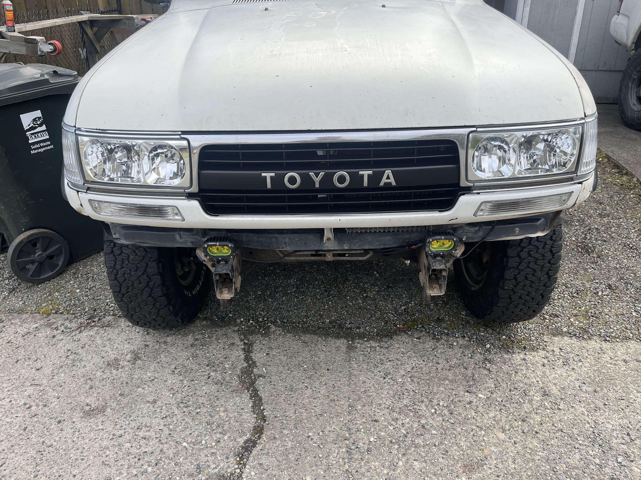

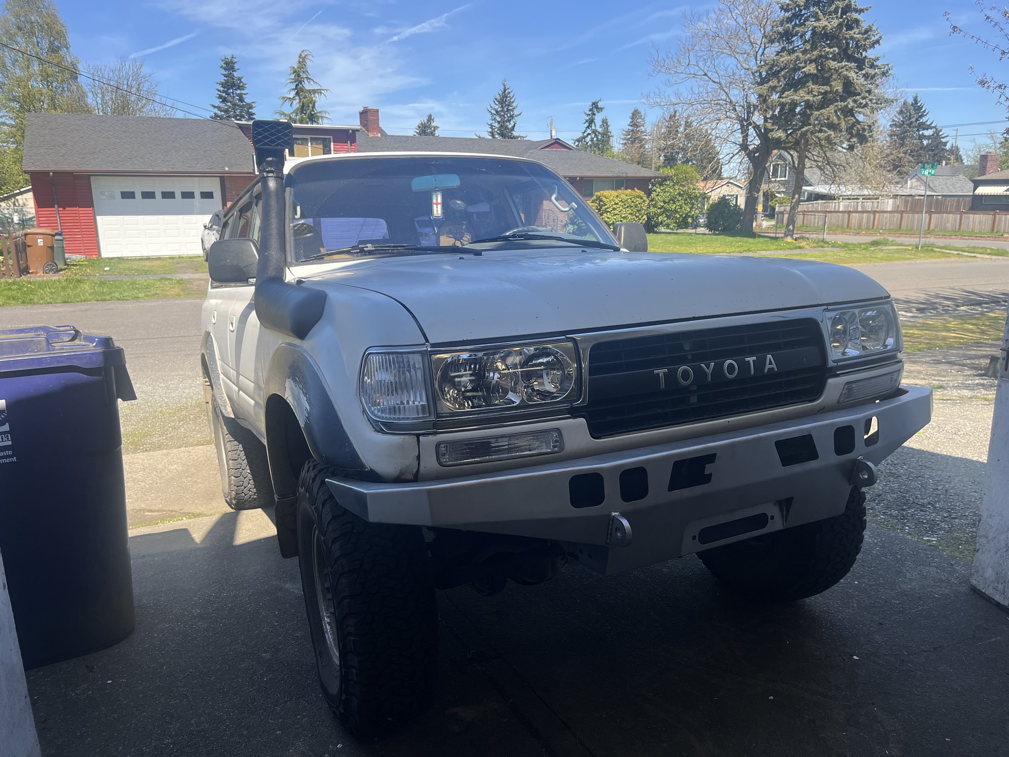

Did a few things recently. We got our Coastal Offroad DIY bumper kit in, and I welded it up and got it dry fit to the LC. Happy with it. Time to save up for a winch and some lights. Most likely going to buy a Superwinch SX12SR, which is their 12k winch with synthetic rope. I owned one of their winches before and liked it a lot. Also going to throw some Diode Dynamics lights in it at some point. Bumper should be back from powder coating on the 7th.
Stuck a snorkel on because it was on my wife's list of things she wants. She said "now it looks hard core." hahaha

I also finally got around to installing the beefy 1.5" 1/4" wall DOM tube tie rod. The stock tie rod was interfering with the sway bar badly, and with this tie rod being even fatter, I made some custom brackets to bring the sway bar up just a tad so they don't rub anymore. The Icon lift kit came with sway bar spacers, but they just make the issue worse. Maybe they are only for the FZJ? Because they lower the sway bar on the frame side of things which makes the issue worse. Toyota's sway bar to frame bracket also seams WAY over engineered. Why doesn't the sway bar just bolt directly to the frame, instead of having all the crap between the sway bar and the frame? All the other cars Iv ever worked on have the sway bar bolted directly to the frame.

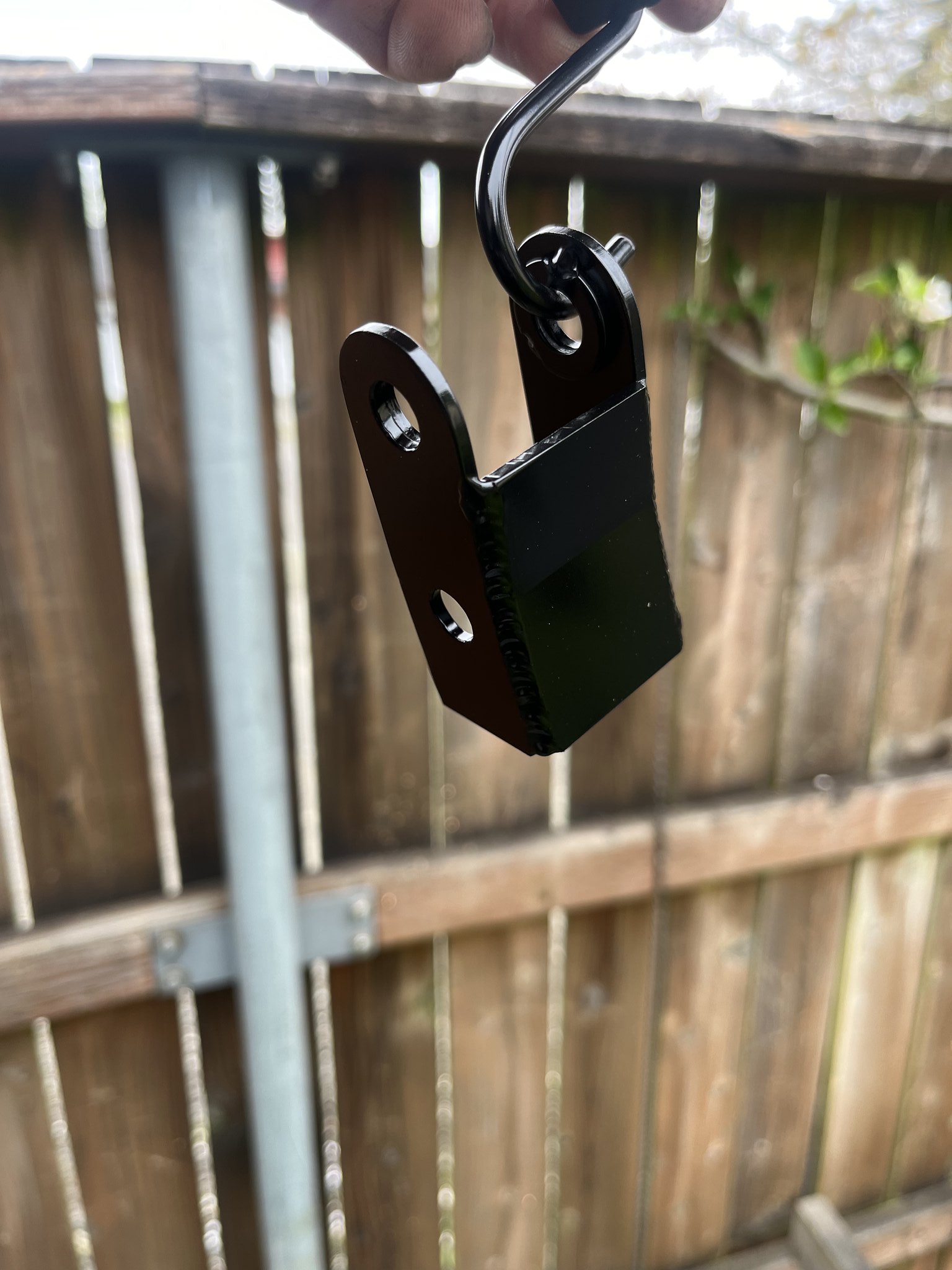

Got our bumper back from the powder coater last week. Super stoked with how it came out. Time to save up for a winch and some lights to throw in it.
Iv also been replacing a lot of small missing or damaged bits and bobs like the in dash fuse box cover, dome lights, and the exterior window moldings that were all dried out and cracked. Replacing those moldings made the windows go up and down WAY better. Good thing to know if you think you need window motors and have bad moldings.
