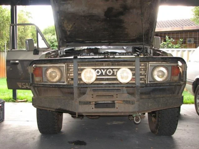

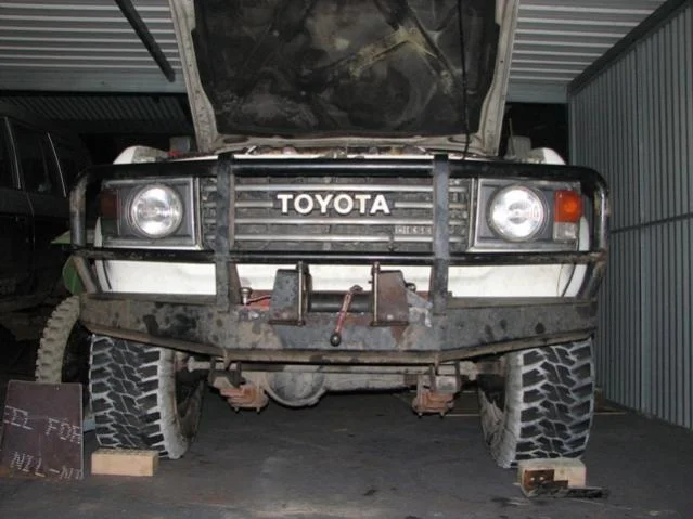

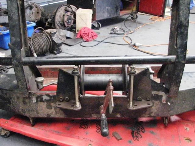

Hmmm.....I am at the moment fitting an OEM PTO to an ARB Bullbar and was thinking the same thing "Why isn't there more rope on the winch ?" So I did a search on IH8MUD and found this thread.
It's a good idea to take another cut and make a little room for when the rope winds 'bad'. Where's that 9" Grinder ??
Thanks again IH8MUD !
I trim the back cross support on my OEM PTO winches for more clearance for the spooled cable. I also weld a tab on the cross member right at the edge of the drum to ensure that the cable does not slip over the end and off the drum.

So, are you modifying a regular ARB 'bar intended for the 60 Series? Or is it one of the "commercial" 'bars ARB produced designed to fit a PTO winch?
Thanks.
Alan
Hmmm.....I am at the moment fitting an OEM PTO to an ARB Bullbar <snip>
...are you modifying a regular ARB 'bar intended for the 60 Series? Or is it one of the "commercial" 'bars ARB produced designed to fit a PTO winch?
Im not sure what the difference is. Here is a pic of the ARB on the parts truck when I bought it /what it looks like now on my 60.
