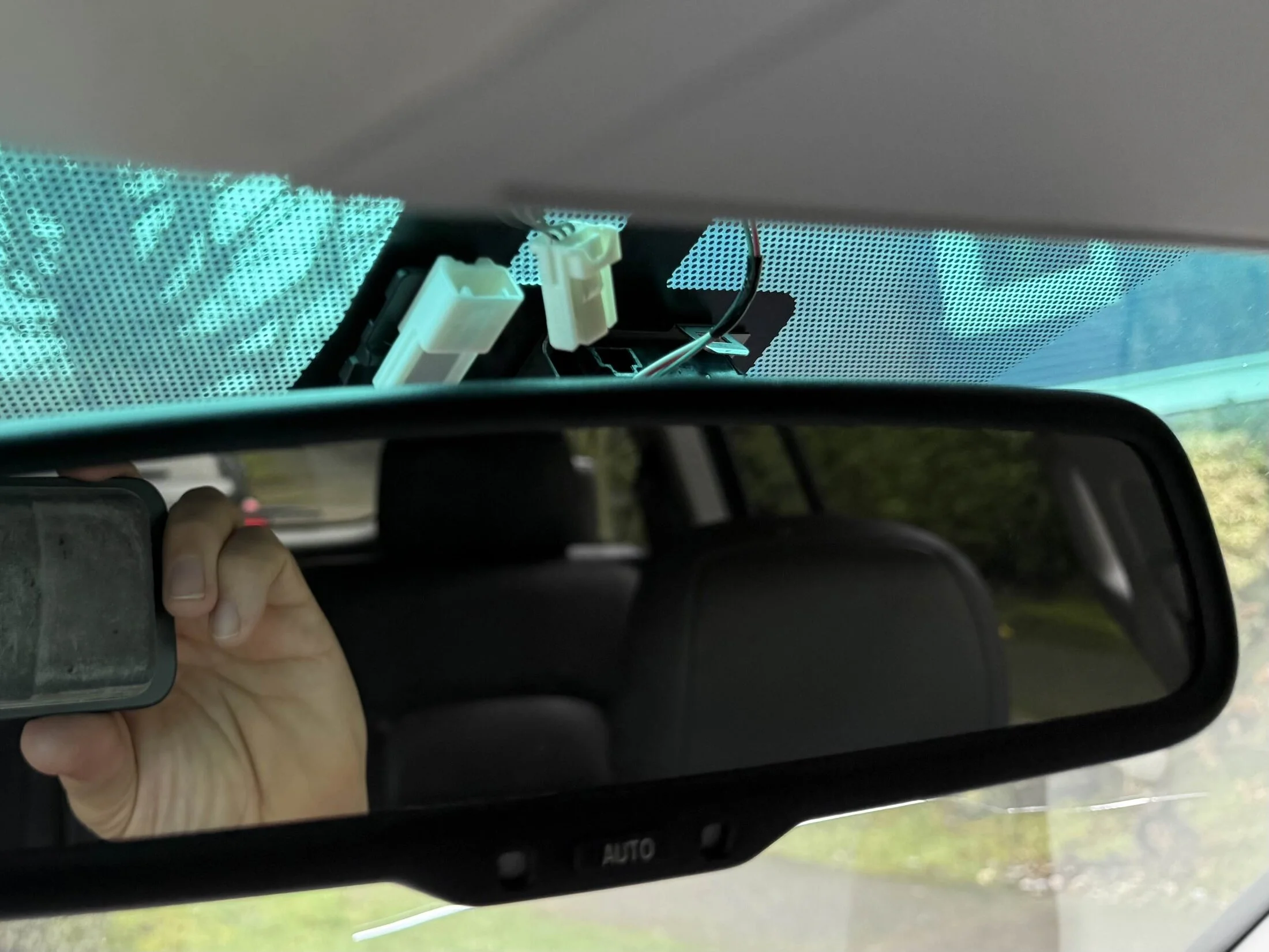

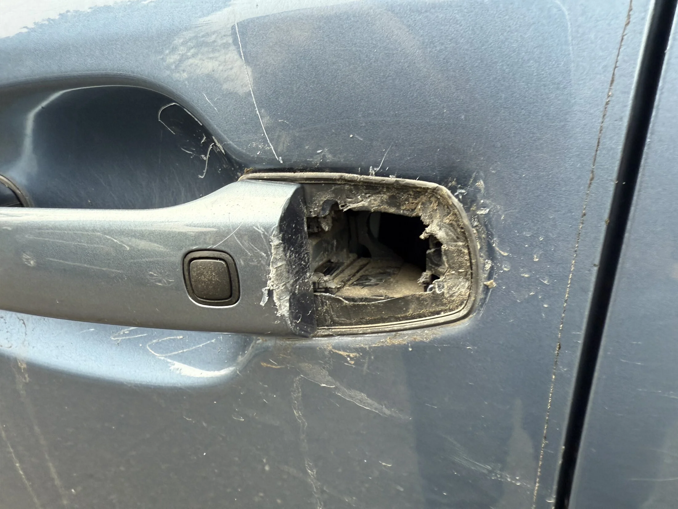

This morning I noticed a dry patch on the ground under where my 2011 Land Cruiser, Apocalypse One, was supposed to be, plus some pieces of the driver side door lock. I was a little upset but to skip to the end, less than an hour and a half later I've got it back. I recommend hiding a AirTag in your car!
The thieves had pulled out phone charger cords and topped off their phones, otherwise leaving almost everything else alone, except that they removed the plastic covers from behind the rear view mirror and disconnected the two connectors there (nondestructively, happily).
Anybody have any idea why they did that?

They probably thought we have some type of “on star “ system and it’s connected to mirror.
I’ve recovered stolen cars where they have ripped out entire headliners - trying to disconnect any tracking.
Glad to hear you got it back, and in not too bad of shape.
I imagine they were trying to ensure no dashcam was in place to capture video evidence.

as mentioned- they disconnected the harness to kill cameras or the onstar type tracking.
This isn't a dip**** meth fueled junky job like a smash and grab. it was parked in a cool down area to see if it had a tracking system installed before being moved to a chop shop in 24-48 hours. the charging cords were probably for the programming tablet to stayed powered up while driving or a wave bubble type RF jammer (yeah it is a thing).

ironically they can use the xtool type system to clone the fob without gang raping the lock core and body work using the Toyota touch-to-unlock RF system
Sorry, man. Something similar happened to my LX in Montreal a few years ago. They weren't so rough with my door, but I still had to get it painted/replace the locks, etc....

Another bit of data, consistent with the above conclusions I think. The rear view mirror was askew when I reclaimed it so probably they unplugged those wires at the time they ditched it.
