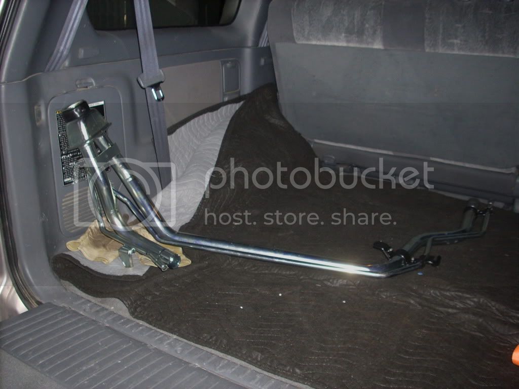

The dual filler neck allows you to fill both tanks from the same neck, not at the same time. It is an inverted Y, you point the gas nozzle at the opening for the tank you want to fill.
The transfer pump is plumbed into the main tank filler vent if you overfill the main tank it simply backs up into the Y and returns to the sub tank.
This is the factory dual filler neck, the frontrunner neck is different from what I've heard.
