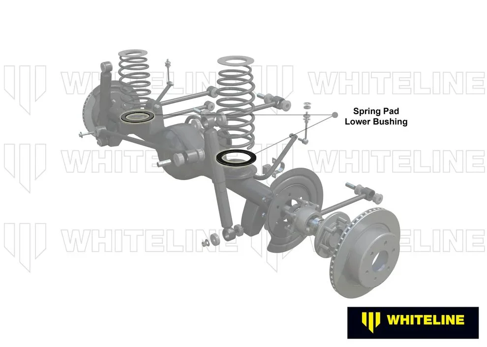

I just purchased this Whiteline W73385 30mm Rear Coil Spring Spacer at $60 shipped, and hope to get the rear AHC pressure back to spec. However, it doesn't come with any instruction. Checked with Whiteline support and was told "they would simply install onto the lower perch as any other pad". Their product website does has the following diagram, showing the spacer goes to the bottom.

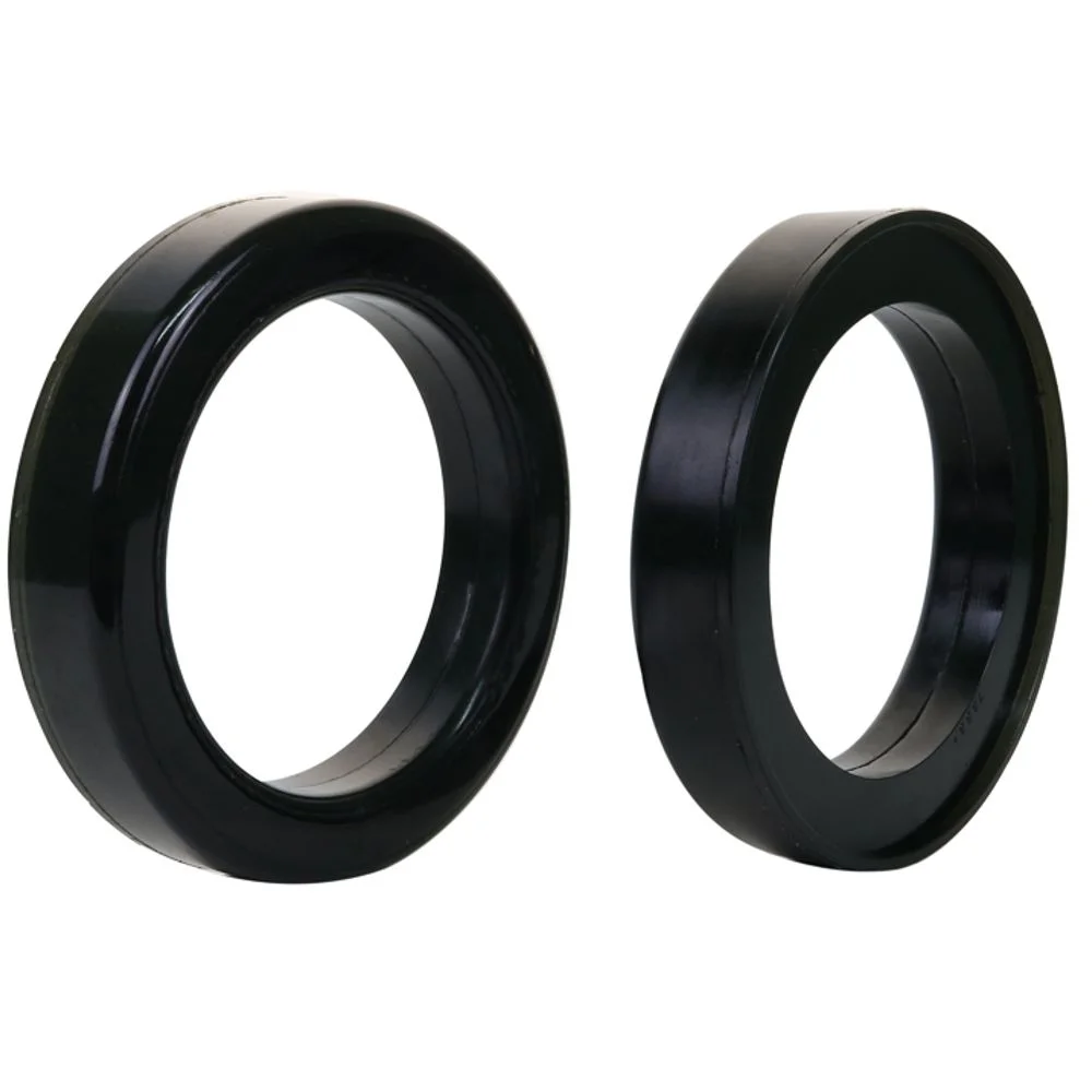

However, when compared with the picture of Slee's spacer, it seems both spacers are identical. According to this installation guide, Slee's spacer goes to the top. So should it be put to the top or bottom?
As a comparision, this is the product image of Slee:
And here is the product image of Whiteline:
When I used spring spacers, I had them installed on top. It probably doesn't matter either way because the end result is the same, but I'd be willing to bet Slee knows Land Cruisers better than Whiteline.
Get the rear end up high on jack stands. Support the axle on a jack. Remove lower shock bolts, disconnect sway bar links, disconnect height sensor linkage and lower the axle down until the springs can come out. The spacers go on top.
Follow @GTV instructions. Once you get into it you'll quickly learn that the spacers will not correctly fit on the lower perch.
I'll also add that lowering one side of the axle at a time will be a little easier due to the articulation angle.

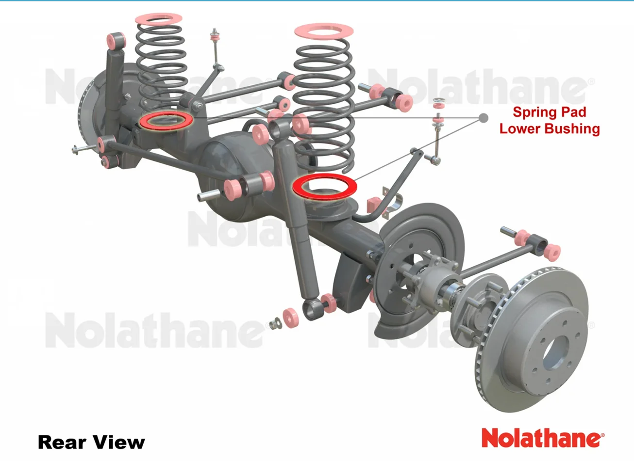

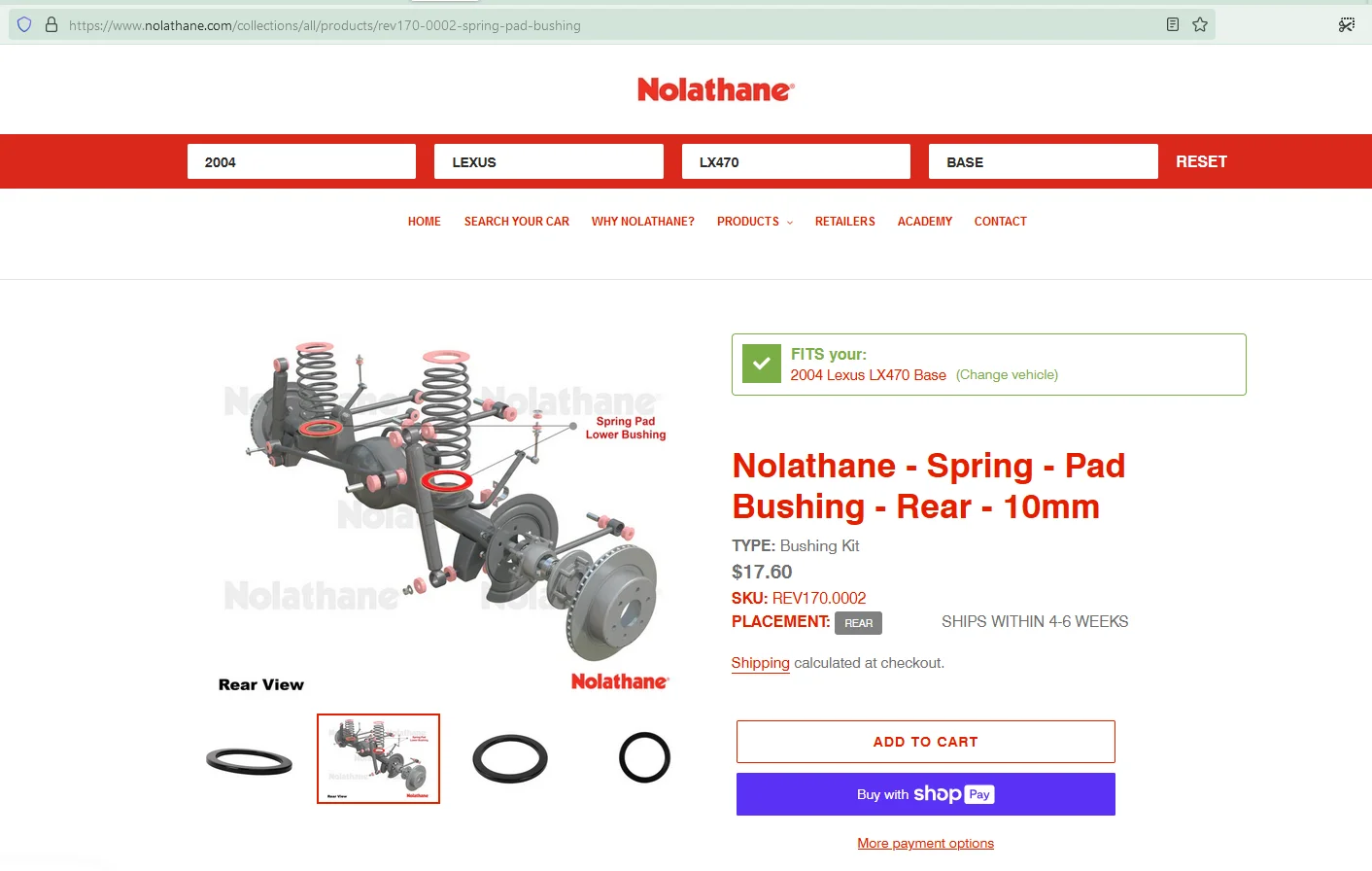

So I took a look at Nolathane's website, and the pictures on the product page also shows the spacer was put under the bottom of spring. Just curious where did you put it?
That is for a 10mm spacer, which you may be able to get away with on the bottom. But for a 30mm spacer, I would not suggest it. Mine are on top and secured to the coil with zip ties on each.
No spacer goes on the bottom. You'll understand when you take it apart.
