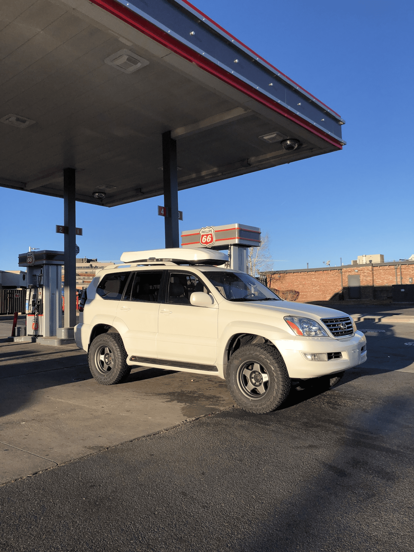

On Black Friday, previously to owning the GX, I had bought the Dobinson's 2" lift from Brennan @ Apache with the SSO coil conversion. Along with it, I ordered Falken Wildpeak AT3W's 285/70/17 with SCS F5's -10. I installed the front lift along with wheels and tires by the end of the following week that I had purchased it.
At this point, I did not install the rear springs as the garage at work is only 6'3" ish. With the airbag trick in the rear, I was less than an inch from the crossbars scraping the pillars in the garage! So I left it as-is.
Being from CO, I ski/snowboard quite a bit so I had my Inno racks box on and off quite a bit. Two weeks after purchase, here's how she sat:

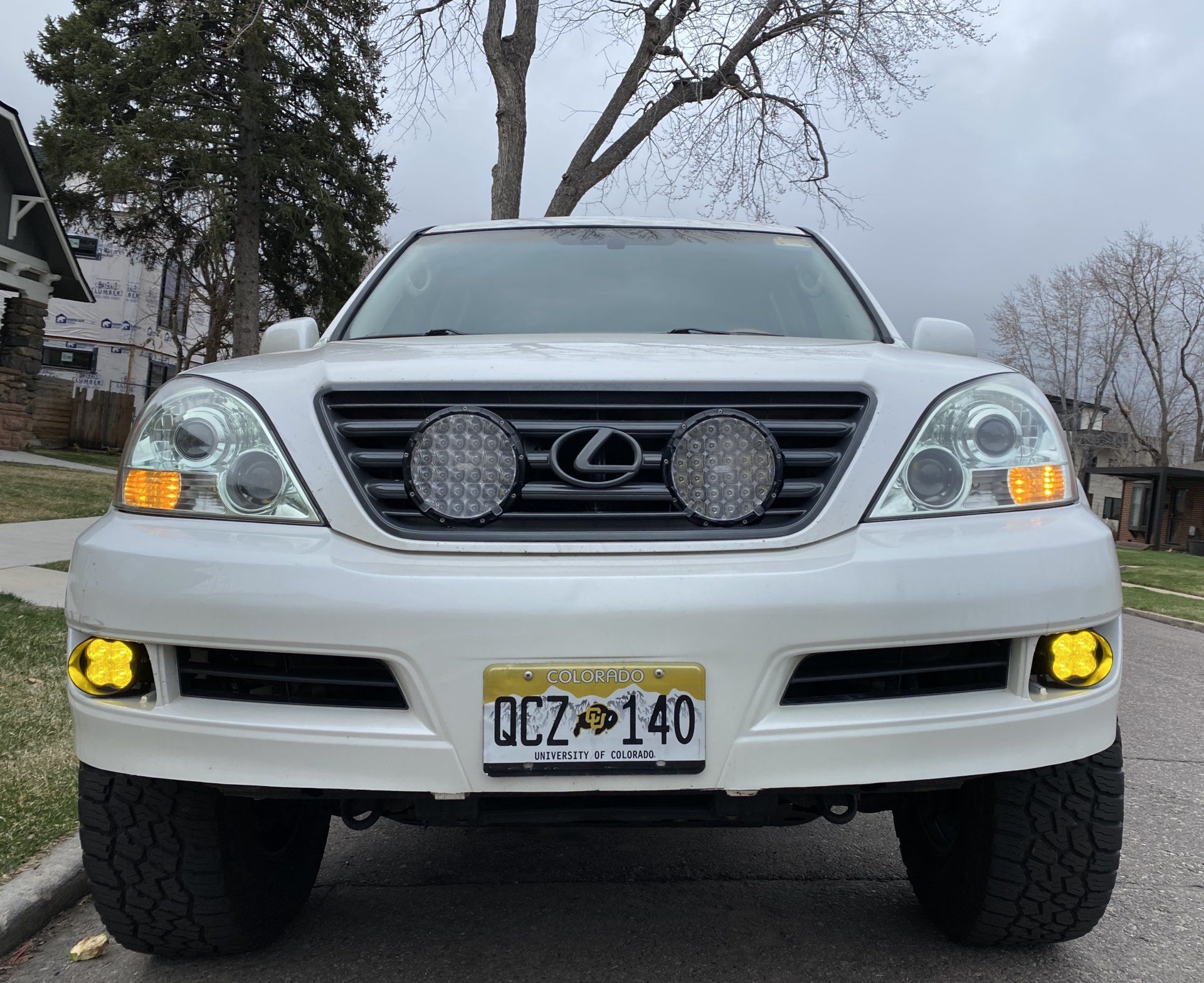

Removed the stock fogs and replaced with Diode Dynamics SS3’s with the fog light switch mod. This things are crazy bright!

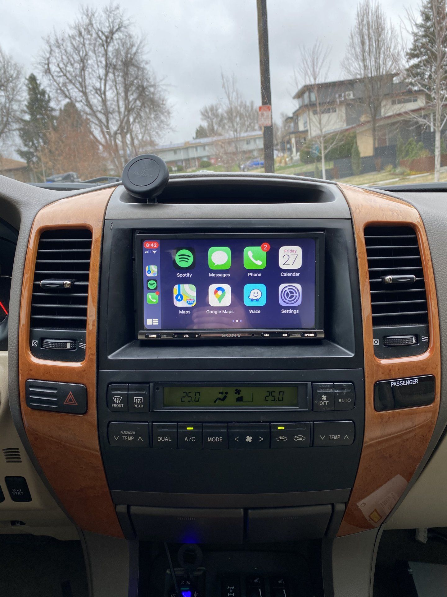

Recently during this whole work from home quarantine here in Denver, I had found some time to do the Non-nav conversion with a 2006 unit from Australia. Everything works flawlessly and don’t mind about the temp being in Celsius or the temp up/down being flipped. Chew marks courtesy of the new pup.

How'd you source the non-nav? I'm coming from a 100 series and they were so hard to come by for a conversion.
