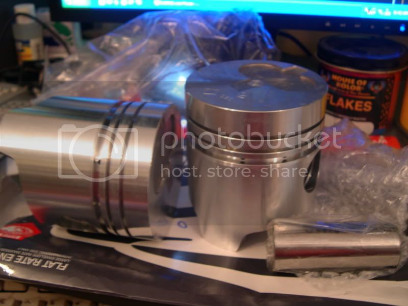

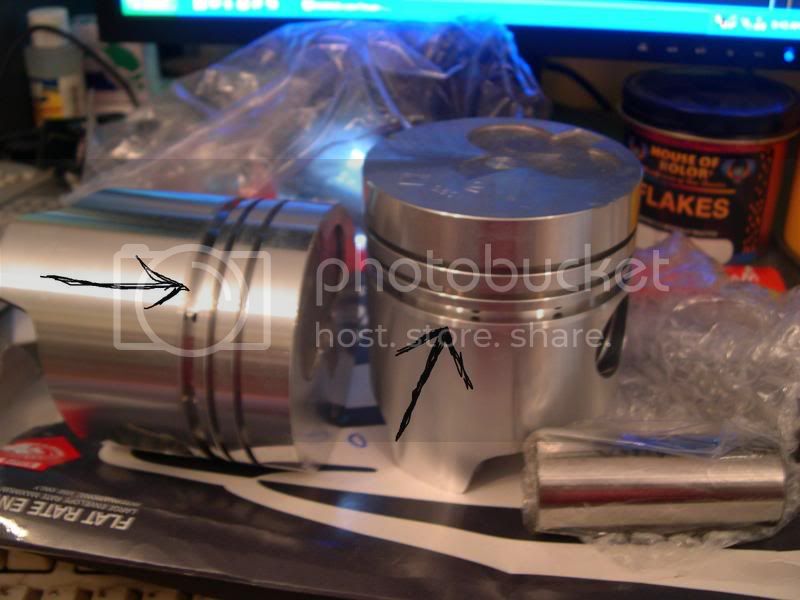

LOL. The engineers at Toyota seemed to think with 10 liters of oil and running 85lb pressure there was no need for them on this low stressed unit. Also where you guys only ever got a handful of these 2H motors it seems to be a problem where here where we got many thousands it does not seem to be a problem, very strange. If the nozzles are necessary , why don't you fit them to the 2H motors you rebuild? Probably for the same reason here " that the 2H does not really need them". There are actually better pistons [pictured] available than the standard pistons supplied by Toyota, but I have not seen anyone from Canada recommend fitting these to anyone rebuilding,,why? Also it seems a coincidence that it is easier to state faults with a motor that you hardly ever sell, LOL. It is no coincidence that when the 2H was sold here it had to stack up against a six cylinder diesel and four cylinder turbo diesel that was used by Nissan in their Patrol wagons,utes etc which it did very well. The 3B was not sold here in full sized cruisers because it was underpowered compared to the 2H and Nissan Diesel motors, it was not considered as an option either. In a smaller cruiser I think it would be outstanding with better weight distribution. While overtaking on the highway at 100ks a standard 2H needs a good clear run up. My 2H with turbo running 33x12.5x15 will run straight to 140ks, some difference for sure. Today there a still thousands of utes, troopys and wagons right back to the 45 series up to the 75 and 60 series running around here with 2H motors, not just a few here and there like in some countries.Strange but the 2H is the only thing that has not been rebuilt on my truck. I bought the pistons o/s .5mm just over 2 years age and have not used them yet. cheers :D Best stay with facts when drawing conclusions. ;)
Lets hear more about these aftermarket pistons and why they are better. Who makes them? I'm interested.
