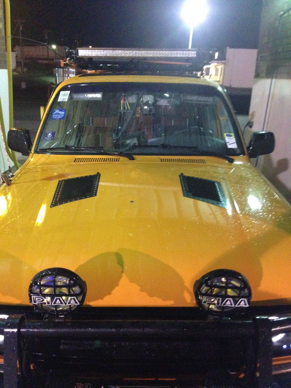

Did my rearward came out better then I thought! The only thing I would have done different is bought the large ones!
