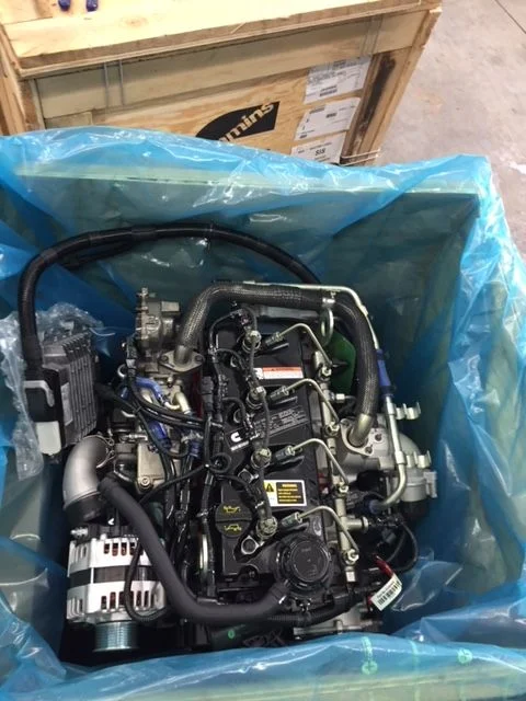

So I have a couple of unique 70 Series projects in the pipeline and I am stuck between two engines: Toyota 1HZ like new and new Cummins 2.8 crate engine, both on hand.

2.8 Cummins
-4 cylinder turbo diesel
-very electronic
-2.8l - 120kW @ 3600 rpms, 360Nm from 1800 to 3000rpms
-500 LBs
Numbers and weight are in favor of the Cummins.

The 2.8 Cummins is nothing like the 4BT of the past. It is a very quiet engine for being a diesel and very responsive to the electronic throttle. A/C can be added to a 2.8 Cummins quite easily. Just like all things diesel this engine has been in use around the world for many years so it has a track record already that seems reliable; we are not just getting a taste of what the rest of the world already knows.
